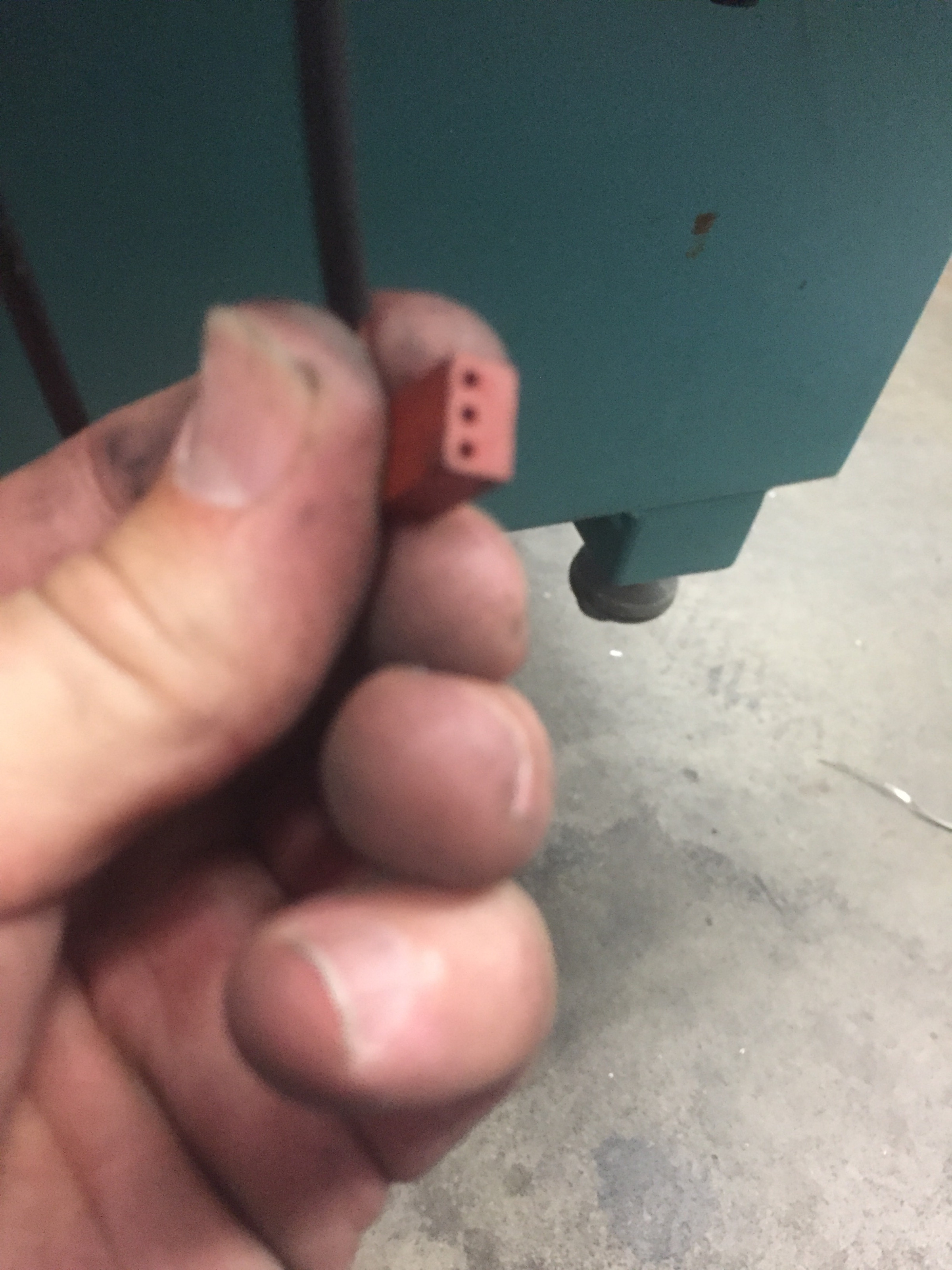

Ok sounds good, appreciate the help. Would me not having this "shorting plug" cause this issue? I dont have a 4th axis. Also noticed j3 and j4 connectors are not plugged in on the ATC board. I will check the schematic see which one goes where. I noticed it before but figured it's not part of the breakoutboard, shouldnt cause an issue.
