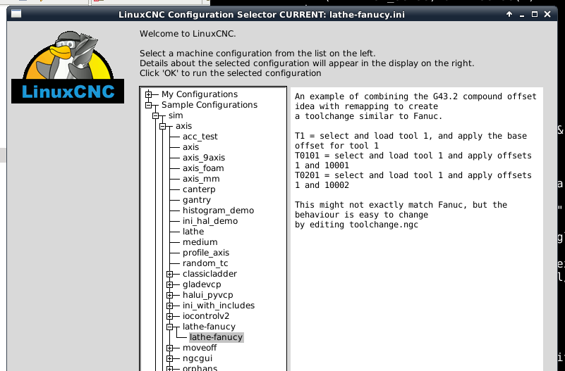

Ok ran a thread ( Sorry no video yet ). but I do have a question about the tool table.
I can reset my x and z zero for every tool and make a part, and thats ok for 1 piece.
I tried entering t0101 in my g code and i got
"request toool 0101 is not in tool table"
how do i get it to see the tool table correctly

Unless you have configured otherwise a default installation (even on a lathe) uses the "M6 T01 G43" command to change tools and apply the offset. (with an optional H01 and maybe a G43.1 for luck).
T0101 looks in the tool table for tool 101. You probably don't have one.
It is possible to remap the T-word to perform lathe-like tool changes with wear offsets, take a look a the sim/axis/lathe-fanucy demo config
Replied by andypugh on topic Starting another conversion Harrison L5a

Ok I have linux debian and can't find the folders anywhere.
( sim/axis/lathe-fanucy demo config)
I can't even find the sim or axis folders.
any help on where to find them would be great.
02 Jan 2016 01:26 - 02 Jan 2016 01:27 #67676
You need to expand the "Sample Configs" tree

02 Jan 2016 11:52 #67700
by BigJohnT
From the main menu CNC > LinuxCNC and follow Andy's instructions.

02 Jan 2016 19:05 #67722
by mblaszkiewicz
Replied by mblaszkiewicz on topic Starting another conversion Harrison L5a
Ok found the files. Not exactly sure how they are used but found them.
03 Jan 2016 00:04 #67734
Well, I was actually suggesting that you should try running the sim config and see if it does what you want.
