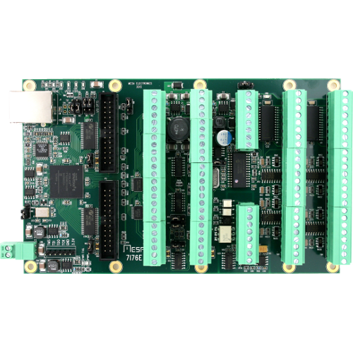

Im liking the Mesa 7i76e ethernet i/o board. If I were to go that route I could keep the dell fx170 thinclient, would I need any other boards with this as it is also cheaper than the pci io and 2 daughter cards from mesa.
Replied by LutzTD on topic Emcoturn 120 lathe retrofit
For little more than your C32 board you could get a mesa 7i76E, and eliminate items 2,3 and 4 from your shopping list. (it is the breakout, spindle encoder counter, vfd control, and hardware step-generator, all in one.
But if you already have your heart set on, or already have that other stuff a configuration could probably be put together that could directly replace a smoothstepper using a 7i92.
One benifit of using Linuxcnc over Mach might be that Linuxcnc can generate other step output paterns than just step/dir. CW/CCW and quadrature as well as a few more obscure options are available. (I think those vexta drives may use CW/CCW.)

You might need a USB Network dongle of some sort, the 7i76 will occupy the only ethernet port. However, you should have more than enough stepgens and GPIO for the lathe on the 7i76, and I would expect that the spindle interface can operate the spindle.
Replied by andypugh on topic Emcoturn 120 lathe retrofit
