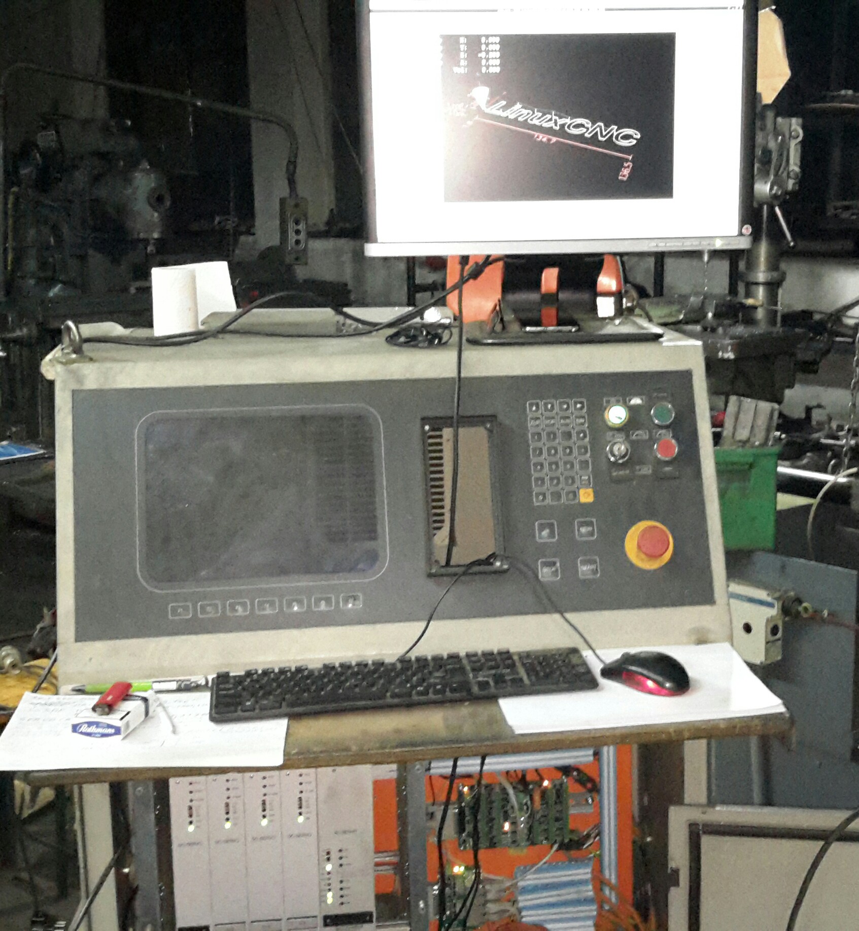

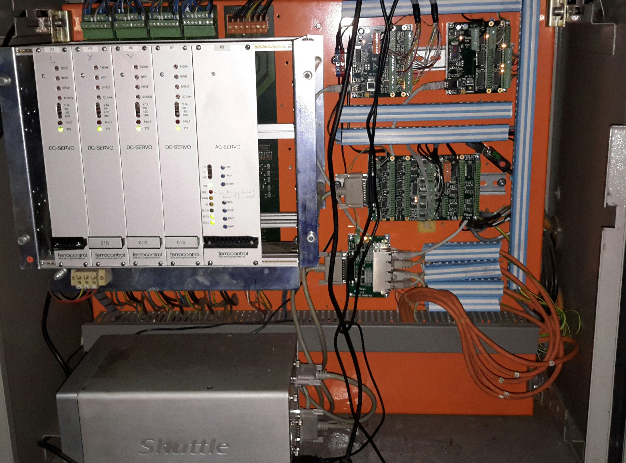

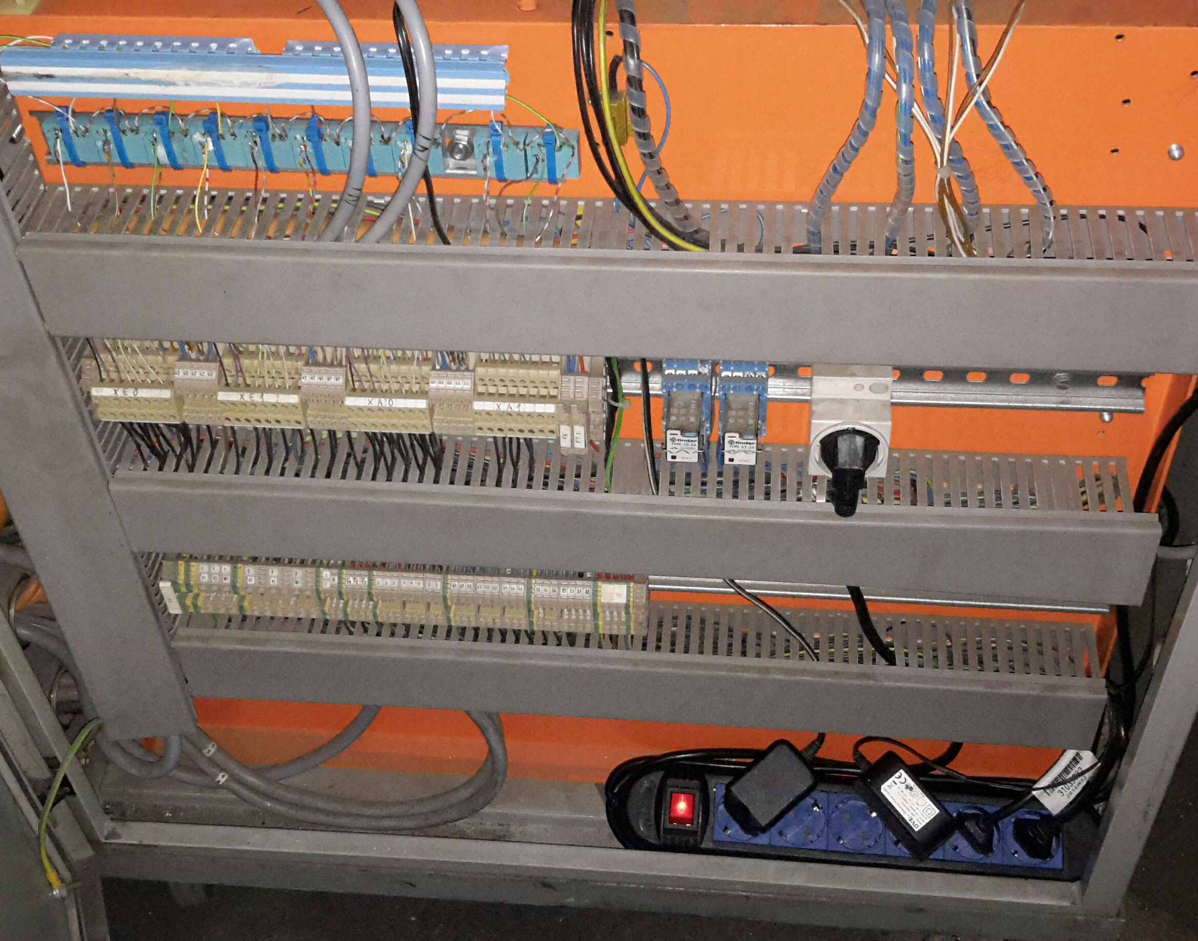

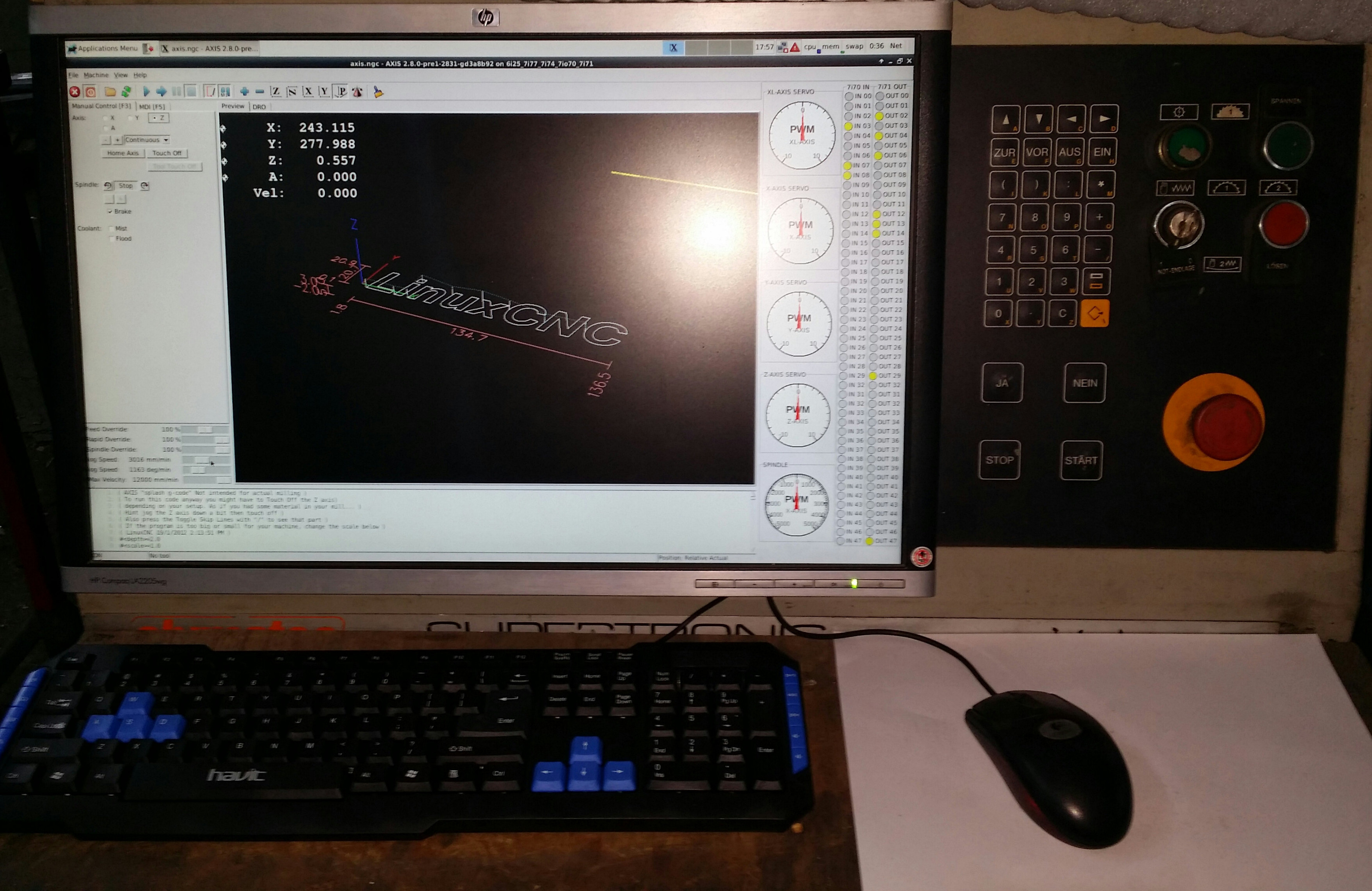

07 Feb 2017 00:44 #87436
Replied by tommylight on topic Elumatec SBZ 130/01 retrofit
Finaly got some time to mount the monitor and close the cabinet, checked everything and all is in good working order. Camera on the tablet kept freezing but got some short videos of a test run and tool changes.
All in all, it was a nice job, took over 2 weeks to finish, and we are pleased with the result. Air pipes are not changed yet, so stay tuned for more videos.
