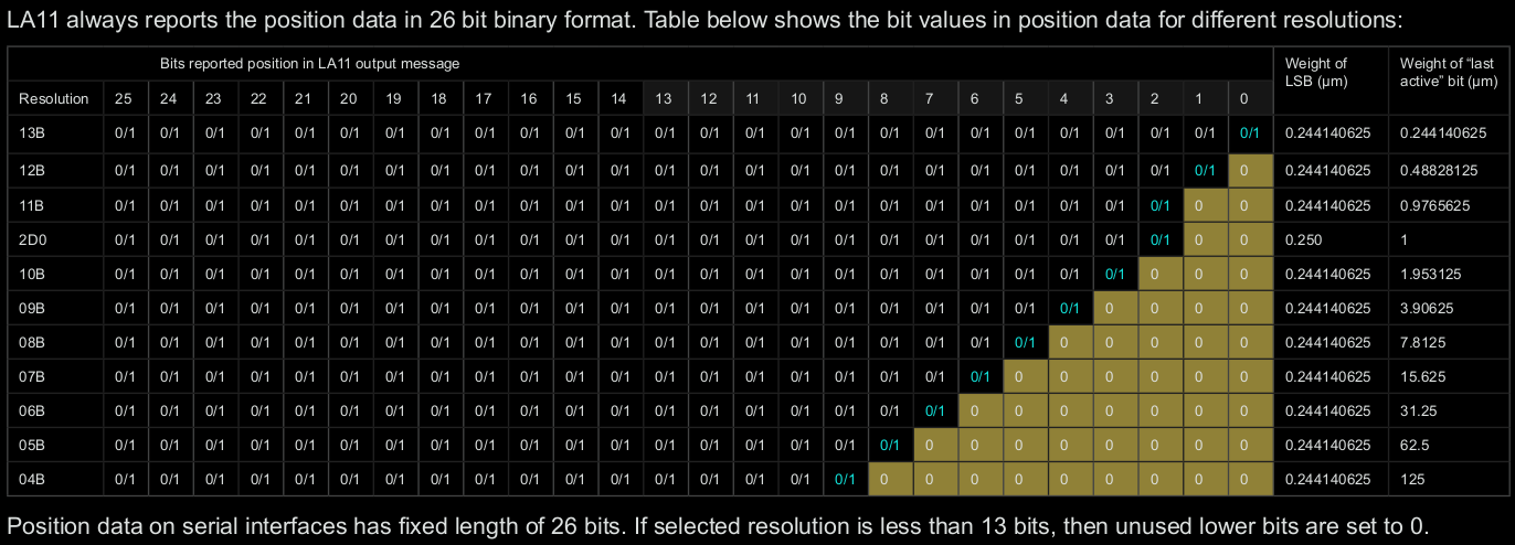

My encoder is 2D0. I tried biss_chan_0=xencoder%24ge after seeing first couple of bits are zero from the table I've attached but the readout in axis changes very minute decimal places while traversing the whole length of the scale with 24ge string.

Replied by PCW on topic Elumatec SBZ 130/01 retrofit
2^26 * 1u = 67 meters
if there are 0 bits in the data, they must be accounted for in the format string.
That is, if you still have 26 bits total, the format string must have 26 bits, not 24
some of them being dummy (using the "pad" format string entry) bits and not
part of the position part of the data
Do you have a link to the encoder manual?
Are you sure its Gray coded?
05 Jun 2024 16:59 #302396 by pmchetan

"biss_chan_0=null%1bcrc%6fwarning%1berror%1bencoder%26e" I saw this in a forum post where a person posted he was using similar renishaw glass scale. Where is the information about the format string? man page for hm2 doesn't go into this much details. Also the string I mentioned above doesn't work for me, but the person in the forum said it his scale is working.
05 Jun 2024 17:19 #302400 by PCW
Yes, your scale uses 34 bits rather than just 26 bits so that string looks closer.
you need 24 bits of (non Gray code) position, 2 pad bits, 1 error and 1 warning bit
and 6 CRC bits
