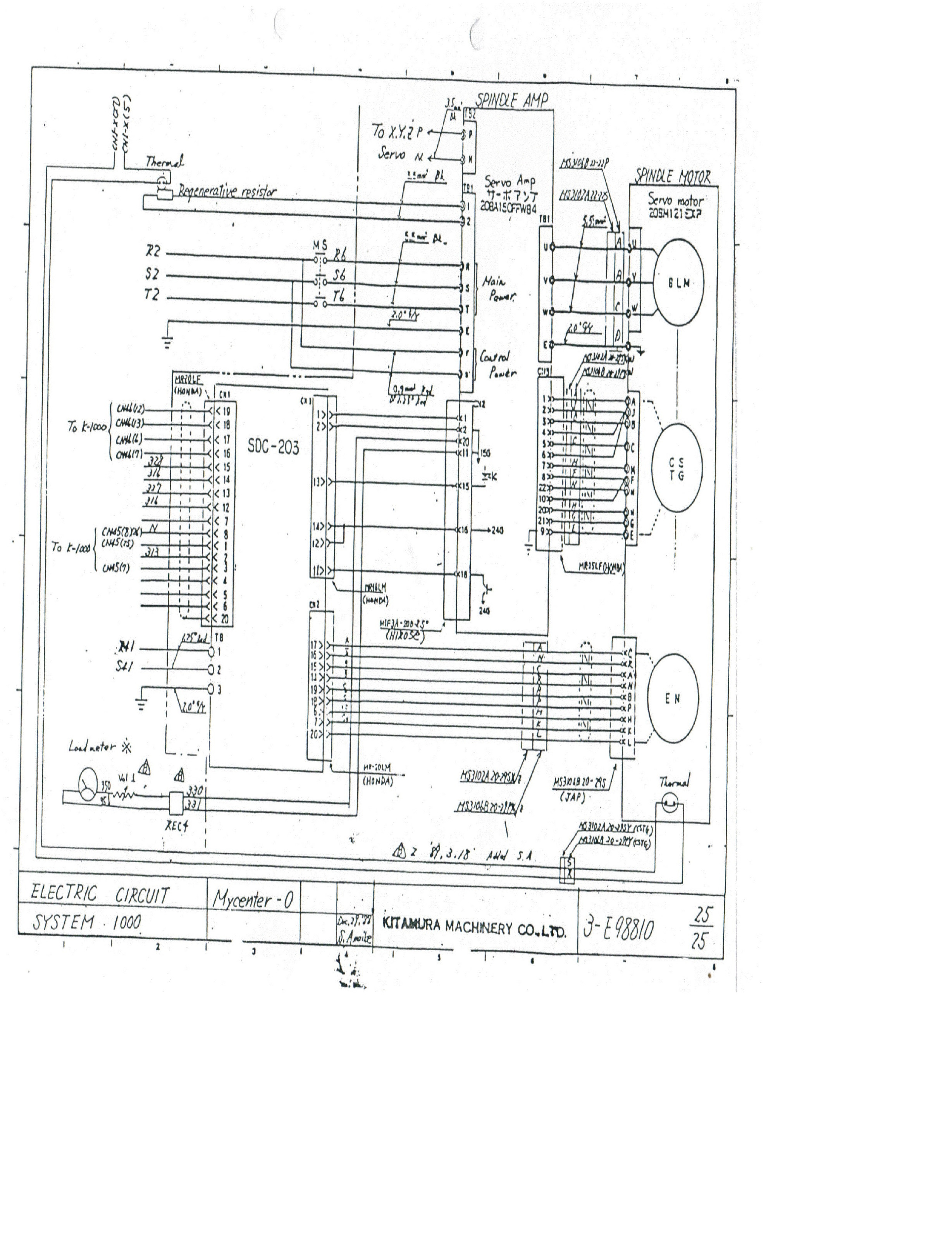

I intend to keep the servo-motors and drives. I'm going to interface this with a mesa 7i97 (iirc, I don't yet grok the mnemonic behind mesa card numbers...)
I found the pinout of the 20pin servo connectors somewhere, it seems it is something like 1..Vout 2..GND 3..A+ 4..A- 5..B- 6..B+ 7..Z- 8..Z+. Didn't figure out the rest yet.

thank you andy ..this is an old model !After imput , the phase goes directly in rectifier bridge without any control.
I did not have the courage to power this driver before documenting myself first.
I love this brother ...i worked hard for good mechanics but I'd like to keep the spindle motor, however I do not know what chance I have of doing that in a single phase. Wouldn't it be better for me to look for a VFD? In this case, which model should I pick?
In reply to @rmu : I think you have taken the pinout from the Kitamura Mycenter mill, but there are some differences. In the brother motor there's a single cable being output and it contains both resolver and encoder signals that enter the CN3 spindle driver. In this case, the second connector (CN2), which indeed has 20 pins , would be the one shown on the spindle amplifier page of the Kitamura mill manual.

I got the pinout from some blurry picture from some other forum, but can't find it at the moment. It is the pinout of the connection between control and servo amplifier for X-Y-Z axis. Didn't have a look at spindle control yet.
Replied by rmu on topic Brother TC-225 / TC-229 adventure!

have Brother TC-321 with similar Spindle drive 20BA150FFWB2. All axes and spindle connected to motherboard with 20 pin connectors. Axes and spindle shares the same connector pinout:
20 pin > 7i77 connector
1 > (TB5)24 AOUT
2 > (TB5)23 GND
3 > (TB4)17 QA5
4 > (TB4)18 /QA5
5 >(TB4)20 QB5
6 >(TB4)21 /QB5
7 >(TB4)20 IDX5
8 >(TB4)21 /IDX5
15 >(TB5)22 ENA5+
16 >(TB5)21 ENA5-
17 - + 24V
18 - Alarm out
1 > (TB5)24 AOUT
2 > (TB5)23 GND
3 > (TB4)17 QA5
4 > (TB4)18 /QA5
5 >(TB4)20 QB5
6 >(TB4)21 /QB5
7 >(TB4)20 IDX5
8 >(TB4)21 /IDX5
15 >(TB5)22 ENA5+
16 >(TB5)21 ENA5-
17 - + 24V
18 - Alarm out

Hi, Spindle drive powered from 2 sources.
Control
R210
T210
Power Stage
RM1
SM1
TM1
P.S.
As usual Brother manuals with mistakes. So in one place voltage labeled as SM1 in other CN1.
Control
R210
T210
Power Stage
RM1
SM1
TM1
P.S.
