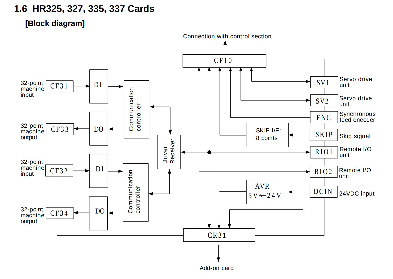

attached is the base i/o board diagram. sure, everything servo/spindle drive related coming thru SV1 (MC link A) bus. the spindle position feedback can come from either of 3 different sources:
1. spindle motor build-in encoder/PLG, via SV1
2. external spindle encoder connected to the spindle drive, via SV1
3. external encoder connector directly to the NC, via ENC
SKIP are fast(ish) optoisolated inputs used for touch probes and the like.
the second CF61 connector has 3 x 5VTTL MPG inputs (HANDLE), second encoder (ENC#2), EMG and a couple of RS-232s.
discrete IO is connected to the MM64 NC with a couple of serial buses RIO1, RIO2 (MC link b). 2 stations (32in/32out each) are present on the base I/O board, accessible via RIO1 and terminated at CF31..34 IDC40 connectors. additional I/O, if any, can be added to RIO1,RIO2 buses as stand-alone DXnnn units with similar IDC40 connectors.
so, with some rewiring and a bit of external circuitry almost all functionality can be duplicated with my YMDS2P card. in addition to the SV1 bus equivalent, 12ins/8outs the firmware has 2 quadrature decoders with index (ABZ), 4 MPG inputs (AB). the only missing thing currently is that RIO bus... though RIO uses a common RS-485, the protocol is kinda odd HDLC-based. no problem implementing it in a FPGA, but not with cheap MCUs. so i can't use my YIOs as slaves on the RIO bus unless i add some kind h/w doing the protocol translation...

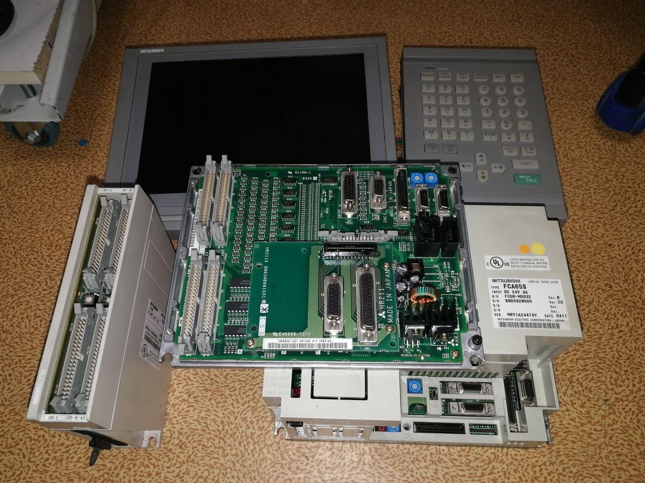

just scored a full working meldas 65s nc set. so implementing the CF10 connection to the base I/O board looks pretty doable now. also have the FCUA-DX121 RIO unit with an analog output - can support that too.

However, anticipating dm17ry's decision to go all out on this projet and adapting the IO Units into his firmware, I already bought all the necessary male and female mdr plugs to splice custom bridge cables between the new control PC and the original cf10 and cf61 plugs that are currently connected to the M64 control card.
Since the drives don't have an EEPROM where they store values anyway and need to be reinitialized on each startup, this should allow me to seamlessly switch between the new setup and the original control station until I got everything working reliably on the new system.
I will do a bit of research myself, but currently the two questions that I have are these:
1.Are the signals from CF10 simply reached trough the BaseIO unit to the SV1 connector, actually allowing me to splice the wiring accordingly, or is there some transformation of the signal happening in between which makes such a thing impossible with the current firmware?
I honestly doubt there should be any problems, but given the schematics that I provided, and that I really don't want to break anything, I figured I get a second opinion before I go and release the magic smoke.
2. @dm17ry: could you post the SV1 pinout that you used when programming your card? Last thing I want is to use an outdated/incorrect pinout diagram and fry everything because of such a stupid mistake.

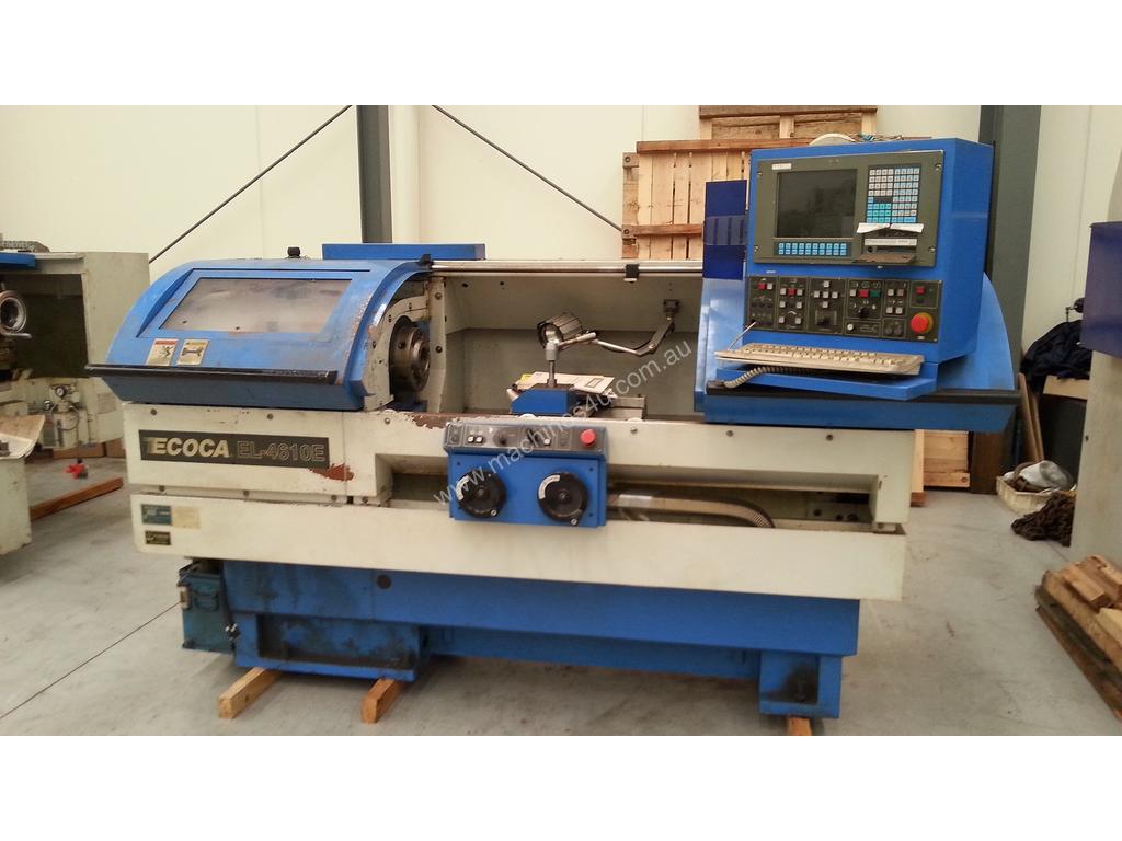

Hi, guys, I've seen this machine with a broken Mitsubishi controller for a good price.
I was thinking it might make pretty good retrofit project
The listing says it has a 75mm spindle and D1-8 chuck
It would be nice to know if I could reuse the servos with LinucCNC. I have no idea what they would be.
Any background on Ecoca's would be appreciated.
I Bought this machine and put an Adtech 4620 controller on it.
Its in my garage at home, and it works pretty good! :laugh: :laugh:

I have just purchased one of these lathes and I'm looking to retrofit/upgrade the control system. And I found myself here. I was wondering how did this conversion work out? Did you manage to retain the apron handwheel operation?
01 Mar 2022 12:46 #236105 by andypugh
You can certainly retain handwheel operation with LinuxCNC. My own lathe has jogwheels in the conventional locations for just this reason.
