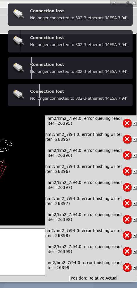

26 Nov 2021 22:02 #227692
by nduerr
Replied by nduerr on topic Bostomatic 400-2 Retrofit
1. Here is it "ip a" report A, with the link working B, after it drops.

I did notice that the sub net was wierd (10.10.10.2/8 brd 10.255.255.255 ) so I changed the /9 to /24 and I get 10.10.10.2/24 brd 10.10.10.255 now, which I believe is correct.
2. I'm fairly sure I shorted the diode, what component # is the diode so I can test it.? I checked resistance across the v in terminals and both directions measured 0.
Is this something that is fixable? Send it in or can I do it?

1. How did you set the static IP address? I have see Wicd break existing connections like this
(how can the host lose its IP address in "B"? this should no happen even if the link is down)

Diodes are fixed and the 7I83 cards seem to be working, there are 3 of the 4 leds on and I can see the corresponding pins. Yea!
However I am still having the dropping issues. I finally got a half file that didn't throw errors on start up, and within a minute linuxcnc says it lost connection to the 7I94 card. So as a last resort I saved all of the important files and did a fresh install of linuxcnc. Installed the needed software etc and got the same results. I even switched which NIC the 7I94 was connected to with the same results. I'm using a store bought network cable so I don't think that's the issue. I think I have tested every option for failure and I'm down to the 7I94 board itself. Anyone have anyideas?

07 Dec 2021 03:12 - 07 Dec 2021 03:54 #228503
Replied by PCW on topic Bostomatic 400-2 Retrofit
It's not likely firmware related since all firmware uses the same Ethernet code
This is still suspicious:

One reason for dropping a connection is too many timed out packets
What is your servo thread rate and what are the various tmax values?
(and CPU clock speed since tmax numbers are in CPU clock cycles)
halcmd show param *.tmax
(when linuxCNC is running)

Here are the results of halcmd show param *.tmax
bosto400@Bosto400-linuxcnc:~$ halcmd show param *tmax
Parameters:
Owner Type Dir Value Name
32 s32 RW 3272 abs.spindle.tmax
38 s32 RW 38928 classicladder.0.refresh.tmax
41 s32 RW 11700 foincr.tmax

Here is the fresh ip a before and after the connection drops see pics attached for error msgs. It dosen't seem like its dropping compleatly, like it has a loose wire.... The 7I94 is on the eno1(onboard) NIC now originally I had it on the brand new enp4s0 (intel card).
Before:
Before:

13 Dec 2021 01:37 - 13 Dec 2021 01:48 #228979
26 s32 RW 2792544 hm2_7i94.0.read.tmax
Is likely way too long (this is in CPU clock cycles)
I also have never seen "error finishing write" or "error queuing read"
Can you post your hal and ini files?
If you have Intel MACs, have you disabled IRQ coalescing
as described in the hm2_eth manual page?
Have you watched the 7I94 Link and status LEDs when running?
do you lose the link or is there possibly a power issue?
