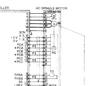

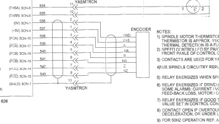

So I have been picking away at the to do list and I'm back on the Spindles...
I believe I have both spindles set up according to the spindles man page. Hal file attached.
Question 1: Is there a way to add halui pins and add them to Axes for the second spindle or is this something I will need to build in glade etc?
Question 2: I noticed that there is an encoder on my main spindle and I have the pin out the 3CN connector see pics. I am assuming that I feed a +-10 volts to the 626MTIII Drive and with the encoder input, the Drive is able to control speed etc independently. Can I tap off of these signals back to an encoder input & linuxcnc to get an actual speed and link up for ridge tapping?
Question 3: I am not getting any voltage reading from my 7I83 when I put the spindle into forward. The o-scope doesn't show any voltage either, but hal show sees the value increasing. I am assuming the analogout0-scalemax is doing the same as the scale function would do but I am not positive. Does anyone see something wrong in my hal or did I do more damage to the 7I83 cards than I first thought?
Thanks All!
