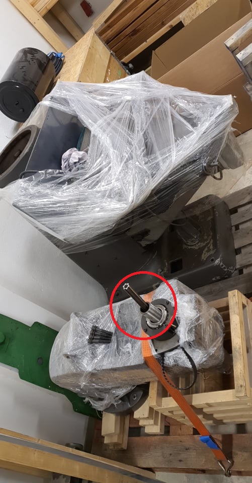

Hi.
I'm new in this forum and everything related with CNC is new for me.
I have Bridgeport textron Series 1 CNC Mill, unfortunately it doesn't have any electronics only aftermarket primopal steppers.
I wish that I can use it as mechanical macine and have all CNC features.
Most of the time I'm doing simple operations what is a lot faster in "mechanical mode" to carry out.
Definitely I need 4-axes.
All this CNC stuff is new for me, I have million questions.
I don't know where to start.

22 Feb 2022 09:02 - 22 Feb 2022 09:10 #235532
by turbohoolik
Replied by turbohoolik on topic Bridgeport textron Series 1 CNC
I don't have any decent pictures but it's better than nothing.
Bought this machine because it had mechanical damage turning transport because of that price was really good.
Right now I'm dealing with mechanical damage (cracked ball quill and crooked spindle shaft) what isn't big deal for me but that CNC stuff isn't for me but I'm learning.
