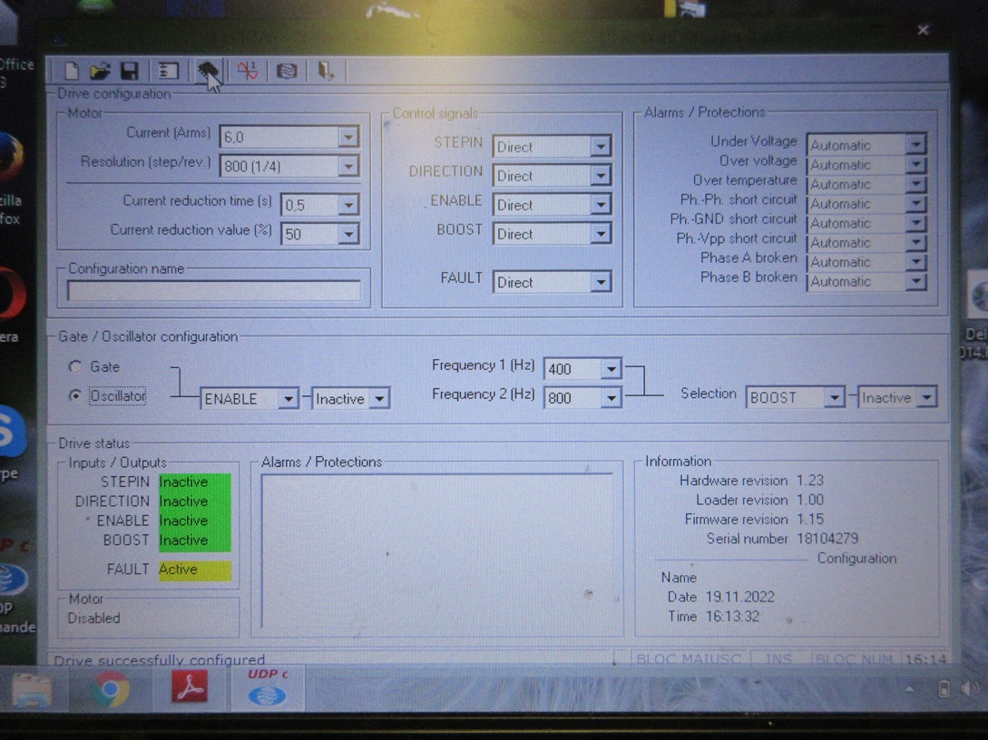

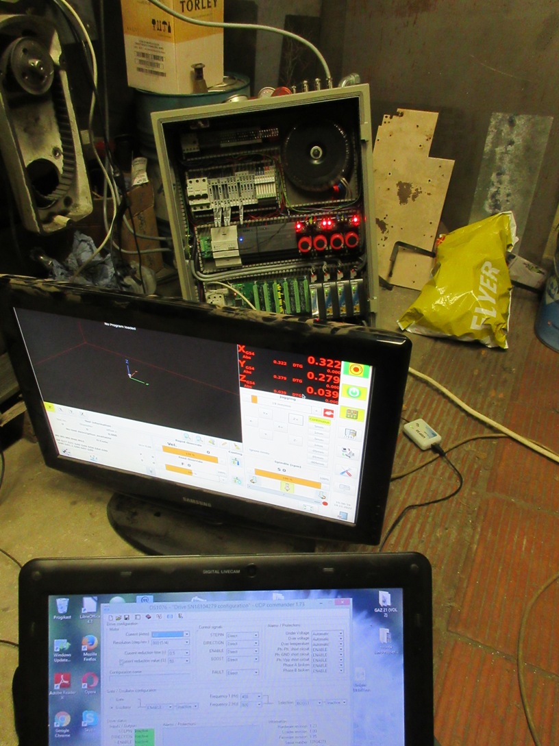

Looks like everything in the command line works except motors. When I'm clicking on X+, X-, Y+, Y-, Z+, Z- yellow light flashes on drives and in UDP commander stepin or stepin and direction will light yellow active light but motors doesn't turn.
I think I have to modify something in UDP commander but don't know what.
Od is that fault is active but doesn't show anything.
Or those motor are dead?

20 Nov 2022 17:13 #257166 by turbohoolik
Replied by turbohoolik on topic Bridgeport textron Series 1 CNC
It's hard to be stupid but all the others around you it is even harder.
Someone was mixed up some wires, I got it working.
