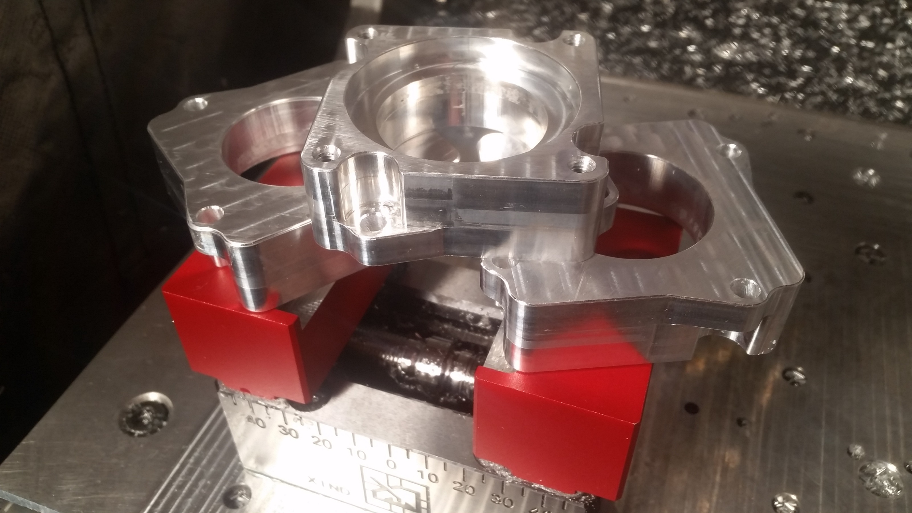

Replied by ihavenofish on topic Mini wannabe datron build
motor mounds for ethercat servos.
Last edit: 01 Feb 2025 21:35 by ihavenofish.
