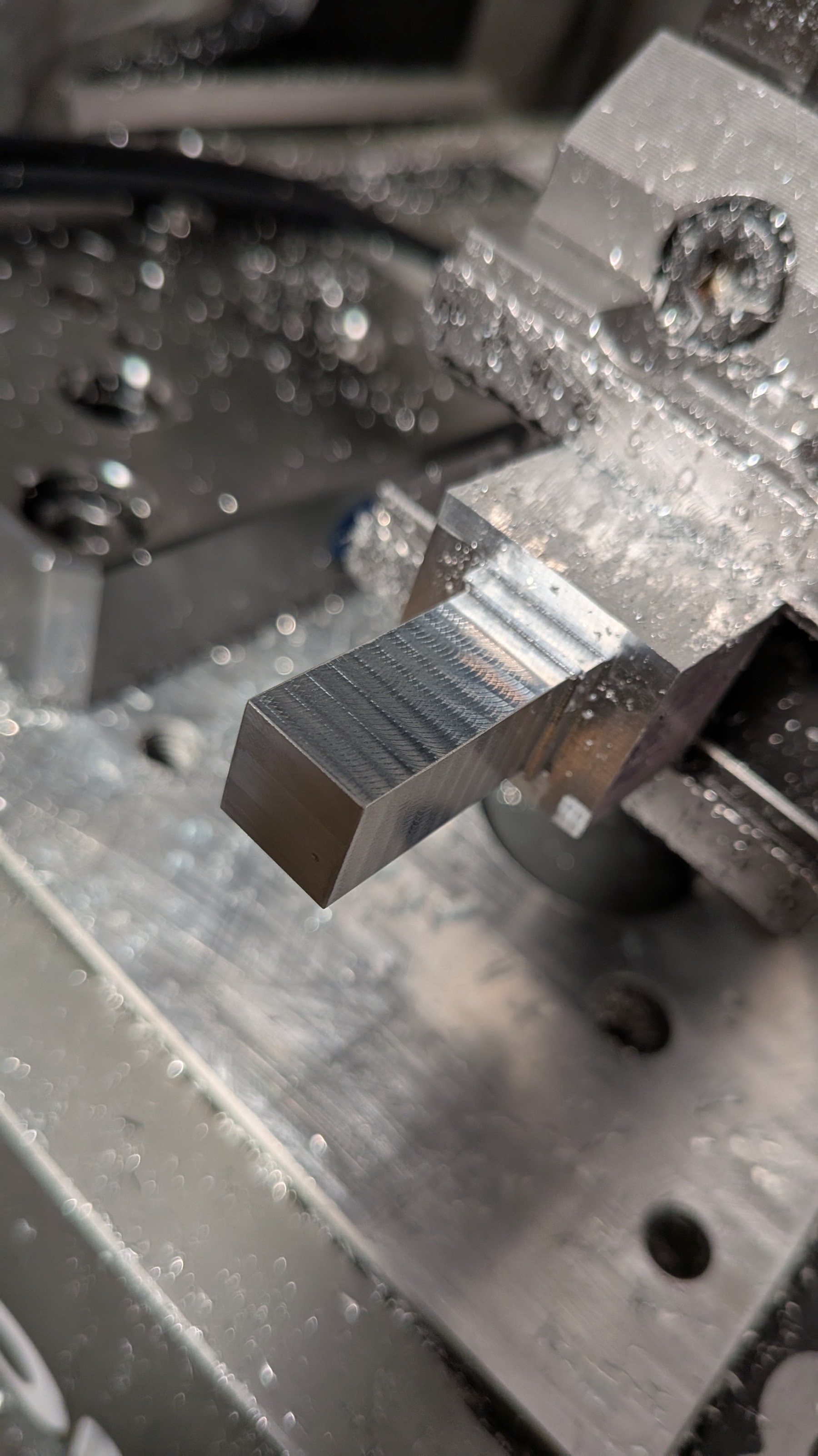

Yaaaay!
Replied by ihavenofish on topic Mini wannabe datron build
Yaaaay!
