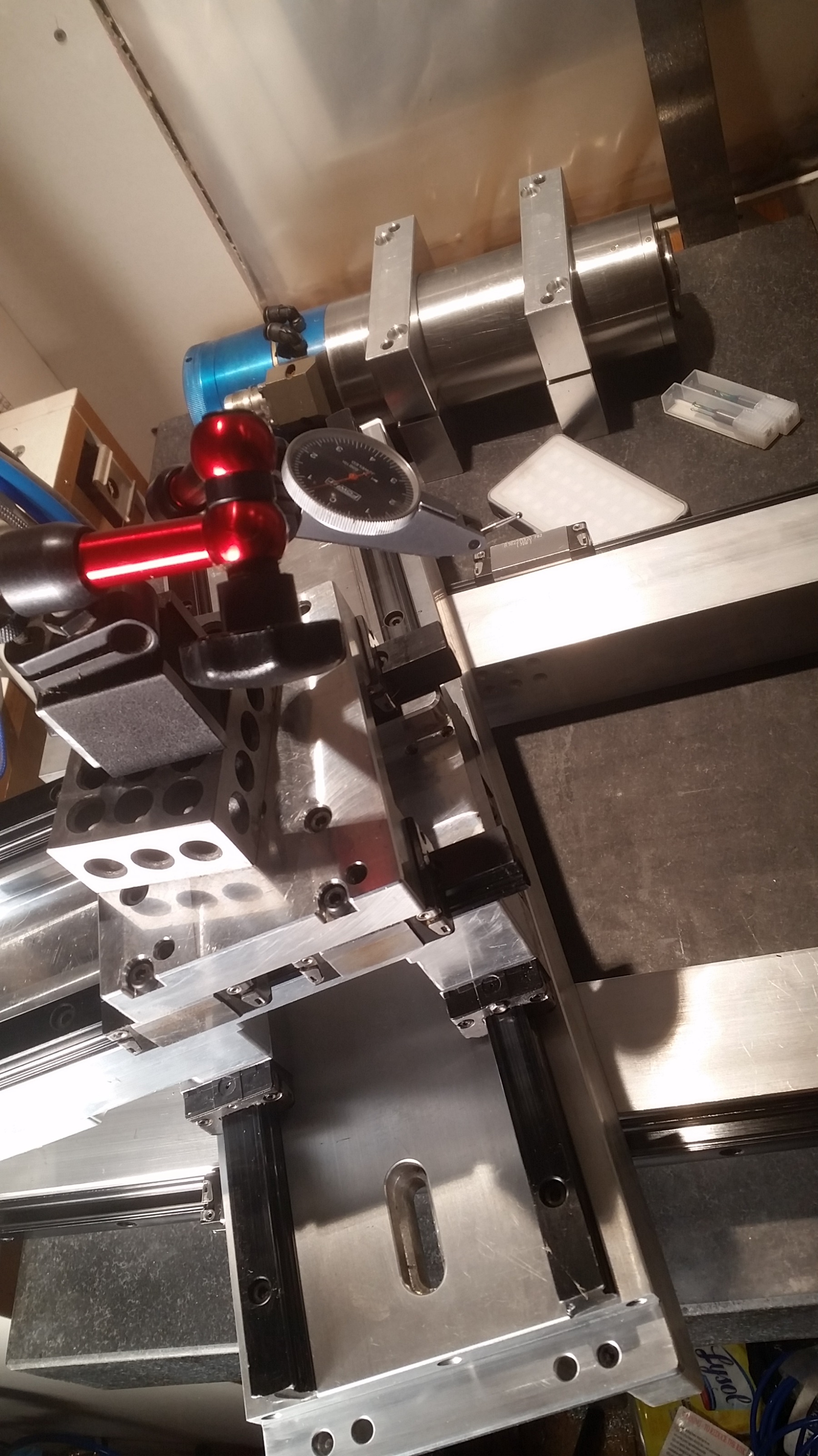

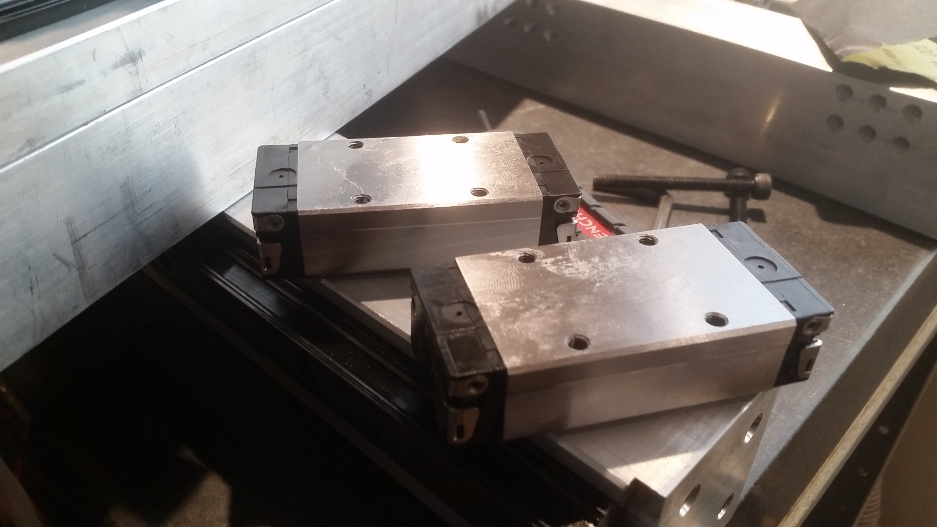

Machine partially rebuilt.
Did wind up finding that one of the linear blocks was damaged. order some new ones. I lapped and realigned everything, so things should be more precise now too - better than 0.001" over the whole work area pre compensation. Hopefully by next weekend its all running again with the new spindle and vacuum. woo.

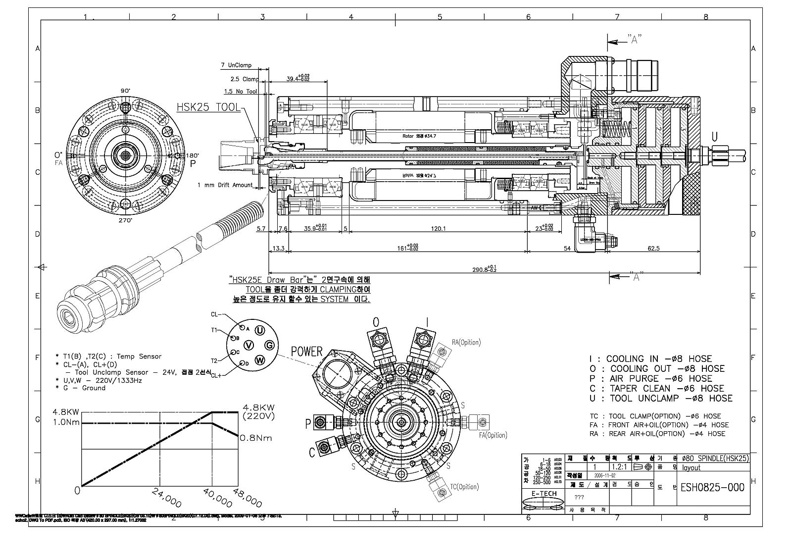

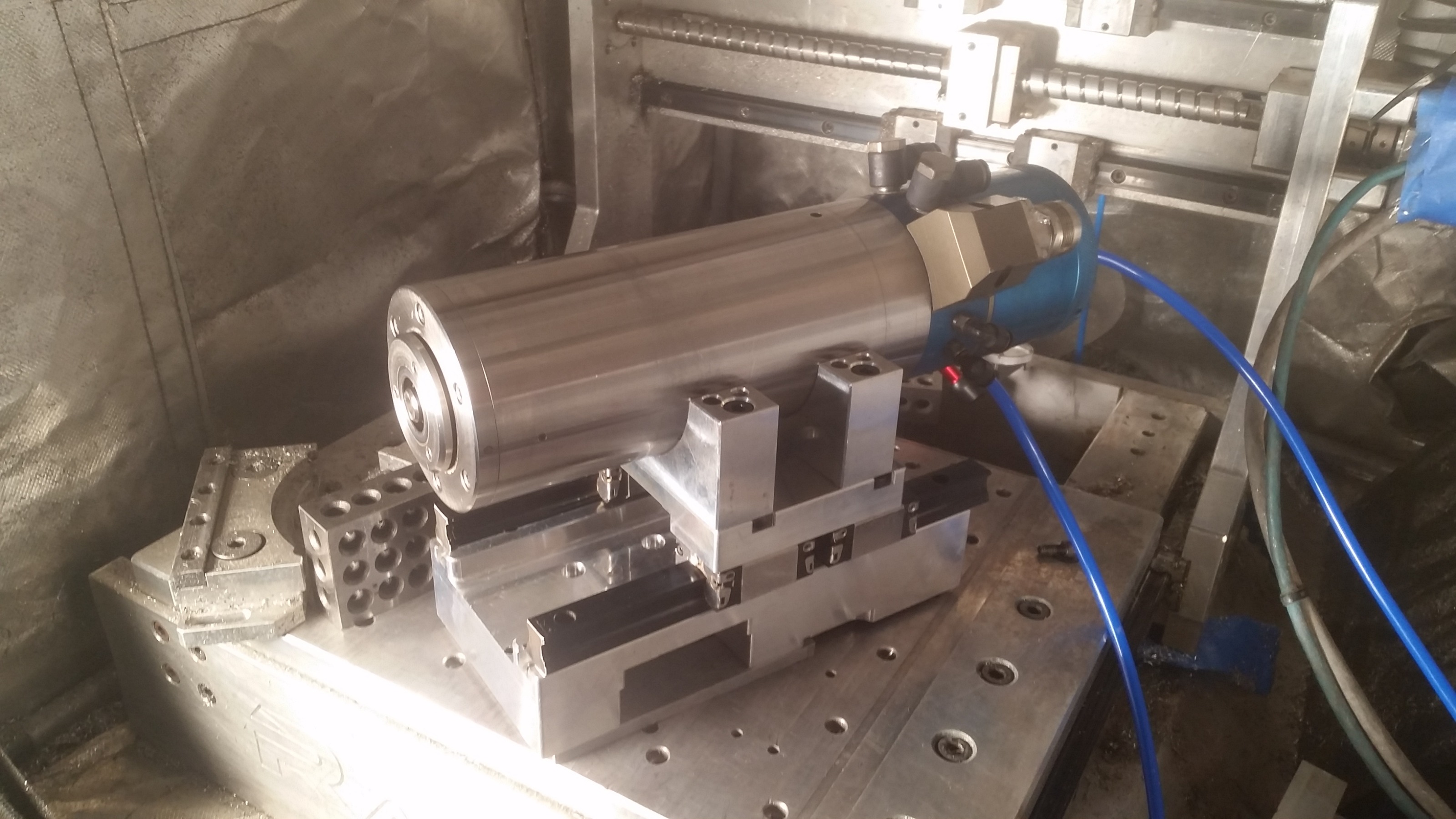

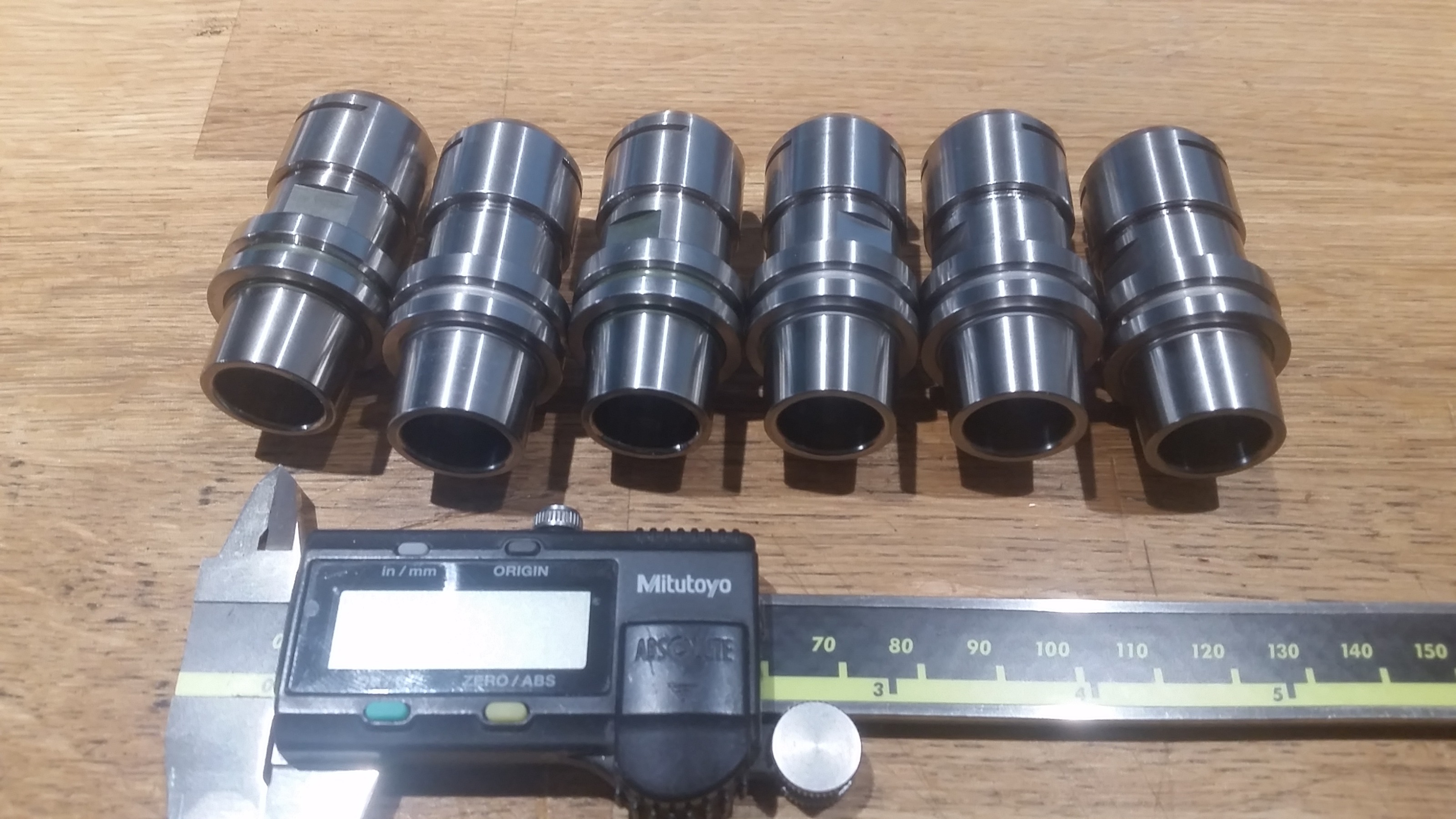

Nice. I could not find where you have told us what spindle you are using. Please share.
- tivoi
- Posts: 68
- Thank you received: 20
05 Jan 2025 09:33 - 05 Jan 2025 09:34 #318153
by tivoi
Replied by tivoi on topic Mini wannabe datron build
spindle is echo tech korean brand
hsk25 40krpm 4kw
hsk25 40krpm 4kw
Last edit: 05 Jan 2025 09:34 by tivoi.
The following user(s) said Thank You: rodw, ihavenofish

Ah, yes, sorry. I got this used from tivoi
I'm gonna start reconfiguring my wiring and mesa cards tonight.
Also trying to map out my air system.
- spindle release/taper clean
- spindle nose bearing purge
- MQL coolant
- air blast
- laser tool setter clean out
Hmmm.
Wonder how to arrange that.
- MQL coolant
- air blast
Hmmm.
