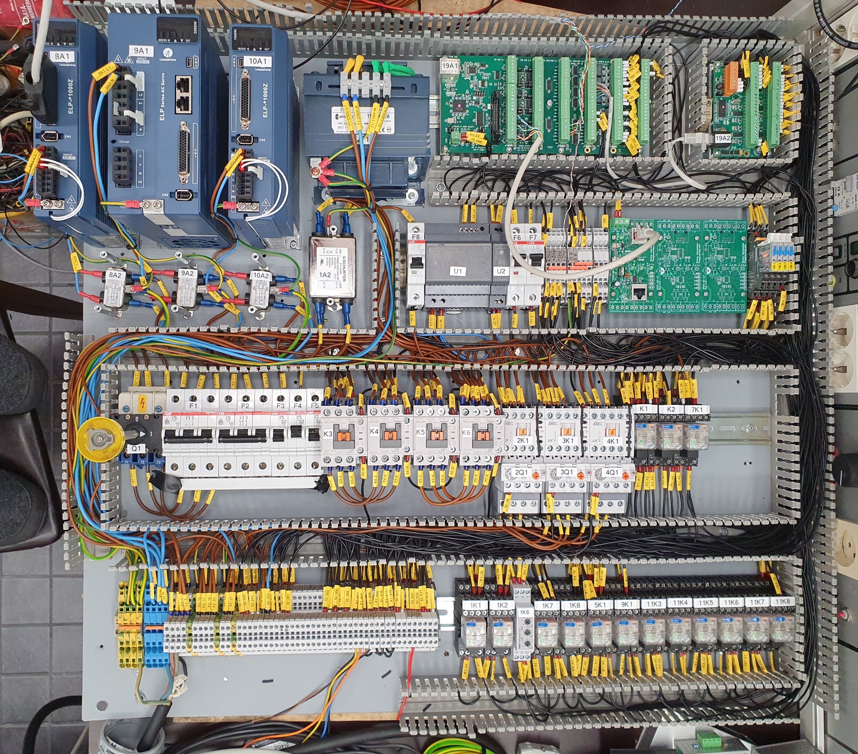

After a long time, I have been able to make some progress on the Maho the past couple of weeks.
The control cabinet starts to be close to finished. It's still missing the control wires for the gear change motors, because I do not yet have the brake resistors for those. And I need to make control cables for the servo drives, and solder up two more of my SinCos interpolators. But all in all, things are looking good, and it seems like everything will work out, even if it was a bit of a tight fit. I do still have some room for expanding with a few more terminal blocks and a couple of relays, in case I need to add something.
Hopefully I can complete the rest of the wiring over easter. The machine also start to be mechanically ready to start putting everything together.
