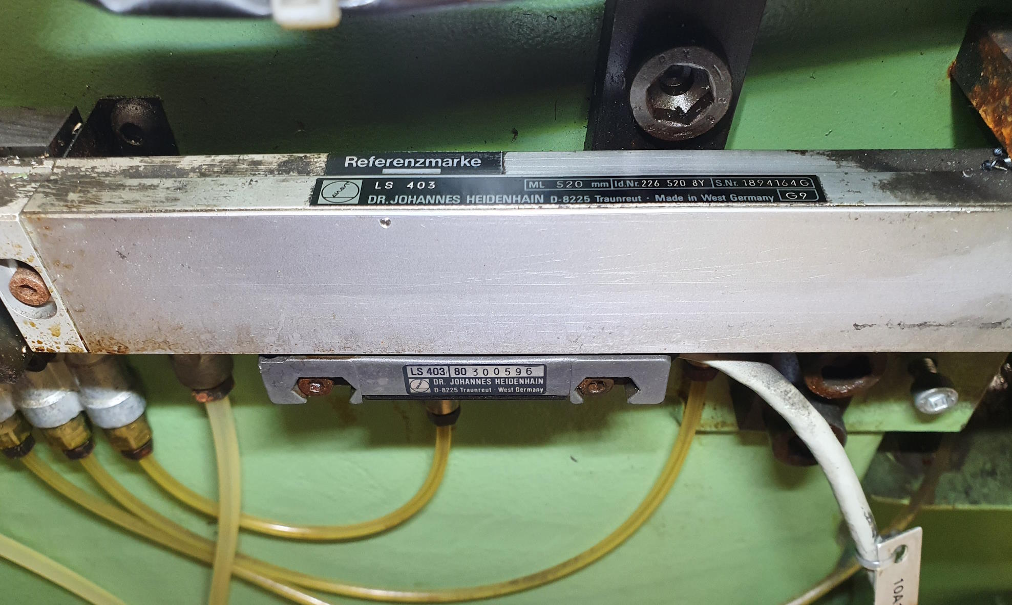

My scales have a marking showing where the index pulse should be (Referenzmarke), you can see that in the photo below. They are all close to the end.

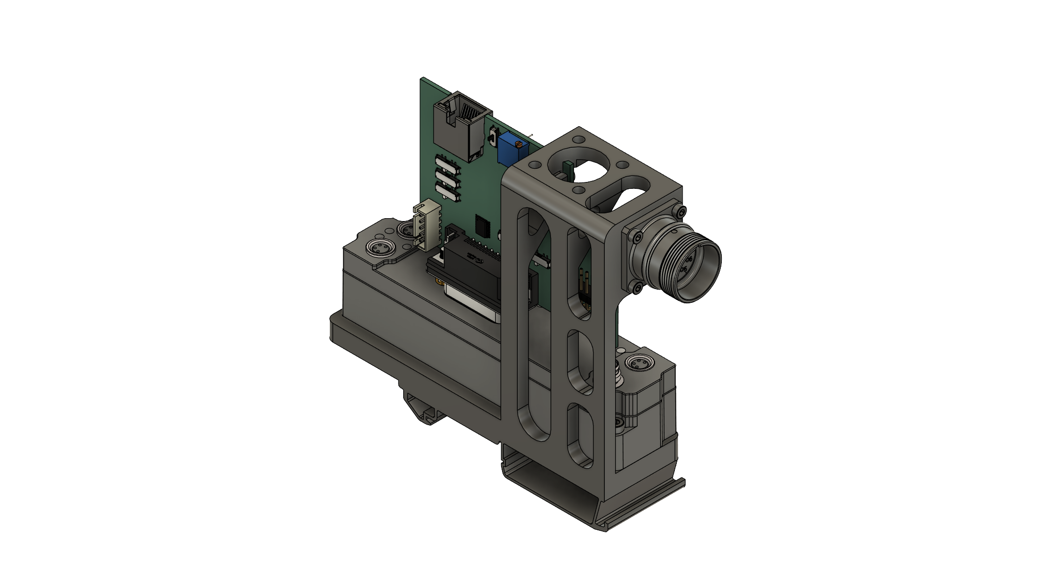

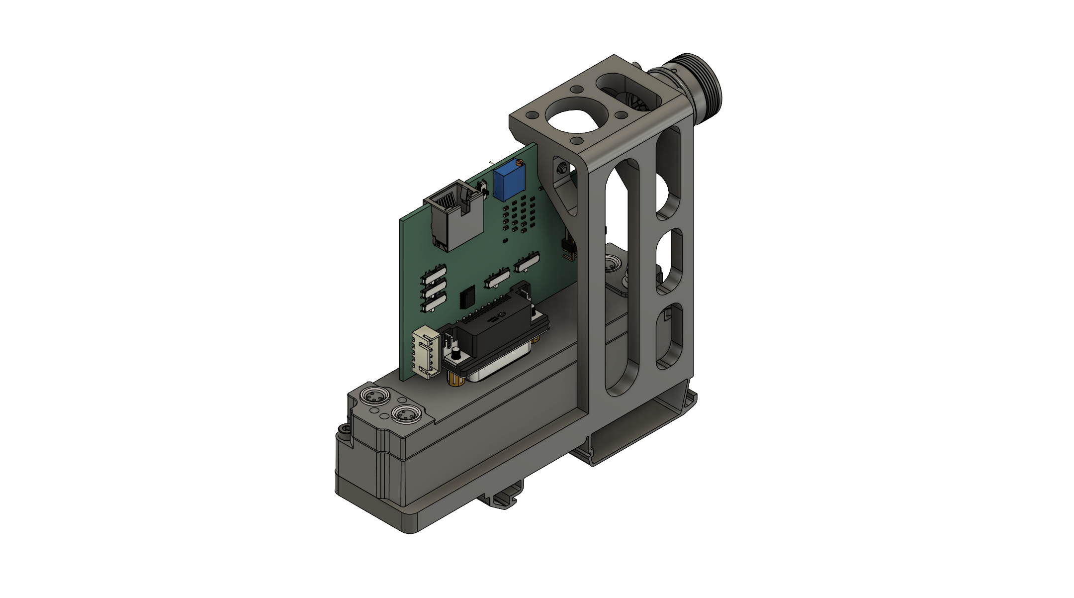

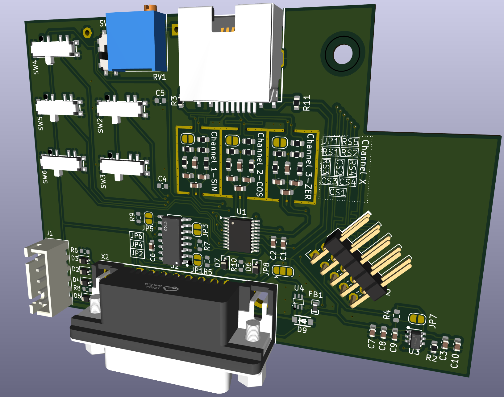

Hey folks,
i'm currently retrofitting my Maho MH400E and also needed a interpolator for my linear scales. I wanted to ditch the big clunky 3 channel board of Heidenhain and also avoid the EXEs with the same reason. Without knowing about your project i started my own interpolator also based on the iC-NV and reached out to the manufacturer iC-Haus. They kindly provided some more details and also the hint to have a look at the datasheet of the iC-NQC. In that datasheet, there is a analog frontend suggestion, that can be feed with 11µA, 1V and TTL signals (the NQC is a BiSS interpolator/converter). So i pretty much copied that input circuit (ditched the TTL input) and added some lowpass capacitors like they suggested in a other part of the datasheet. In case they don't work it's easy enough to just not populate them.
The current list of features are:
- DB15 plug matches pinout of Beckhoffs EP5101-0011
- In case somebody doesn't use it with a EP5101 it also supports reverse voltage protection
- All inputs and outputs are ESD safe
- Current limiter for sensor supply (currently set to 120 mA - can be bridged if not needed)
- Differential and single ended output possible (manually selectable via solder jumpers or by 0 ohm resistors)
- All signal lines are length matched to all other encoder channels
- Sensor can be plugged in via pin header or RJ45 (different pinout than yours - pin matched with Heidenhain)
- Board is meant as eval board as well as "finished product". Every input can be changed via a switch or the provided potentiometer
At the moment i'm at version 0.9.2, that's the first "finished" pcb layout, the texts for the switches, testpoints, ... are missing. I'll get to these in around 2 weeks, when my exams are over.
You can find the project here on Github: github.com/PedPEx/SinCosEnc-Conv_EP5101
When you have any inputs on that project, just let me know
