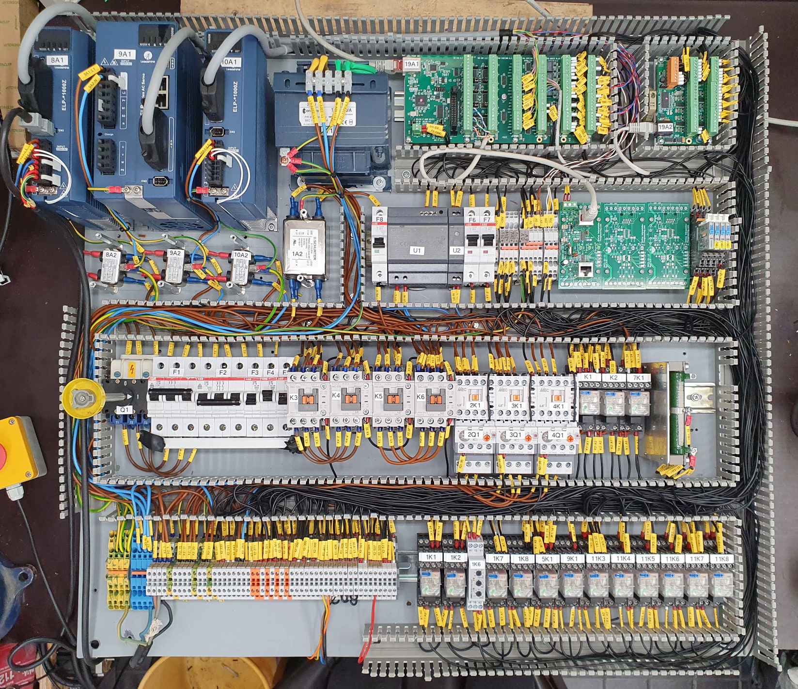

19 Jul 2024 19:23 #305666
by Finngineering
Replied by Finngineering on topic Un-lobotomizing a Maho MH600T
First of all, I would like to apologize for the long time without reply from my side.
Work and life has kept me busy...It would appear the design of the crowbar circuit is not good enough. The zener voltage "knee" is not sharp enough and component substitutions and tolerances almost means it has to be tuned to work as intended. I am considering updating the design based on the (last) TL431 design from axotron.se/index_en.php?page=26
I would anyway prefer to have the ethernet jacks rotated 180° so I could use cables with 90° connectors to make it a bit more tidy.

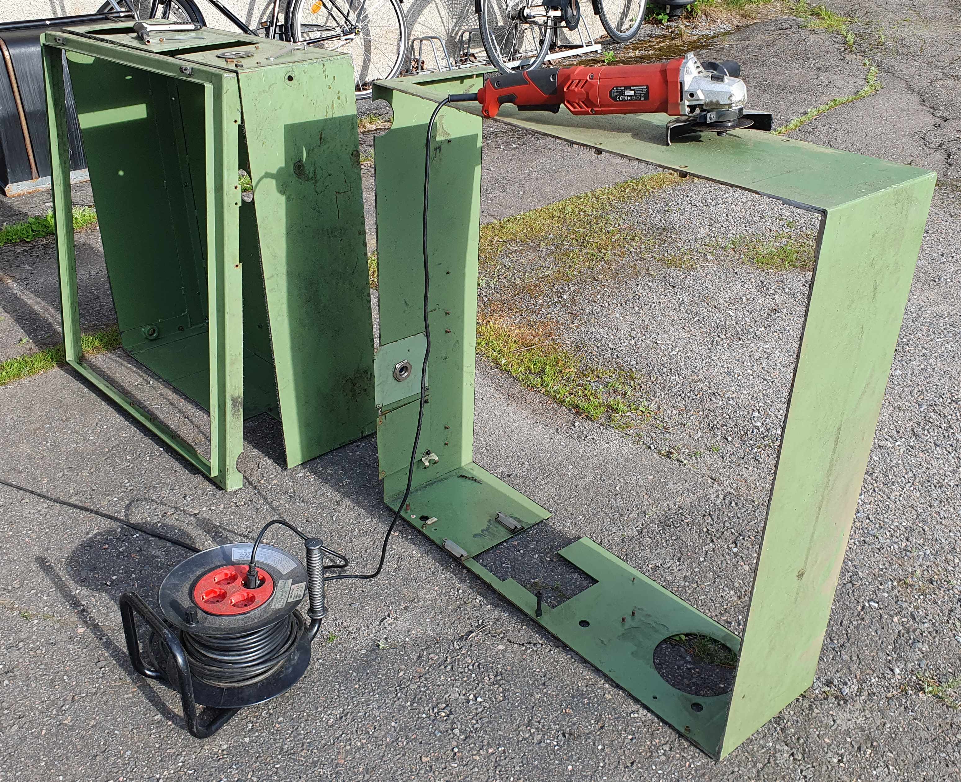

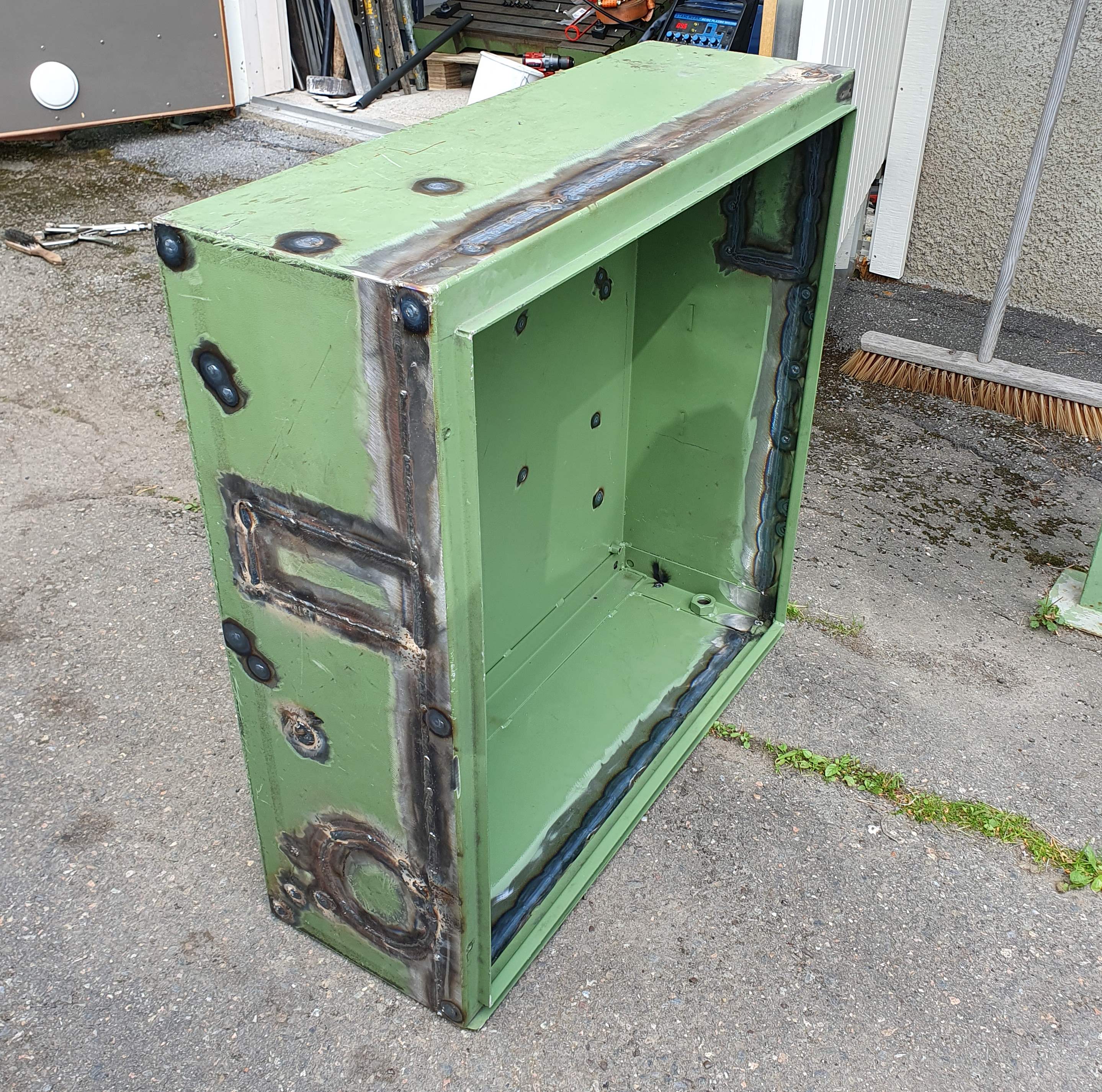

I have worked a bit on the machine as well and started putting it back together. I am not in a situation where I almost need the electrical cabinet before proceeding. For that one I took some inspiration from RotarySMP and cut a section ~25 cm deep out of the cabinet. I will put the mill in a corner, and this will end up saving me a decent amount of space. At the same time, I patched up all of the old holes in it. And with some filler and beautiful Maho green, it starts looking decent again.

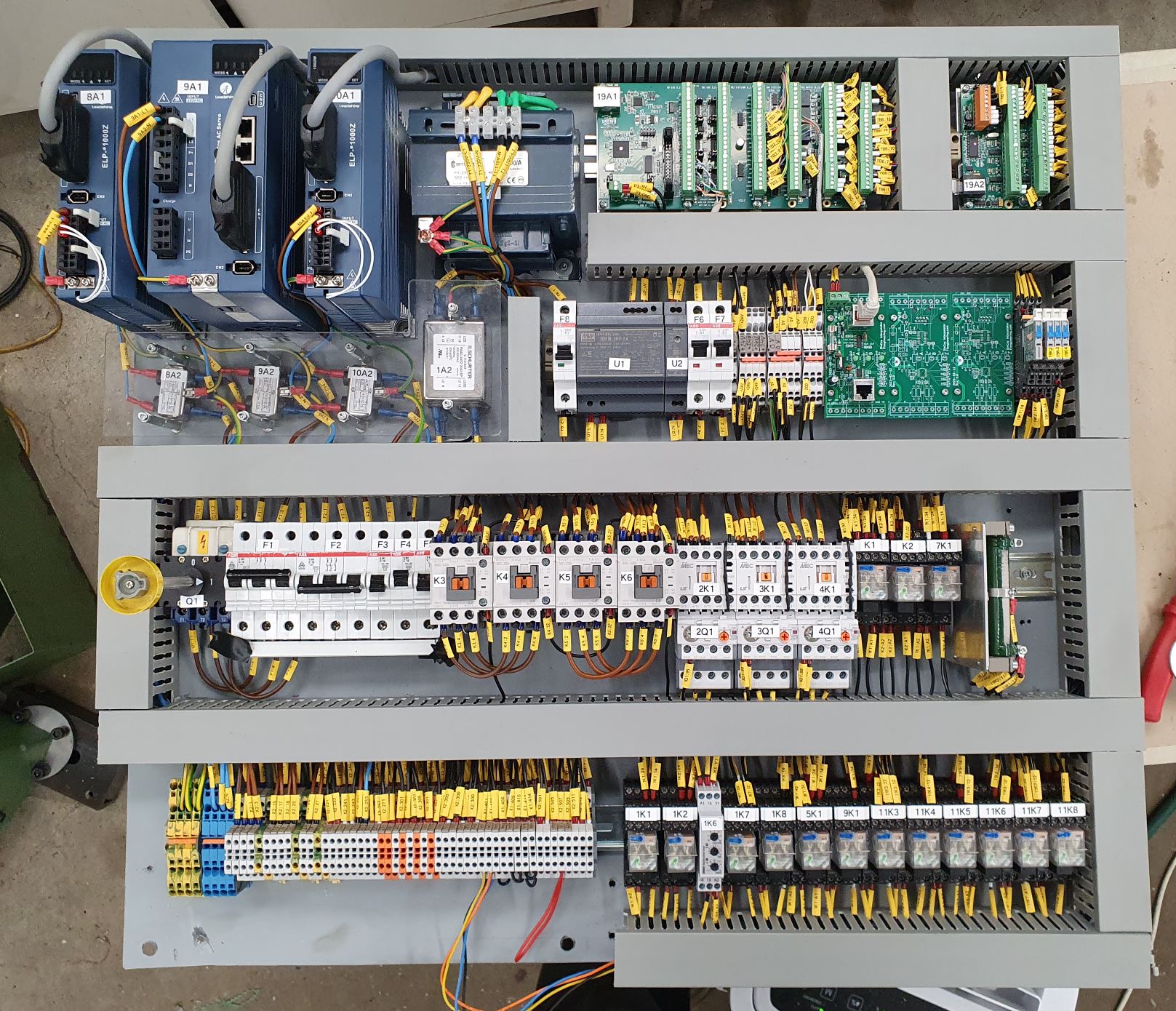

The electrical back plate also starts to be complete, at least for now. The planned wiring is done, but I still need two more SinCos interpolators, and sawing and cable channel covers to length. But regardless of that, the back plate can be installed to the electrical cabinet once that is fastened to the mill. Then external wiring and testing can start for real. I used orange terminal blocks to indicate that they have protection inside. This was a convenient possibility with the two level terminal blocks. For the solenoids, I soldered in diodes (1N4004) and for that gearbox motors I used varistors.

19 Jul 2024 19:32 #305667
by Finngineering
Here is a photo of the back plate. For some reason I was not able to attach it to the previous message.
Offtopic, but is there also a resolution (actually more like width*height) limitation in addition to the 1.6 Mb size limit informed when posting a message to the forums? When I cut the widht*height to half, I could post. But previously it would not allow me to post it even with an image size < 500 kB.

26 Jul 2024 11:29 #306070
by RotarySMP
Replied by RotarySMP on topic Un-lobotomizing a Maho MH600T
You made a fantastic job on that cabinet. Respect!

20 Sep 2024 07:28 #310499
by Finngineering
A bit more progress.

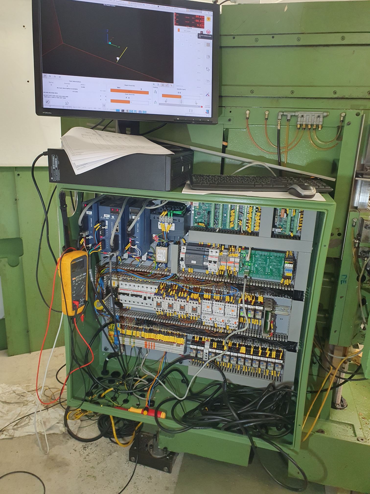

I cut the cable channel covers to length and also the touch protection plate for the filters under the servo drives. This is most likely as nice a photo as I will ever get from the cabinet. From here it's most likely only downhill
I have put the cabinet on the machine, and started with some preliminary commissioning. The first task is just to get the axes moving so I can adjust the linear scales and end stops (and that doesn't require much else than connecting the servos). Once that is done I will try to do some cable management for all the cables on the machine. Because I moved the electrical cabinet closer to the table, I cannot reuse the original way the cables were routed from the X/Z axes. But also in some other areas, I want to tie the cables down somehow.
