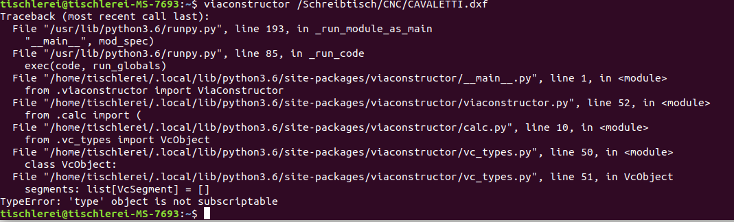

- mgm
- Posts: 210
- Thank you received: 13
22 Aug 2022 14:39 #250206
by mgm
Replied by mgm on topic Cad/Cam software for Linux
- meister
- Posts: 794
- Thank you received: 494
22 Aug 2022 14:59 #250211
by meister
Replied by meister on topic Cad/Cam software for Linux
You are using Python3.6, this will only works with Python3.9 and newer
, sorry
