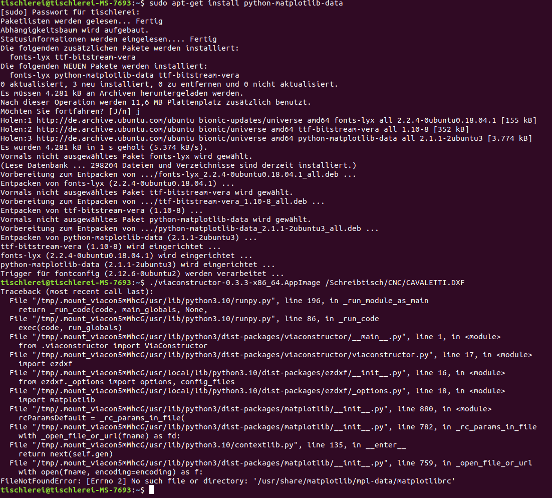

hmm, which distribution do you use ?
on Debian/ubuntu you can try:
apt-get install python-matplotlib-data

I still have 18.04 on my company computer.
I am currently updating my debian10 to Python 3.9 in my VM. Will try it then with Debian!

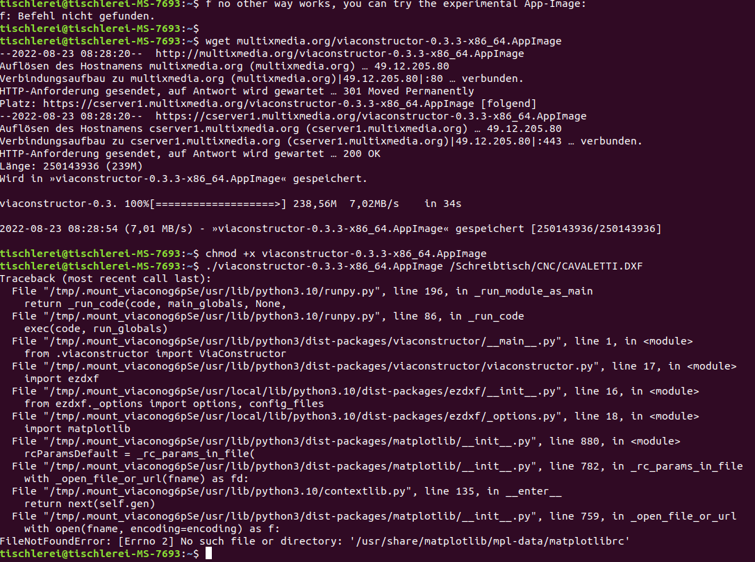

I now have my debian10 in my VM on Python3.9.1.
Now that I have reinstalled some things and I still have
no matching distribution found for pyqt5-qt5 =5.15.2 (from pyqt5)
at the inatalation of 'viaconstructor' I ran out of memory in the VM.
The last suggestion with:
does not work either ...
I must be out of my depth with this!!!
I just do not understand where the problem lies ...
Last edit: 23 Aug 2022 08:14 by mgm.

check your version with:
python3 -V
it is possible that it is linked to the old version.
and than try:
python3.9 -V
if this is the right version, than you can use :
python3.9 -m pip install viaconstructor
or maybe (in short)
pip3.9 install viaconstructor
if this works, start viaconstructor with:
python3.9 -m viaconstructor PATH_TO_DXF
Sorry for this complications, it's only testet on Debian11 and Ubuntu 22.04.
but thank you for giving a chance !
python3 -V
and than try:
python3.9 -V
or maybe (in short)
