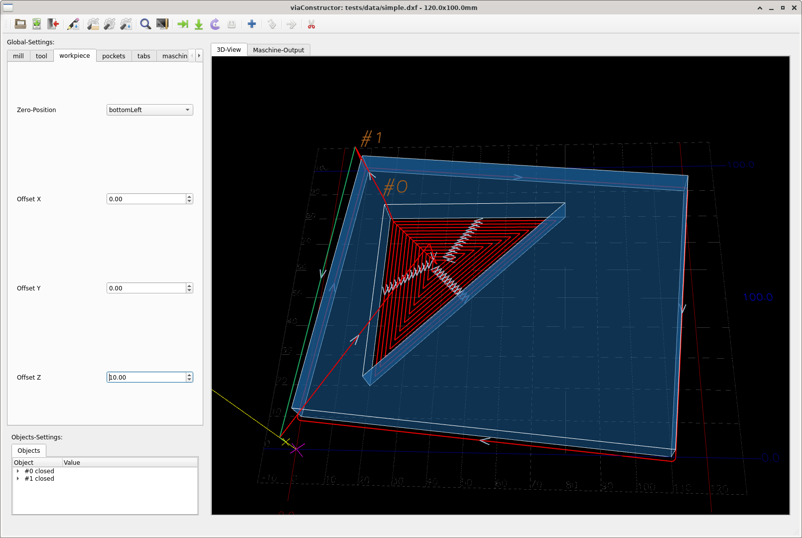

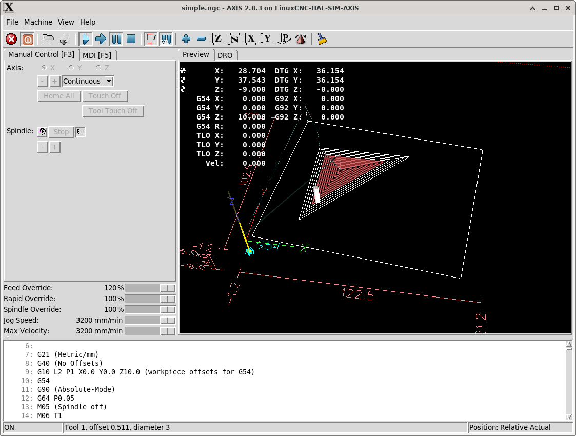

ok, but i can also set:
G10 L2 P1 X0 Y0 Z9.0
G54
to set the G54 offsets and the each z move is added by 9.0
i think this is better, because, you can edit the gcode by hand to set other offsets
EDIT:
or G55 for the offsets and G54 keeps 0,0,0
G54
EDIT:

i add new option 'maschine supports g54' to toggle between G54 and offsets in gcode positions
