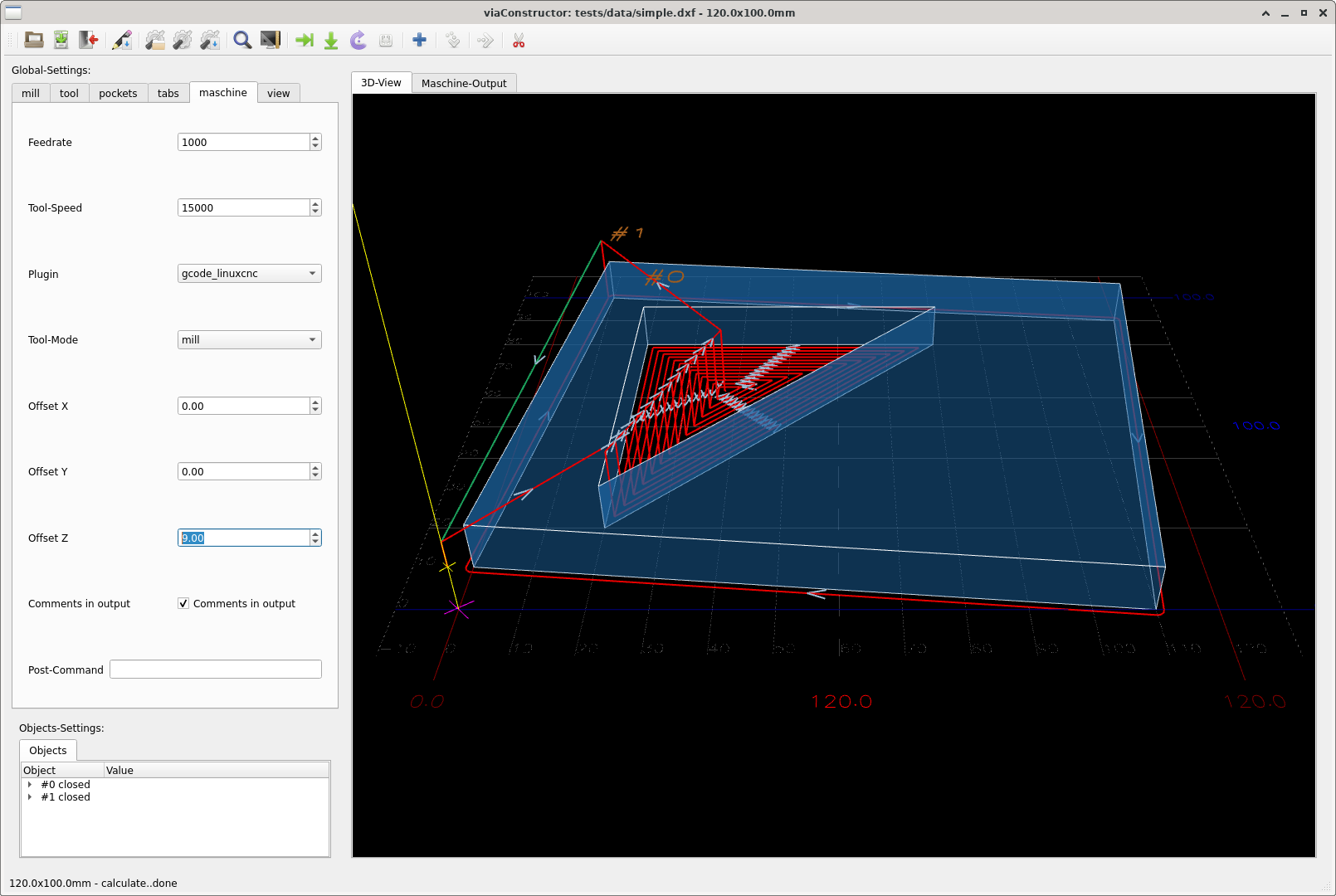

- meister
- Posts: 805
- Thank you received: 502
24 Aug 2022 12:32 - 24 Aug 2022 12:34 #250322
by meister
Replied by meister on topic Cad/Cam software for Linux
Last edit: 24 Aug 2022 12:34 by meister.
- mgm
- Posts: 210
- Thank you received: 13
24 Aug 2022 14:07 #250326
by mgm
Replied by mgm on topic Cad/Cam software for Linux
The line 'G54 X0.0 Y0.0 Z9.0' does not work.
does not work it makes no sense!
You can't assign any parameters to G54!
There should be an input field for the workpiece thickness.
The machining depth would then have to be subtracted from this workpiece thickness.
If I make for example a subprogram routine for NGCGUI
I use for the workpiece thickness a variable with which afterwards in the g-code is worked. Maybe something like this is possible?
It would be great if you could choose whether "Z0" is machine table or workpiece surface, for users who touch your workpiece surface.
I hope it is okay if I note something?
