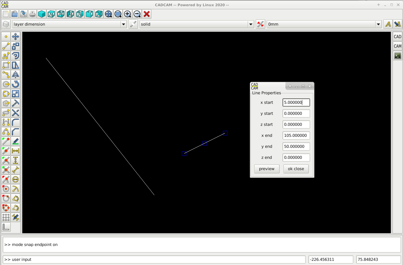

The Cadcam program written in C++ Codeblocks goes steady forward. Using Codeblocks is a learning process.
I have updated some snap buttons with led style. Managed to show a child dialog when the right mouse button is clicked.

99% of my work is done in Qt. But i am always aware that Qt could change policy in the future.
With that in mind i write code that could be ported to another framework, like Codeblocks quite easy.
Codeblock's is quite buggy, it crashes quite often. Qt is very stable.
Qt has a very informative debug output, wich is nice.
