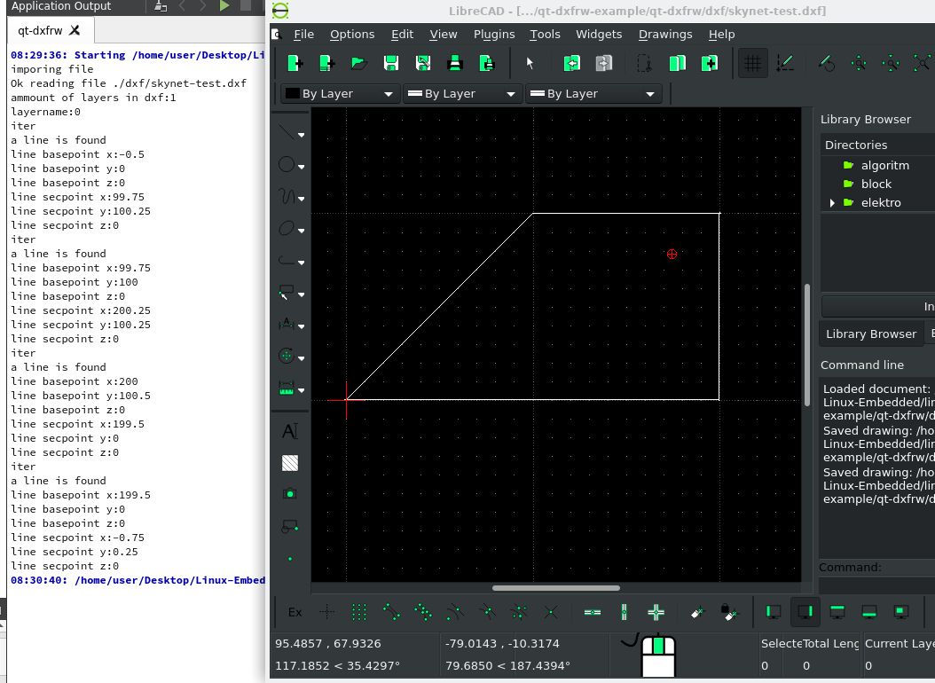

Oke then i tested the dxf write. This was quite easy. Writing the dxf is done in the examplewriter.cpp class.
But reading the dxf took more time.
But after 4 hours of digging. I got into this result :
The data is retrieved by :Every block is a entity (line, arc, etc). In the mainwindow you see i itterate through the blocks.
Attached a very raw code for you. This code has to be cleaned up, and maybe rewritten to make it more readable.

QMAKE_EXTRA_TARGETS += first copydataOke then i tested the dxf write. This was quite easy. Writing the dxf is done in the examplewriter.cpp class.
auto blocks = _data->mBlock->ent;Attached a very raw code for you. This code has to be cleaned up, and maybe rewritten to make it more readable.

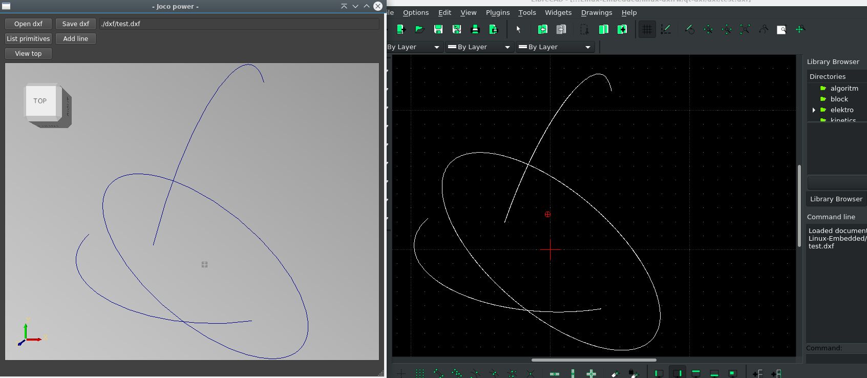

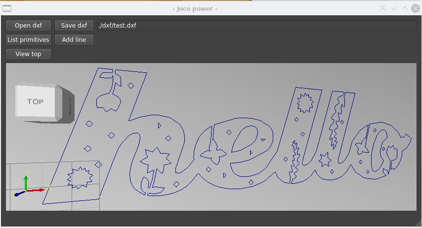

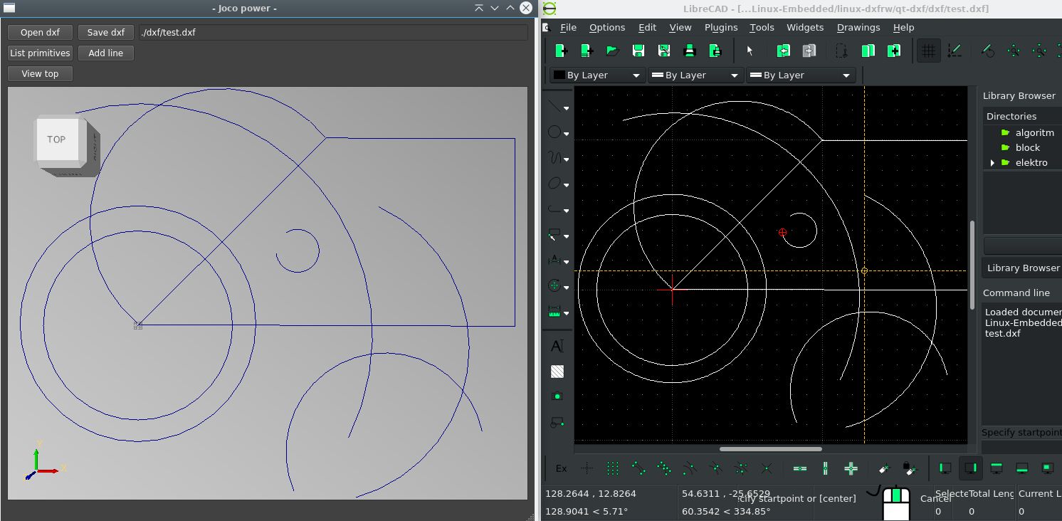

Just tested loading a dxf and add the primitives to the opencascade.
It looks like the arc's are ok.
filetransfer.io/data-package/MPpXn05n#link
Ok at this stage we can:
1. Load a dxf and save a dxf.
2. Display the dxf content in opencascade.
3. Add primitives to the dxf and save the dxf.

Just added some extra opencascade code to preview the ellipse and ellipse arc's.
If it's a 3d dxf, the opencascade display's the ellipse and ellipse arc in 3d.

Hi Joco,
And slow down! Some of us need to sleep. Ok.
Simple c++ is good.
Clean coding is a art.
Oke. Now last item for today. The 3d cubic spline. I did this code before a few weeks ago for the robot project.
It will take no long time.
I now have also added the lwpolyline. I spotted a bug in the dxfrwlib. It has no z value for lwpolylines. Catcha.
[edit]
Ok the spline is also done. Now it's bed time. Good night !
To test i downloaded a sample dxf file from : www.cncdesignshop.com/promotions/free-dxf-file-downloads.html
It loaded ok.
