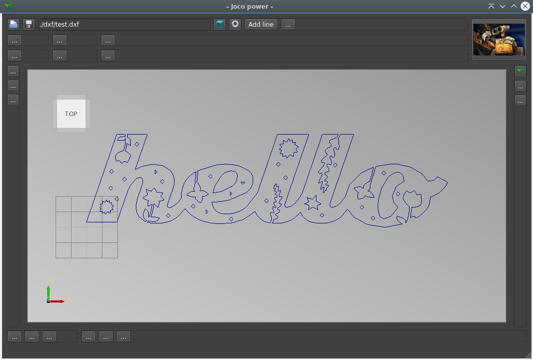

Got my feet a little wet tonight with that sample code. After some reading added a method to create a circle like the line example. Linked it off the same “add line” button. Executed, saved dxf, reloaded and the new circle and line was there.
Obviously super simple but got me into exploring the code to find the correct entity type and seeing the object inheritance of DRW_Circle.
Also finally managed to get qtcreator behaving correctly at long last. Amazing what happens when you RTFM.
Cheers - James.

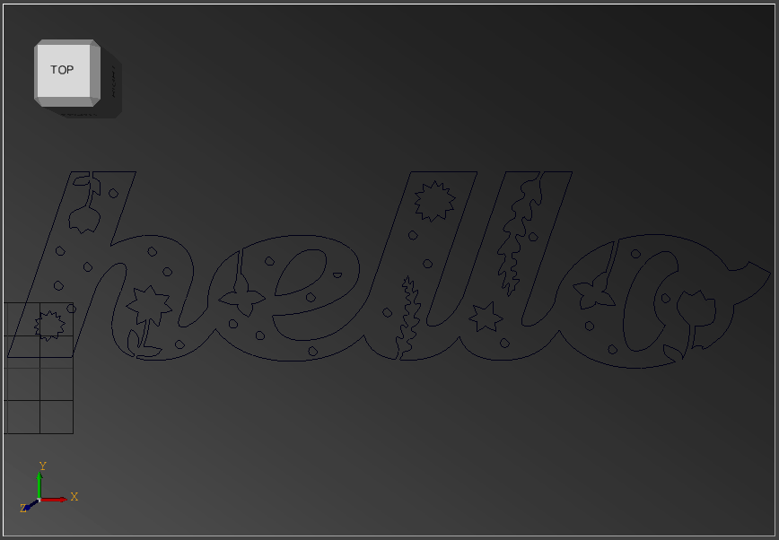

28 May 2021 09:16 - 28 May 2021 09:17 #210503
by Grotius
Replied by Grotius on topic C++ CadCam program development with CodeBlocks instead of QT
Hi Joco,
) I think we are loosing too much context from the dxf.
It's good to save more dxf content into the databucket. Layer's and color's are good to add.
Then you can indeed do a operation based on a layer or color.
I think you can try to add more info. If you have problem's doing this, just give a call.
For info. You can set the primitive colors in opencascade based on rgba values.
librecad it treats the entire outline of the "hello" as a single entity.
That is correct. It is more a coincedence with this drawing. It's a lwpolyline. I coded to convert this into line's already.
For the cam you have to go for lines and arc's to stay gcode compatible.
If you think in splines, ellipses or lwpolylines, linuxcnc can not deal this primitives.
Inkscape saves splines and ellipses as lines in dxf.
In the end you can only use lines and arc's for the gcode processing.
Then for the coding it's easy to convert splines, ellipses, lwpolylines etc into lines. I have example's function's on the git for this.
Then for the coding there is only left line and arc's.
This make's your code quite compact.

Ok. Ive got a rough working implementation of a databucket using an object graph of the following top down structure:The Geometry class instances is one of the following derived classes from the base Geom class: Point, Line, Arc, Circle. I am still toying with splines as they can be represented using gcode. But the others are safer from a gcode perspective.
So next is to convert the visualisation to drive off the databucket.
Bit of a learning curve but getting there.
Cheers.

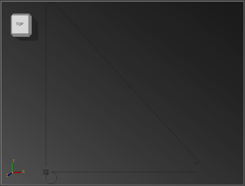

Learning continues. Have moved the visualisation load to operate off the databucket. Can't seem to get the colours to change to something with a better contrast in the UI even though I have them set as I want in qtdesigner. Not sure what is happening there.
Also fighting with the conversion of the polyline bulge + line concept to create an arc. Too long since high school and all that kind of triangle/circle stuff. The only online examples I have found are in lisp. So who knows what other alterations are happening under the hood in those functions.
Cheers - J.
Cheers - J.

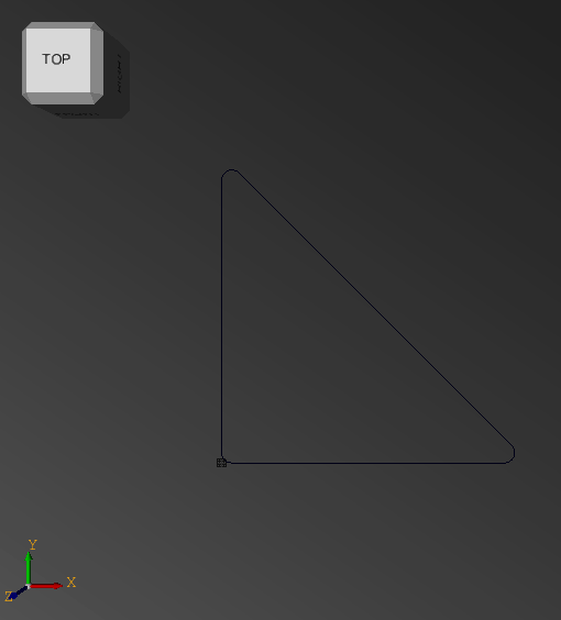

31 May 2021 00:32 #210763
by Joco
Replied by Joco on topic C++ CadCam program development with CodeBlocks instead of QT
Well a bit of reading into how the dxf2gcode code base deals with these curves and some clearer maths examples and we seem to be winning a little bit. Following screen samples all based off a loaded databucket with geom occ paint methods in the relevant geometry class. No more reading the dxf file once its loaded into the databucket.
Fixed version of last post:
And the "master" test file:
