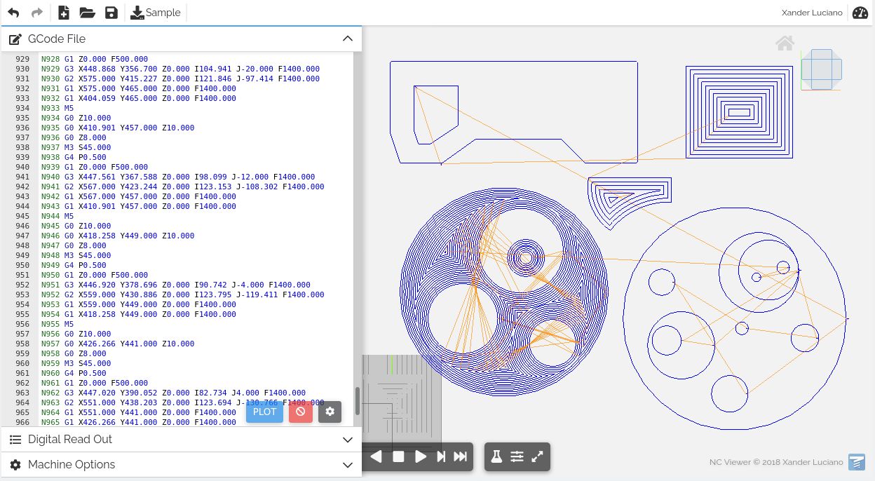

After some intensive coding the pocket's can be processed from the selected cad-layer.
The program can do pockets with- or without islands. This process is automated by the "keep parts together" algoritme.
User can set the base offset and the pocket internal offset (overlap).
I think the output is ok.
A thing todo is to create a operation box. Where multiple operation's can be added into one program.
But for now copy and paste will do this.

I think for now it's ok. The program is fast. 4000 gcode lines in 1 sec.
It's time to create a linux installer.
This script worked for me on amd64 linux eleven :

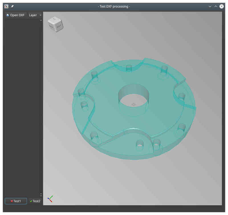

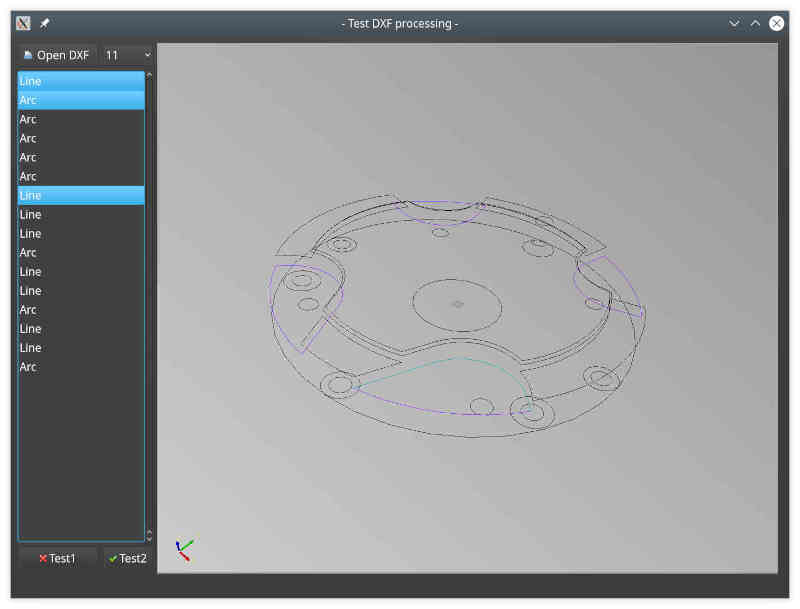

I played with your stuff and changed it to be able to load dxf-files written by freecad from 3D-models like this:
I grouped the line-elements by their height, which then can be selected from combobox. All elements from that "layer" are shown in the listbox, so that it is easy to create a shape by selecting listbox entries.
Then I discovered the ability of your opencascade class to load step files. So I saved the model from freecad as step-file and imported that:
Unfortunately all elements are glued into one piece.
Don't know, if I got it right, but it looks like the line elements are painted with different color than the surfaces.
Could you shine me a light on how to access single elements from stepfile import?
- Grotius
- Posts: 2419
- Thank you received: 2349
07 Aug 2021 14:32 #217120
by Grotius
Replied by Grotius on topic C++ CadCam program development with CodeBlocks instead of QT
Nice work !
The occ->opencascade.cpp->visit function can be expanded to read more data from the stepfile. Now only the solid is loaded to minimize
the memory load displaying a 3d model only.
The stepfile loading can be a hard class to set up.
You can take a look in the source code. In qt you can follow the #include ... to view the source file directly.
But there are online example's.
You could look for code snippets in older releases like : github.com/grotius-cnc/Skynet_Robot_Cont...t/releases/tag/1.0.2
