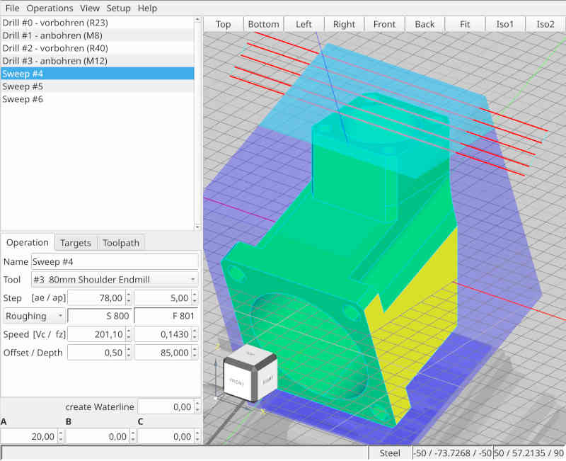

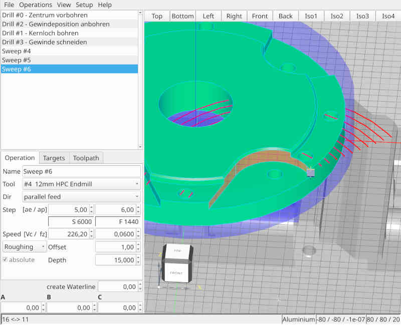

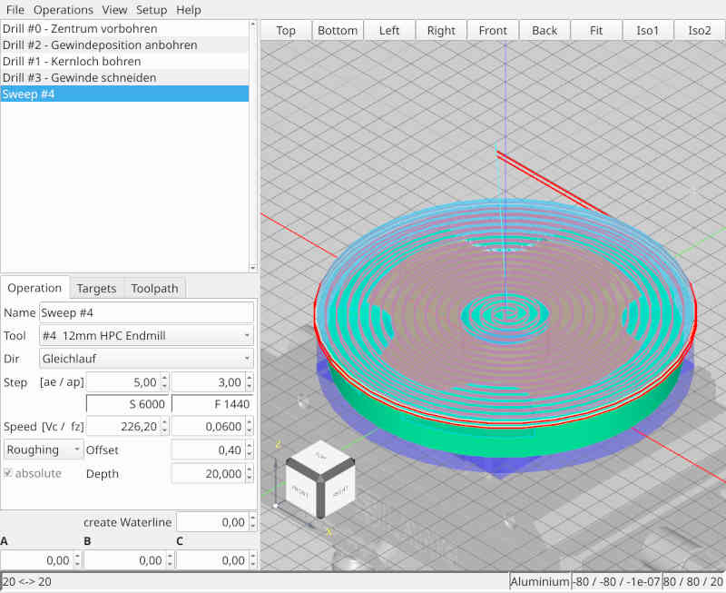

Here is a small teaser of my current project. The work is tougher and more extensive than expected. But that is probably usually so.
I have a hard time with the graphics, because I am simply underexposed at that corner.
Anyway - the last days were successful, so I can already create a few tool paths based on 3D-model and defined tools.
simple 3-Axis machining:
indexed 5-Axis machining:
Repository available at: kuteCAM

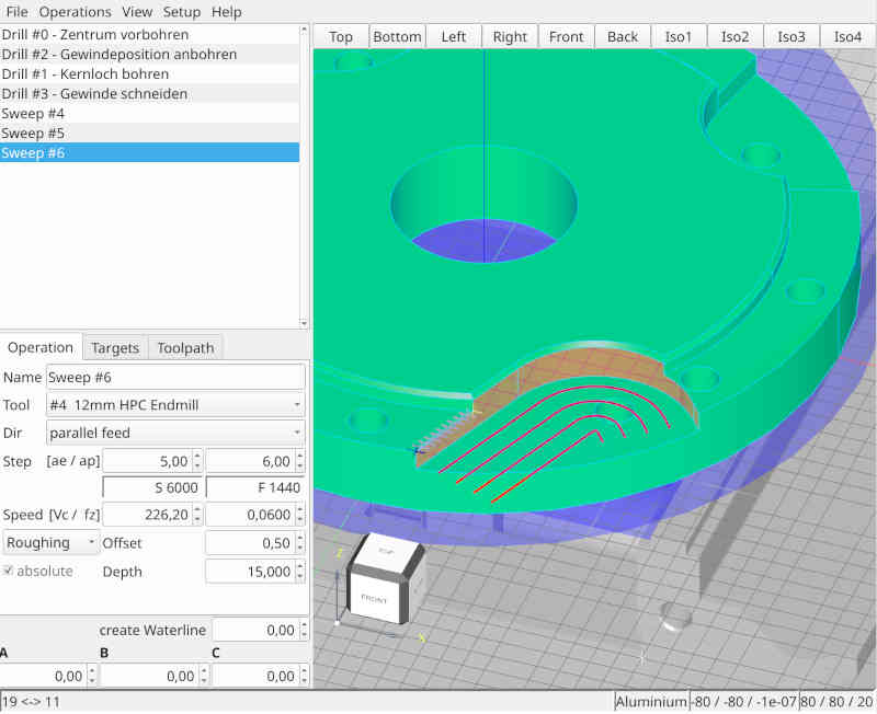

My non existant math skills is a problem for CavalierContours as well. I thought, I could get it, but opposite is true.
So I tried to achieve same thing like polylines from CavalieContours by using opencascade:
The trivial parts already work fine:
... but on creating toolpath based on user selection I'm stuck:
Do you know, how to extend the red wires on each end?
> One thing to try out is open the opencascade library as qt project. This give's you more power over the lib.
I already did that. I compiled the whole toolkit with debug information. But it does not change anything - opencascade is huge and documentation is for math specialists, not for hobby users.
I don't have the math skills to understand docs or big parts from source code.
What I achieved is a result of tedious trial and error.
> If you have any questions just ask.

Hi Reinhard,
Not all opencascade math is usefull.
For example doing a 3d line - 3d arc intersection. I made a c++ header to find intersection points :
github.com/grotius-cnc/3d_intersection
For extending 3d lines or 3d arc's we can use math.
1. I could write a c++ header only function for extending a line or arc. This then could be used in a simple way.
Considering:
2. Another way is to write a header only interface that uses the Cavaliercontour operations for Occt.
I think using Cavaliercontours with Occt interface is a powerfull 2d offset solution. Wich can be used in a 3d plane.
Then your last picture example (where lines would be extended) would result in a pocket offset operation.
Considering:

This is a header file i just made for 3d line extend. Let me know if you can use this type of implementation?

For the arc extension, would you like to input extension value in degrees or in mm?
- Grotius
- Posts: 2419
- Thank you received: 2349
30 Mar 2022 21:33 - 30 Mar 2022 21:45 #238833
by Grotius
Replied by Grotius on topic simple linux cam
Just made a header function to extend a arc in 3d.
Input is degrees to add for start or end point.Let me know if this is usable for you.
And the archive with complete code for above examples :
github.com/grotius-cnc/occt-samples-qope.../OcctQtGuiApp.tar.gz
Then to extend a wire. Use the "wire add" function. And add the exension.
BRepBuilderAPI_MakeWire wire;
TopoDS_Edge edge = BRepBuilderAPI_MakeEdge(Line or Arc);
wire.Add(edge);
return new AIS_Shape(wire);
wire.Add(edge);

Hi grotius,
thank you for your attention and support!
Great! Didn't thought of the most obvious solution. Thank you for the kick.
Using own math objects might be a good solution too. Maybe better than fiddling with opencascade objects.
I already tried similar by using CavalierContours. If you follow the link from CavalieContours from my last post, you'll see, where I got stuck with cc.
A big problem (for me) of opencascade is that so many methods (+ classes) don't do, what the name makes you expect.
Just selecting the same faces than with picture from last post only in different order result in completely different behaviour.
Still looking for a way to make opencascade do what I want.
When I ask opencascade for intersection of two shapes I get a bunch of unordered edges (AIS_Shape), which is based on some parametric Geom-class. When I ask occ for geom-object I get it together with the limits of the parameters and using D0 with some parameter gives the vertex points of the curve.
To sort those edges for cavaliercontours polyline you maybe need to flip the direction of an edge. The geom-classes have some Revert/Reverted methods, so I thought reverting a line that goes from A to B would lead to a line from B to A, but that's not true.
So - may be I should go for my own math objects and use occ for display only ...
