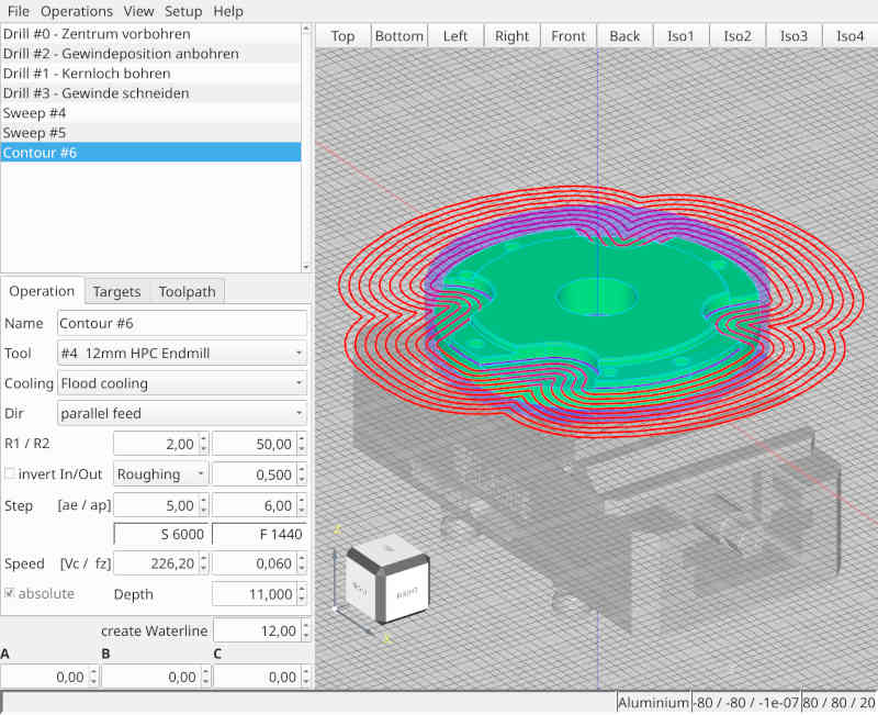

Hi Grotius,
> I followed your CavalierContour link. And the solution is to use "cavalier's pocket operation" instead of " cavalier's offset
> operation".
Sorry, but you did not get the point. I did not use pocket operation by intention. That's not what I want!
I want the outline offset contour cut by the workpiece shape (cylinder or box), so result should be open polylines (which I want to connect at my will)
All CavalierContour curves are concentric curves - and that is pretty useless for milling.
Anyway - I'm working to get desired result by using opencascade stuff. Hardcore coding
This concentric curves are created with opencascade only. Now I need to cut out the unwanted parts ...

For my understanding, if you look at the first contour offset path in red, you need the intersection points with the
raw material (purple shape) and then do a trim. (trim away the red contour outside the raw material)?

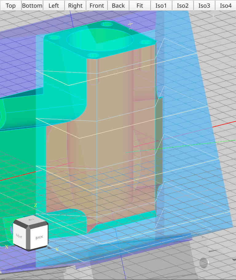

Here I cut the rotated blue box by planes containing the selected faces - and result looks as expected (well I joined 3 cut parts into one cyan part)

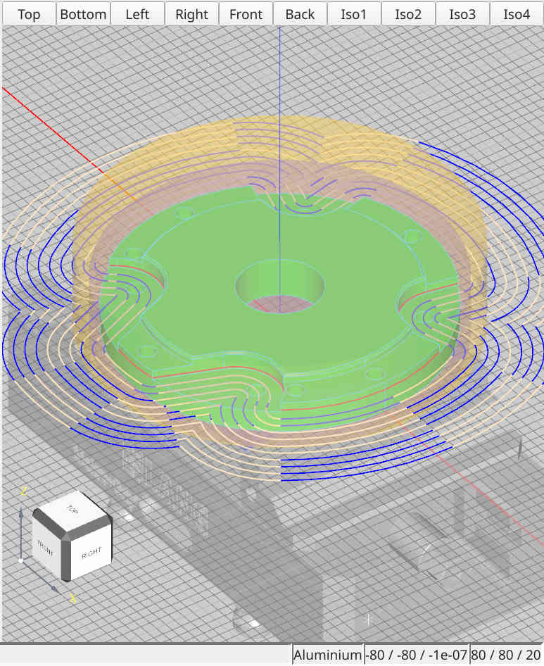

Trying similar with the offset curves gives this ridiculous result:
I cut each offset curve by the golden cylinder, which is a bit bigger than the blue one.
According to opencascade docs the splitter splits the objects and result contains both parts.
I display result with alternating colors (yellow and blue) to see, which is inside of cutpoint and what is outside.
From what I see on screen, I can't recognize any cutpoint at all.
Sadly I don't know how to cut CavalierContour curves

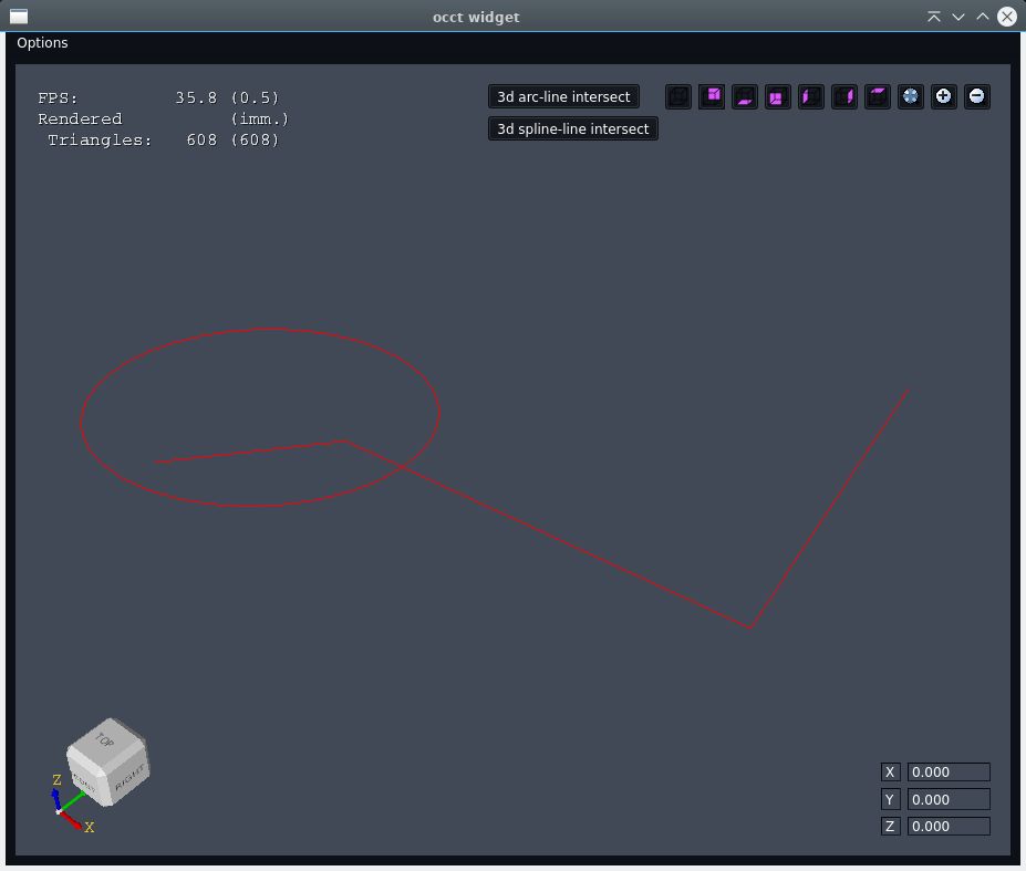

Lets focus on the last picture. I got a idea for you.
Let's consider the contour offset, produced by the Cavaliercontours library.
To check if the offset is inside the raw material shape, you can check this with the "point in polygon" function.
For this function, you can iterate trough the offset result, no order is required.
See the polygon as the raw material shape (segmented contour, for example a circle with 50 side's).
1. You pass every line or arc points into the "point in polygon" function.
2. If points are outside the "point in polygon", you know this line or arc has to be trimmed at shape intersection.
For now you can try to colorize line's or arc's inside the shape, intersecting at the shape or fully outside the shape.
Next step is to calculate the intersection, we do this in next forum post when you are ready.
I will post the "point in polygon" function as header only file within one hour.
3. To refine item 2.
A. If firstpoint & secondpoint is inside the polygon. Keep it as it is.
B. If firstpoint is in the polygon and second point is outside the polygon or visa versa,
we are intersecting the raw material shape. Later on we will do the trim for this.
C. If firstpoint & secondpoint is outside the polygon, delete this line or arc from the produced contour.

Hi Reinhard,
Attached a PointInPolygon header file. This can be used to determine wich primitives (arc's, lines) are inside the
raw material shape, or completely outside the raw material shape.
If one point of primitive is inside and one point of primitive is outside, you have intersection with raw material.

I have made a little example for you how it works.
We draw a circle, this is raw material shape.
We draw 3 lines. One line is inside the circle, one line intersects and one line is fully outside the circle.
The implementation below, calculates the status for each line.
Implementation :
Mainwindow line 241
Used functions :
functions
Implementation :
Mainwindow line 241
Used functions :
functions

Walk trough this code :
Program output
Item 1 startpoint: InPolygon: 1
Item 1 endpoint: InPolygon: 1
Item 2 startpoint: InPolygon: 1
Item 2 endpoint: InPolygon: 0
Item 3 startpoint: InPolygon: 0
Item 3 endpoint: InPolygon: 0
//! 0. Draw the raw material.
Handle(AIS_Shape) myShape=CirlceShape({50,50,0},{0,50,0}).ShapeTopPlane();
occt_viewer->show_shape(myShape);
//! 1. Draw a contour offset line.
myShape=LineShape({50,10,0},{80,50,0}).Shape();
//! 2. Draw a contour offset line.
myShape=LineShape({80,50,0},{200,50,0}).Shape();
//! 3. Draw a contour offset line.
myShape=LineShape({200,50,0},{200,200,0}).Shape();
//! Check if 1 is inside the circle, checking startpoint.
int InPolygon=0;
PointInPolygon({50,10,0}).TubeShape({50,50,0},50,InPolygon);
std::cout<<"Item 1 startpoint: InPolygon: "<<InPolygon<<std::endl;
//! Check if 1 is inside the circle, checking endpoint.
InPolygon=0;
PointInPolygon({80,50,0}).TubeShape({50,50,0},50,InPolygon);
std::cout<<"Item 1 endpoint: InPolygon: "<<InPolygon<<std::endl;
//! Check if 2 is inside the circle, checking startpoint.
InPolygon=0;
std::cout<<"Item 2 startpoint: InPolygon: "<<InPolygon<<std::endl;
//! Check if 2 is inside the circle, checking endpoint.
InPolygon=0;
PointInPolygon({200,50,0}).TubeShape({50,50,0},50,InPolygon);
std::cout<<"Item 2 endpoint: InPolygon: "<<InPolygon<<std::endl;
//! Check if 3 is inside the circle, checking startpoint.
InPolygon=0;
std::cout<<"Item 3 startpoint: InPolygon: "<<InPolygon<<std::endl;
//! Check if 3 is inside the circle, checking endpoint.
InPolygon=0;
PointInPolygon({200,200,0}).TubeShape({50,50,0},50,InPolygon);
std::cout<<"Item 3 endpoint: InPolygon: "<<InPolygon<<std::endl;Program output
Last edit: 01 Apr 2022 13:18 by Grotius.
