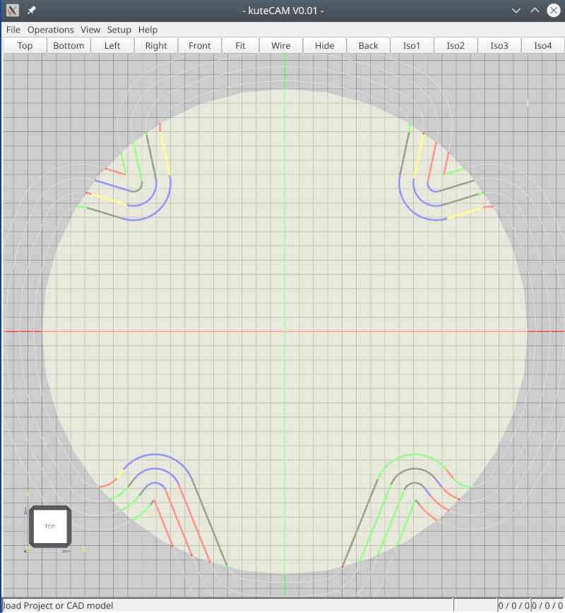

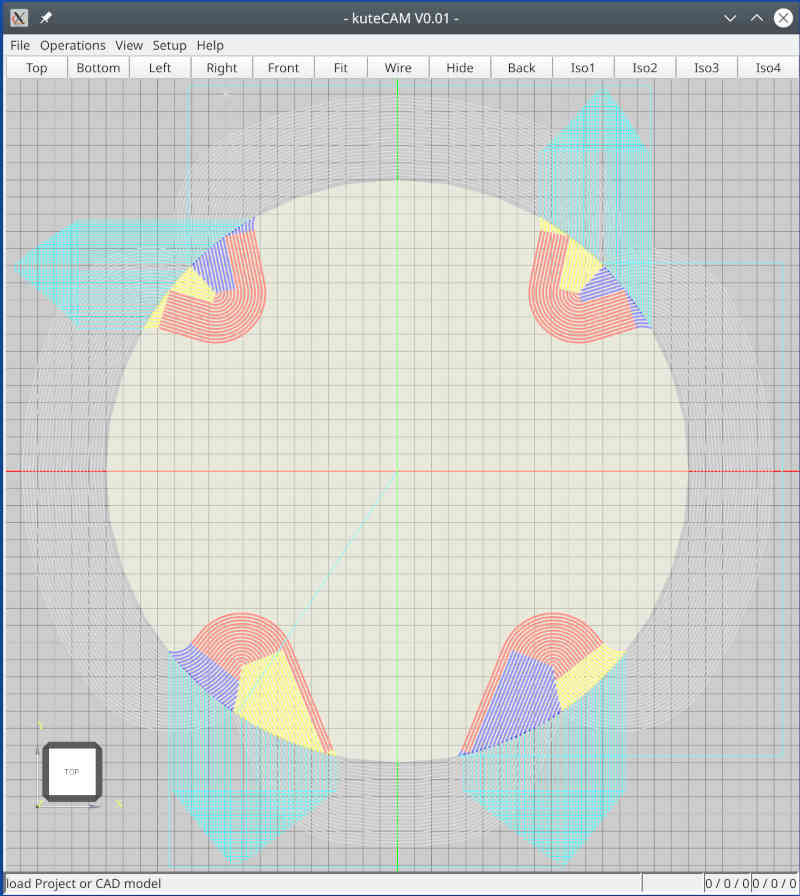

the next hurdle has been taken. I wanted to mill the open pockets.
The least effort for the user seemed to me to cut the model horizontally and derive the contour from that.
However, the parallel contours were not suitable as a tool path.
So - roll up my sleeves and spit into my hands ...
Although opencascade provides the tools to edit a curve, it was not possible for me to get the desired result. So I had to cut the curves myself. In doing so, I had to realize that opencascade creates completely chaotic curves. Different directions and completely different start and end point ...
(green is the first segment, red the last - contour with two green segment means first and last segment of the curve)
So I had to create my own data structure to get reliable results. This was a challenge for my gray cells, but I think I finally skinned the cat. (The steps in the rapid [cyan] are only for debugging)
