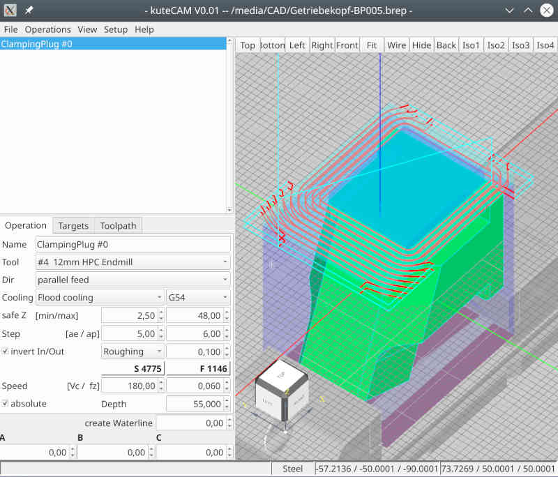

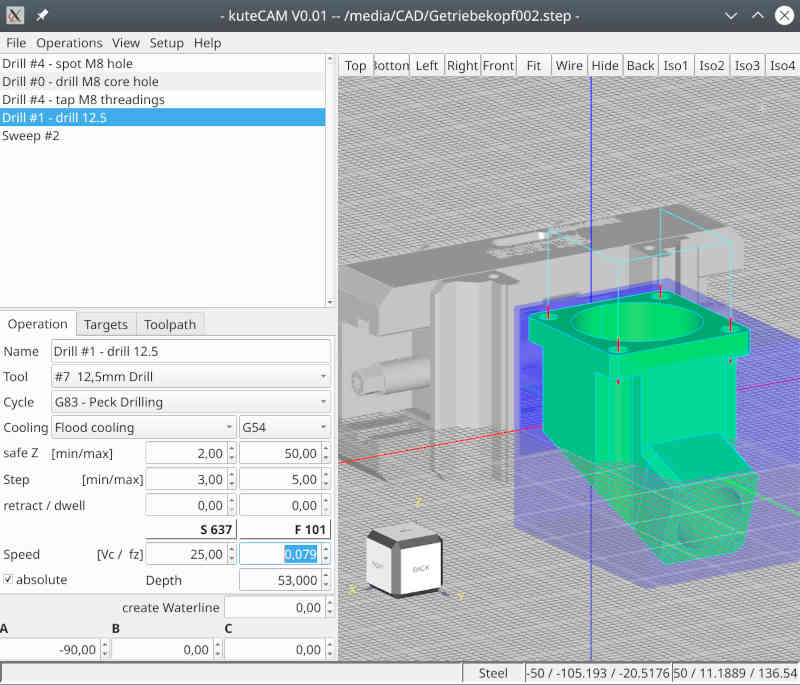

a small update.
For 5-axis operations like this you'll need a clamping plug.
With the update, you can define the clamping plug on top and create milling paths for it:
To try the generated paths only little change is required. The generated gcode starts like this:
The line "M98 P100" is a subroutine call for tool change. Replace that line with "M6" and have fun
a small update.
( Job /media/Scratch/CP013.ngc );
( generated by kuteCAM V0.01 );
G40 G80;
T4;
M98 P100;
( ClampingPlug #0 );
( T4 12mm HPC Endmill - D:12 L:50 );
N10 G0 G90 G54 X-70.600 Y33.640 S4775 M3 T4;
G43 H4 Z61.000 M8;The line "M98 P100" is a subroutine call for tool change. Replace that line with "M6" and have fun

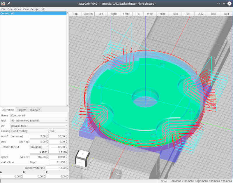

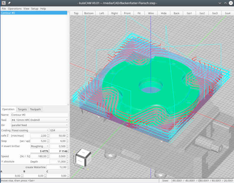

Thank you for your attention and your flowers
Keep in mind, that I'm at the very beginning of a huge project ...
I plan the application in such a way that the user selects some elements from the model and I, or rather kuteCAM, then knows what to do.
In no case I plan to reinvent a CAD.
Even though I am at the very beginning, I'm already very satisfied with my progress (I have very little sparetime) and so far I have been able to implement everything as planned. Therefore, I am confident and continue to follow my plans.
"Stay down" is an (important) option for finishing. So far, I am dealing exclusively with roughing and stay down is not important for roughing. My test models are intentionally complex enough to keep me busy with challenges in the long run.
Currently, I am still working on implementing general purpose processing. So far from any optimization. To visualize the way my processing works, take this picture:
The dark blue lines are the "real workpath" where the tool should cut material. The red lines are "lead-in" and "lead-out" to ensure, that the tool is completely outside of the model. I extended the red lines for debugging purpose (just to be able to visualize the order of movements).
I cut the virtual working area into smaller areas and as long as the tool stays in one area, the tool will stay down.
For area changes, I move up to save retraction layer. That's a place for later optimization, but actually I don't waste a thought on it.
Looking back, I have to confess, that I lost most dev-time in debugging and understanding randomly/unpredictably results from occ and creating a reliable layer between occ and my app. Apparently occ has no interest supporting hobby users, so I have to fight my battle alone (not my preferred way of working)
So I'm not sure how much effort I'll still putting into occ. I have the impression by using occ it always goes one step forward and yet two steps back - or to put it another way: occ is the most expensive foreign library I have ever looked into. Even though I think I've understood quite a bit, I'm sure I've only lightly scratched the surface.
... so I have no idea where the journey will take me.

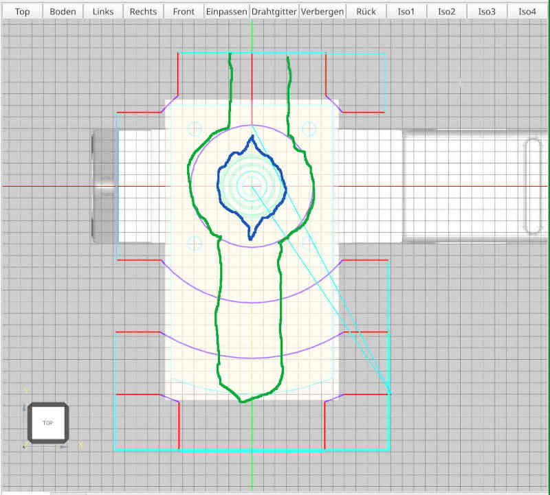

Hi silopolis,
I took a closer look at cylinder job and how to optimize it. Regarding "stay low" - all movements for one z-height are already performed as "stay low", which means, changing Z happens only, when a new Z-height will be milled.
An alternate (shorter?) path might look like this (the green line) - from top view:
but I fear, that with this path, the cylinder is not round but something like the blue line. So I need a full turn around the cylinder anyway. Drawback of the green path - it works only as long as the workpiece is smaller that double the diameter of the tool.
My actual variant works for any shape and any dimension of the face below the cylinder.
So I think, a really shorter workpath could be created, if you don't care for cutting direction (alternating parallel feed and against feed).
What do you think?
