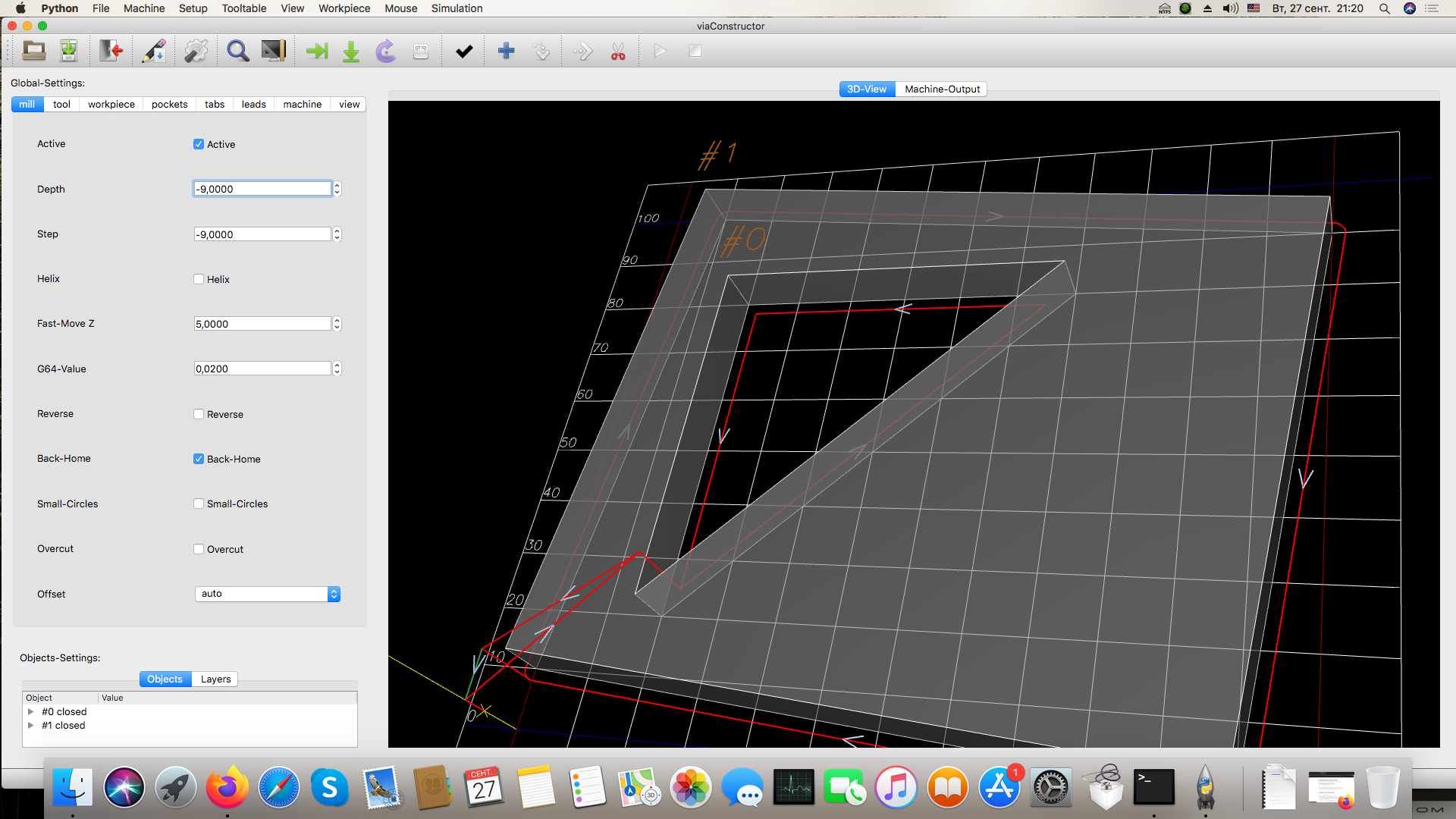

Works on macOS High Sierra. Installed according to the instructions.
