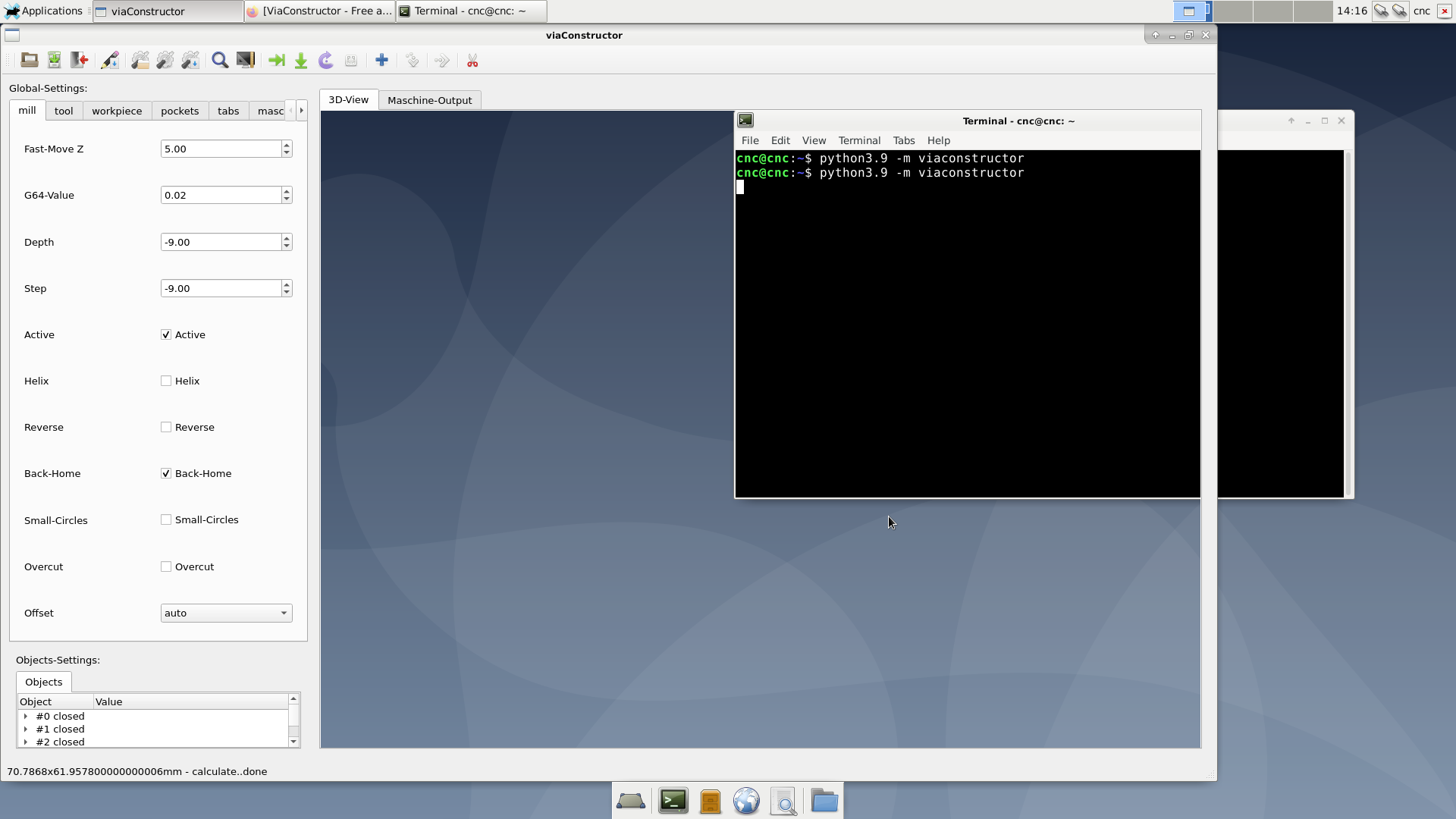

- Dragonick
- Posts: 48
28 Feb 2023 19:29 #265601
by Dragonick
Replied by Dragonick on topic ViaConstructor - Free and Opensource CAM for Linux and Mac

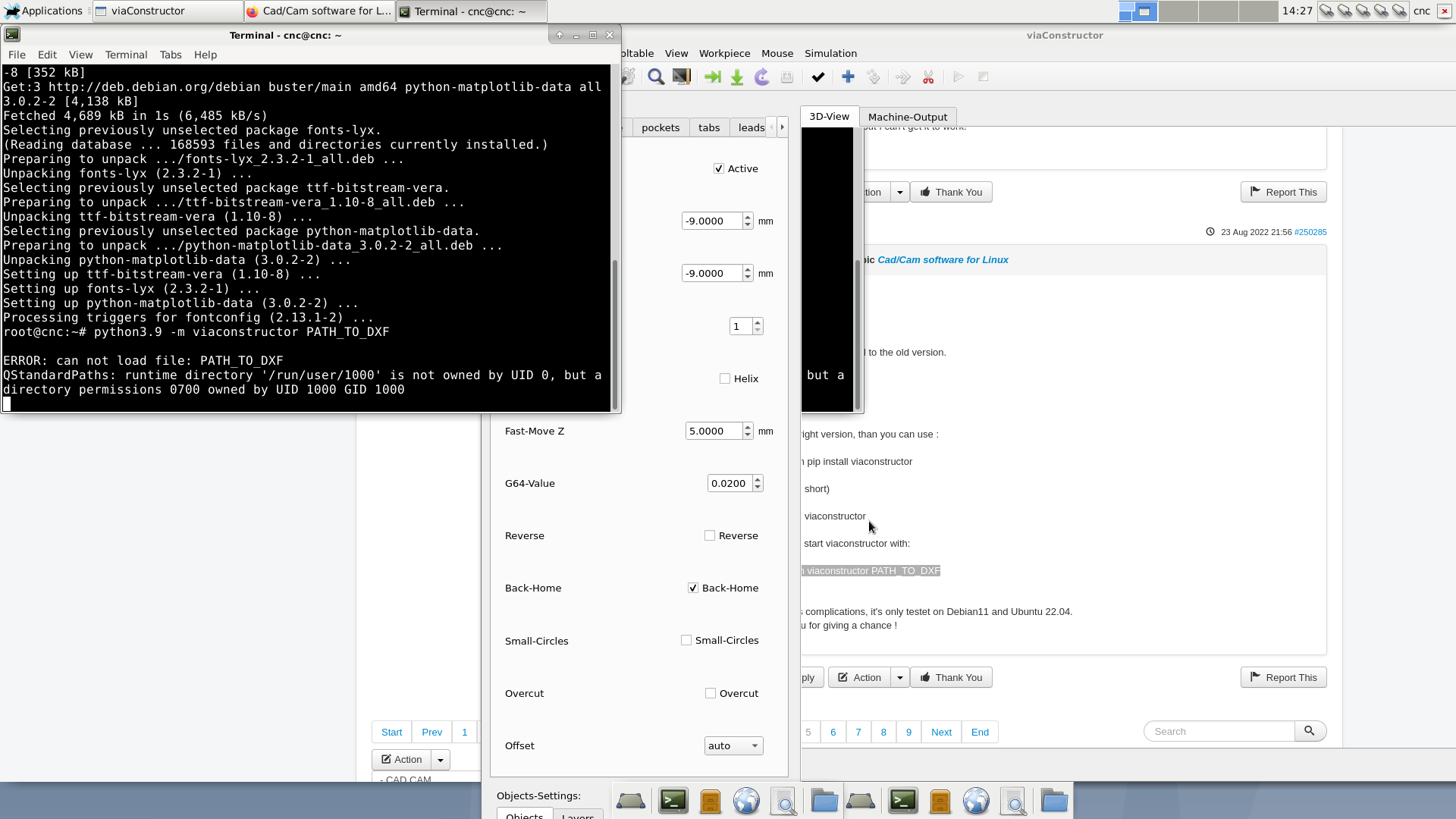

01 Mar 2023 08:26 #265639
by meister
Replied by meister on topic ViaConstructor - Free and Opensource CAM for Linux and Mac
please replace 'PATH_TO_DXF' with the real path to your .dxf file you want to open.
- Dragonick
- Posts: 48
01 Mar 2023 19:18 #265668
by Dragonick

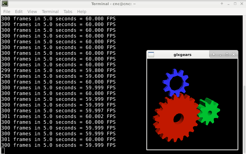

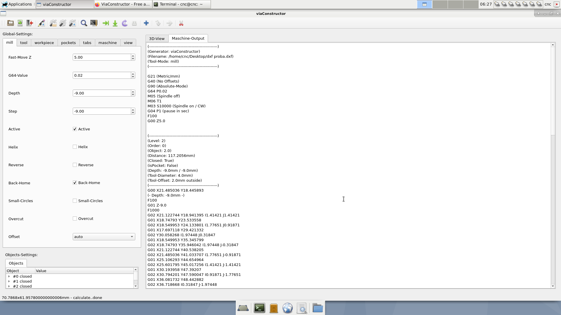

Ahh, ok, do you can see gcode in the 'Maschine-Output' Tab ?
I think your 3D driver is broken, can you run 'glxgears' ?
- Dragonick
- Posts: 48
02 Mar 2023 11:30 #265710
by Dragonick
