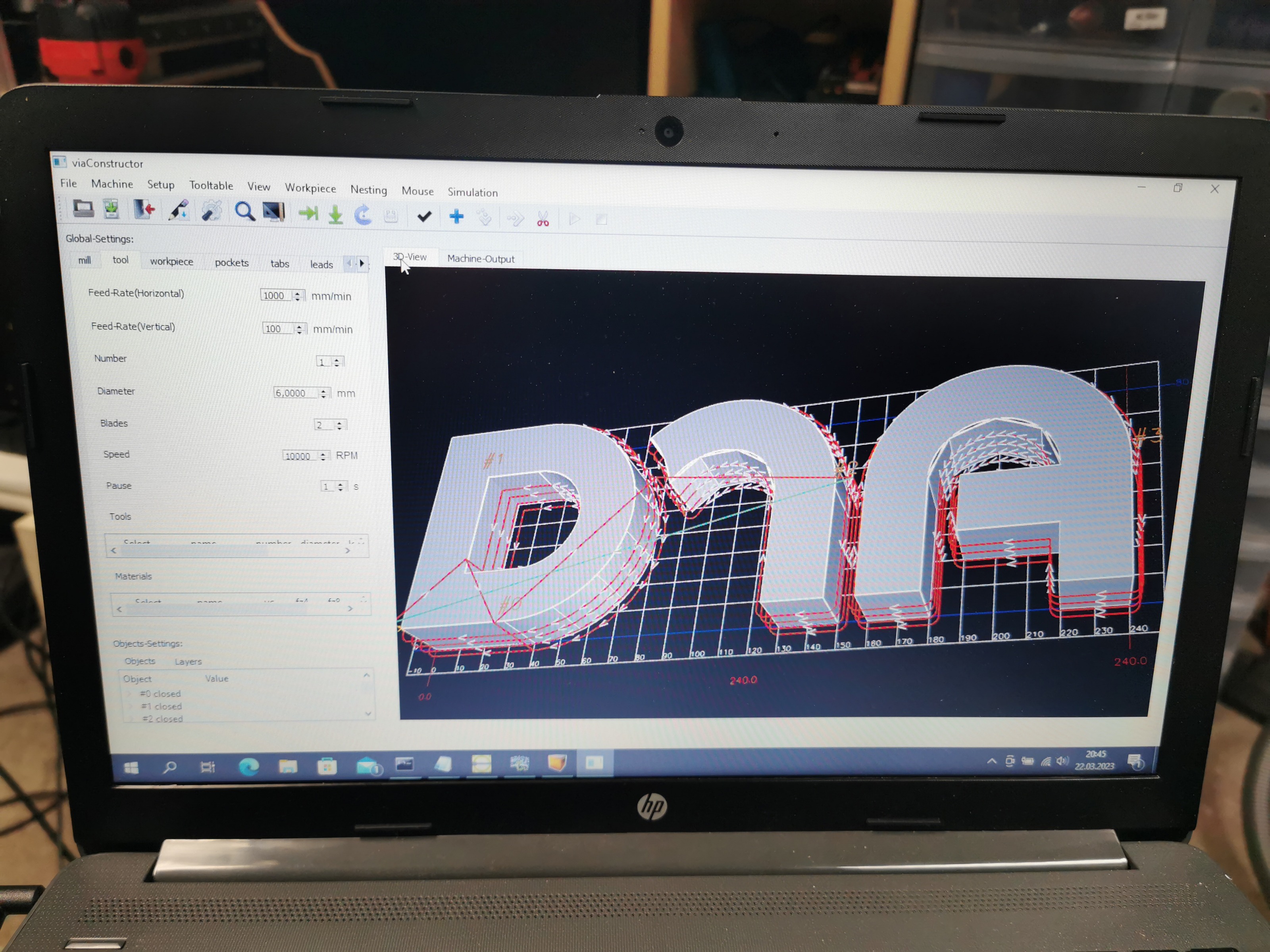

23 Mar 2023 10:01 - 23 Mar 2023 10:02 #267349
by meister
Replied by meister on topic ViaConstructor - Free and Opensource CAM for Linux and Mac
I have managed to get viaconstructor running under windows.
but it is still some work,
no installer or anything
install python3.10.10 from: www.python.org/ftp/python/3.10.10/python-3.10.10-amd64.exe
install git from: github.com/git-for-windows/git/releases/...it-2.40.0-64-bit.exe
at the moment, you need also Visual Studio Community 2022 from: visualstudio.microsoft.com/vs/community/ (to install pyclipper / some dll's needed for CavalierContours)
git clone https://github.com/multigcs/viaconstructor.git
python3.exe -m pip install -r requirements-install.in
python3.exe -m viaconstructor tests/data/simple.dxf

14 Sep 2024 14:07 #310144
by Creative25
Replied by Creative25 on topic ViaConstructor - Free and Opensource CAM for Linux and Mac
I have installed it in a MacBook Pro 2012 on LinuxCNC.
I like how easy it is to use the software. Still learning!
I found it to be a bit slow if I want to change some parameters like feed rates etc. It almost freezes.
Choosing starting positions works without any delay.
If I try to open the gear tool the program shuts down.
Are there some parameters I could add to the startup of the binaries in order to get it to run faster?
