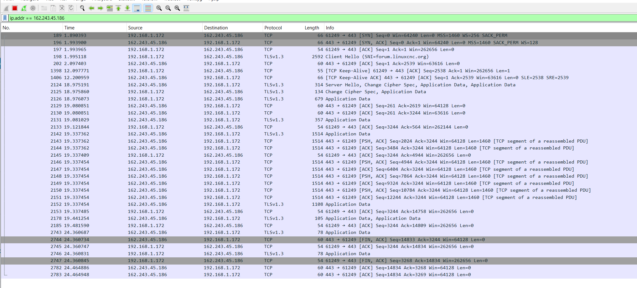

It looks like a TLS handshake issue. As I mentioned earlier when comparing times to download the logo with and without http/https:
Here is a screendump of wireshark. The delay happens after the client (my Firefox) sends TLS Client hello. It takes sometimes a long time to get back a Server TLS hello up to a very very long time and even timeout. Right there. This time it took 17 seconds.
So the client has long ago gotten an IP address, any DNS queries was a long time ago. It's not DNS.
Even if I use the IP-address itself I get the same response. Later on firefox start to complain about certificate, but that's another story.
The network traffic and network delays are exactly the same with and without FQDN. So it's not DNS.
It must be that the traffic goes via cloudflare to the webserver instead of directly to the forum web server.

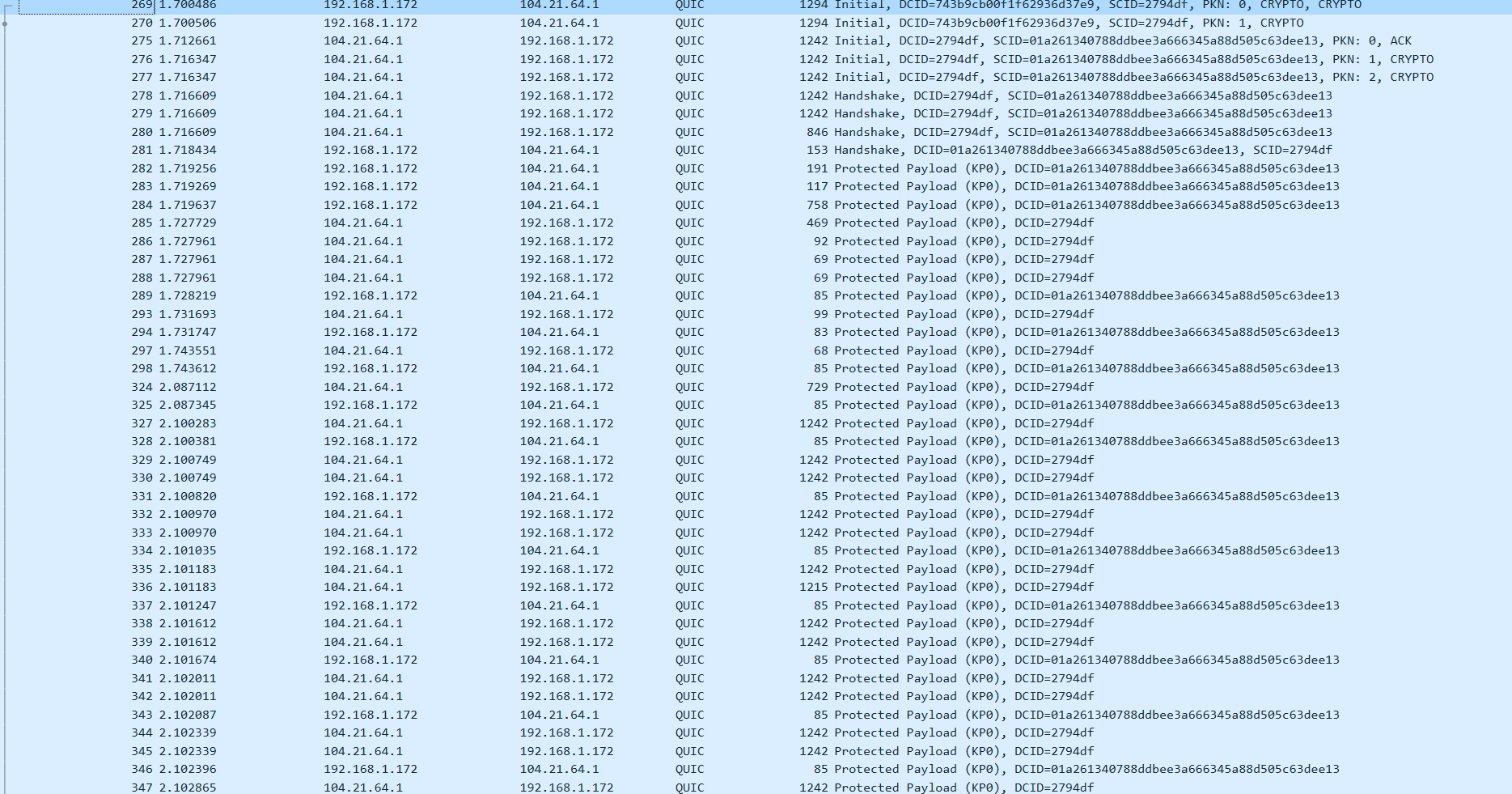

That was a surprise and rendered a bit of googling. QUIC protocol instead of TCP.
Of course, with so different network transport, no wonder one is faster than the other.
But why is the original TCP traffic so slow. Especially the TLS handshake?

I googled slow TLS handshake and slow TLS Server hello and we are not the first. There are obviously many possible reasons.
- Too low (or rather the wrong) MTU setting on server
- Too low MaxUsers in Apache config
- Wrong certificate chain on server, especially includes a root certificate which should be removed.
- Running out of entropy on server
Since QUIC or rather HTTP/3 seems to work well, can the forum web site be configured for HTTP/3?
There may be more reasons. It could be interesting to do a packet dump on the server and compare.
Maybe the server finds it takes a long time to get the TLS Client hello packet?
