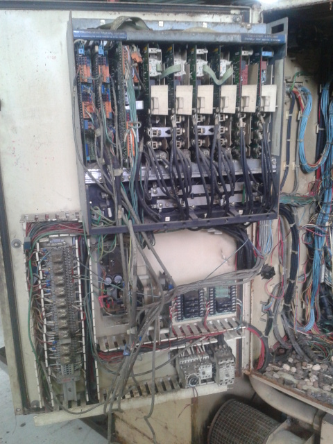

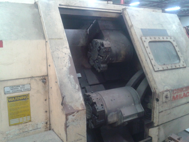

sorry if I, make stupid questions, but it's my first experience with linuxcnc.
I have a lathe cinccinati having 2 turrets, So you have 4 axes.
the machine only serves the mechanics, since the electronic part is useless. this machine to me give my boss.
I think that even you can do something with it. I adapt it linuxcnc. but really do not know where to start. and I have the software.

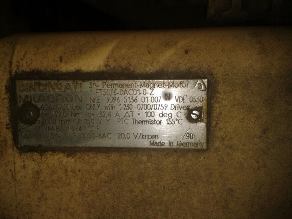

The question I have is in the selection of hardware, this machine was equipped with Siemens AC servomotor 23Nm.
please, interface, and servo motor and servo drive, I recommend for this machine?

I guess the first question would be: Are the servomotors and drives OK?

Those look like AC servos with ac tachometers, so may be hard to find matching drives. Are the existing drives known to be bad or are they just missing?

engineer,
the idea is to change the whole system.
linuxcnc use, servomotor new or used but in good condition. with its own servodrive.
the big question I have is to select the best option and is compatible with linuxcnc. I have been speaking board 5I25 7I37 MESA, but unfortunately I have not found information on these board.
in conclusion do not know which servo motor, servo drive and interface used. linuxcnc compatible with, that are good for the machine, and which are not so expensive.
please help me select the best option.
no matter that only use a turret, I'm content with that.
very much thanks for you colaboration

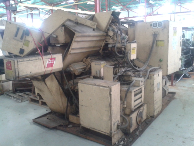

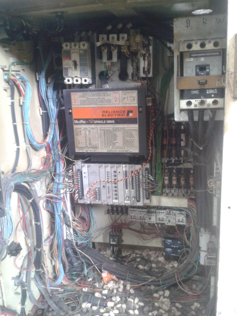

te cuento que los servodrive no sirven para nada, los servomotores han soportado mucha agua. esta maquina ha estado a sol y agua por 3 aƱos.
Mi jefe me la regalo. 800 dolares.!!!
se que no es facil hacer un retrofit pero lo quiero hacer por aprendizaje y obvio para ver si la puedo poner a trabajar.
mira solo cuento con la parte mecanica. estoy dispuesto a cambiar servomotor y servodrive.
pero el problema es que no tengo idea de cual es mejor y cual se adapta mejor a linuxcnc. la maquina trae motores de ac servomotor 23Nm, pero se que un servo de esas especificaciones debe ser costoso. no importa si pierdo rapidez o torque. me interesa ponerla a trabajar y hacer el desarrollo. la maquina tiene dos torretas osea 4 ejes no importa si solo pongo a trabajar 1 torreta osea 2 ejes... ya eso seria ganancia.
