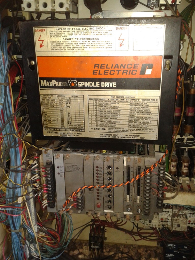

16 Aug 2012 09:31 #23292
by jlviloria
Replied by jlviloria on topic Re:orientation linuxcnc
Hello,
Rob, first thanks for taking my call. the same for Frank.
The servomotor work, but no drives.
you know of any drives that work with this type of servo motor.
Panasonic Frank recommended me, but in a video I saw on your youtube channel, I saw you mention ESTUN servo motor, think you can adapt these servomotors to my machine?
The spindle drive motor and if they work, it's 50HP is DC 180Amp is Reliance brand.
The turret I have not even looked at. but I think with hydraulic system, power tooling does not have.
this weekend I look at the turret.
thanks
any suggestion is valuable.
thanks

- Posts: 19914
- Thank you received: 4663
17 Aug 2012 04:41 #23330
Replied by andypugh on topic Re:orientation linuxcnc
jlviloria wrote:
Yikes! That's a serious amount of power/current.
There is a suitable drive on eBay, but no guarantee that it works:
www.ebay.com/itm/General-Electric-50-HP-...40-VDC-/140609207849
The spindle drive motor and if they work, it's 50HP is DC 180Amp is Reliance brand..
