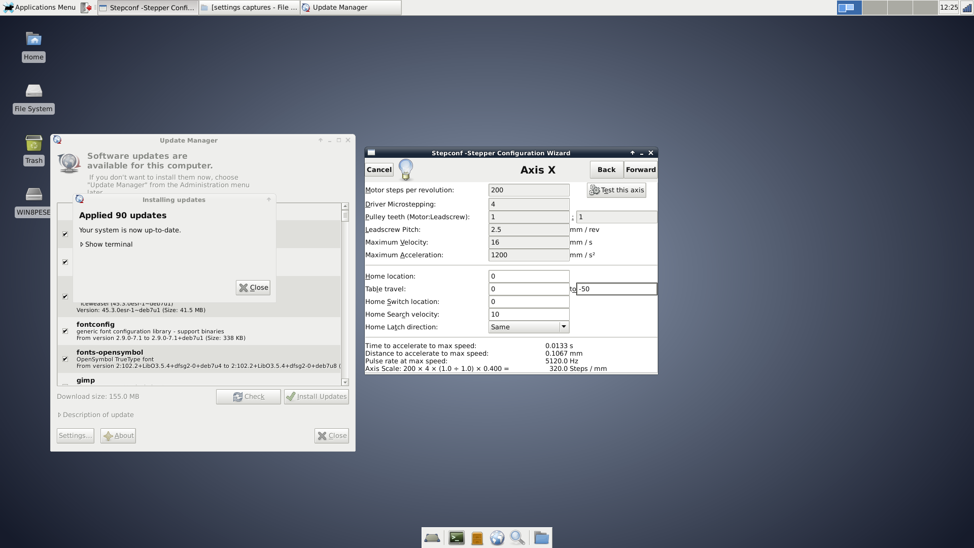

On Linuxcnc interface, there is only "Home All" button, that means I cannot home one axis at a time? I know I can do that with MDI but still I would like a handy button on the interface. Or is it because my both my homes are linked to one pin?
I explain, I am using two limit switches normally closed on both axis and tie them together gives me one pin option. I have configured "Home all" in stepconf to the relevant pin but it is only homing Z axis and then it would stop, no homing for x axis. My understanding is, when Linuxcnc tries to home axis, when the connection which is NC is broken at Z homing axis, it thinks X is homed too because X axis home switch is on the same line. I hope you get my point. Basically, it is all one loop NC. Pin 13 on my BOB goes through two limit switches and finally end up with ground. So any of the switches (Z or X) can break the connection of this NC loop. My setting are as follows which I configured in stepconf
Pin 13 = Home All
Z AXIS
Home location = 0
Table travel = 0 to 200
Home switch location = 0
X AXIS
Home location = 0
Table travel = 0 to -50
My X axis limit switch is at the far end like towards the operator and away from chuck. My Z axis limit switch is near the chuck, I mean at the chuck end. I hope it all made sense, if anything unclear, please let me know, I can always post more info.

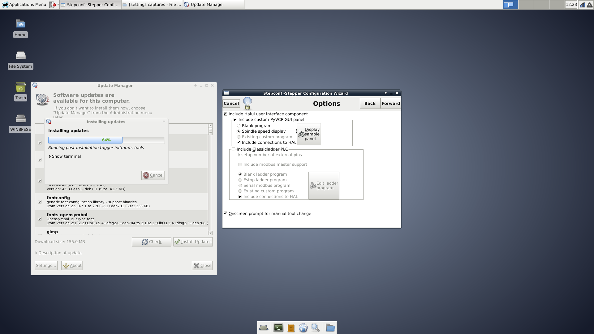

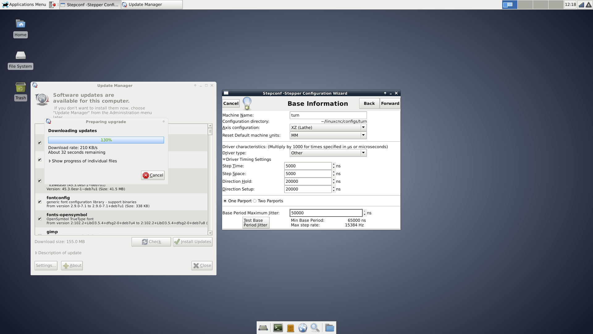

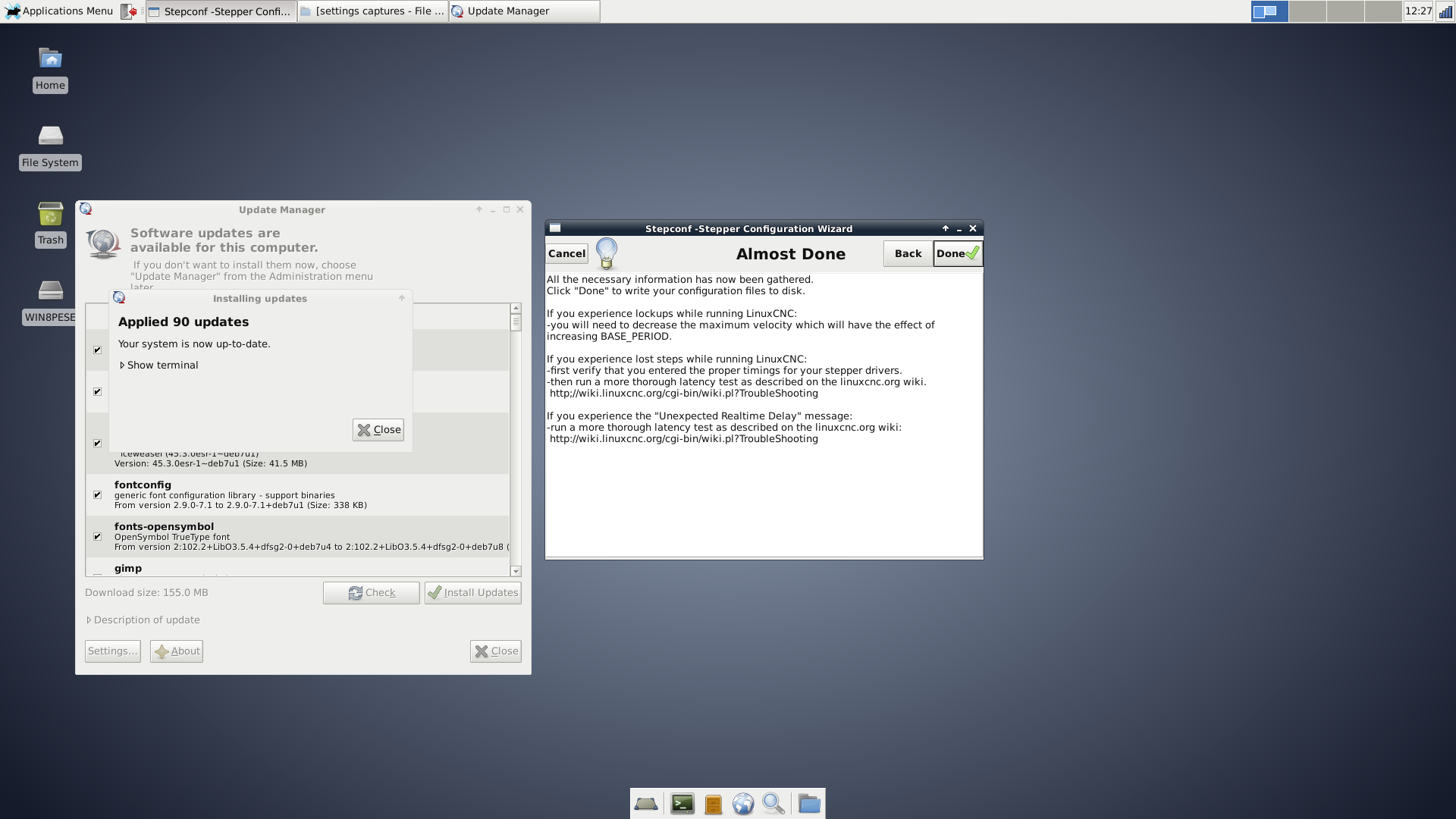

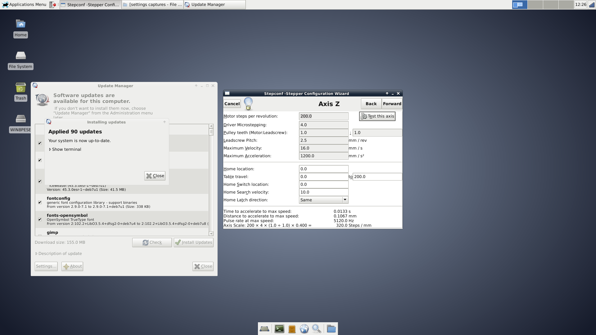

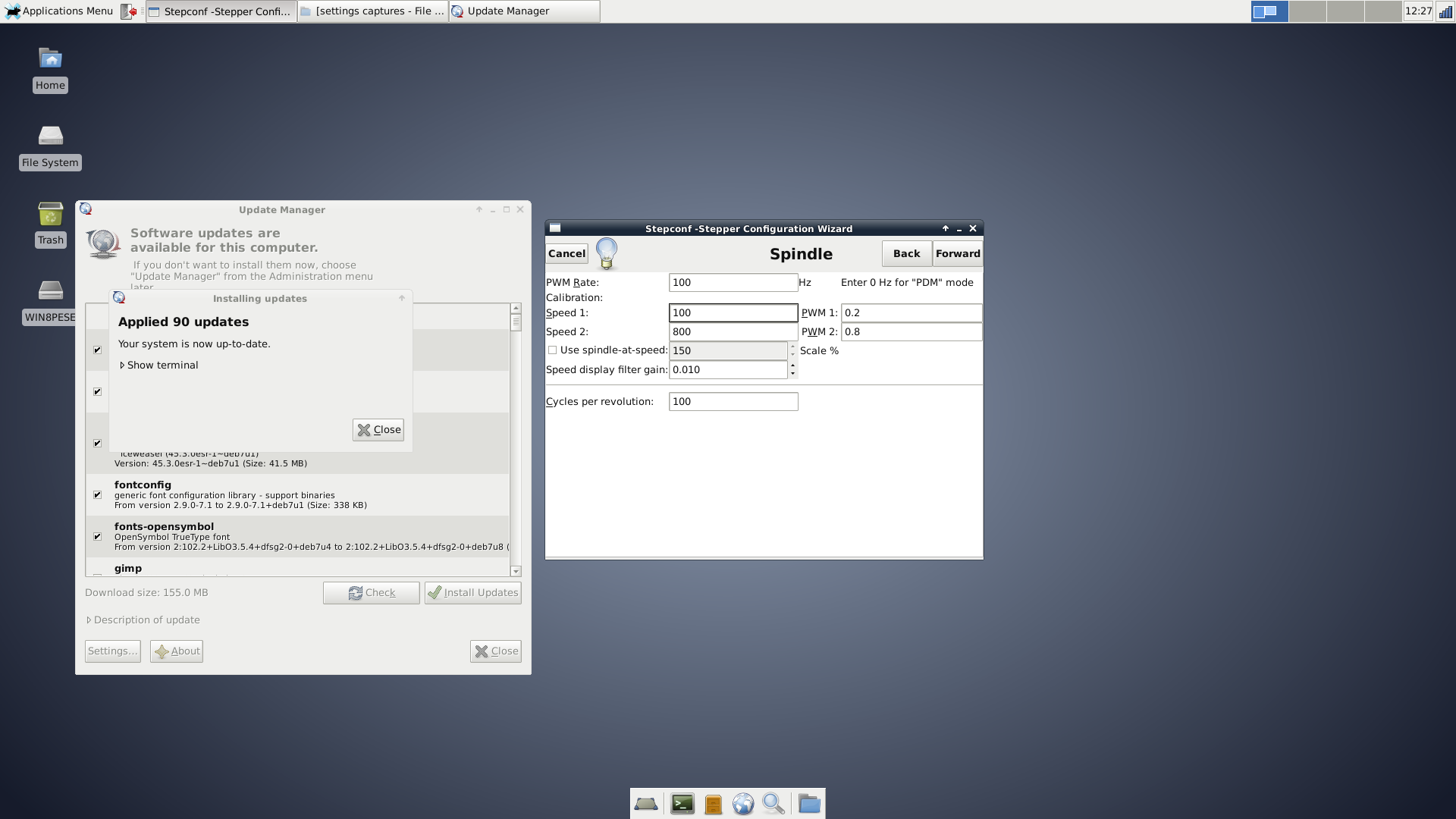

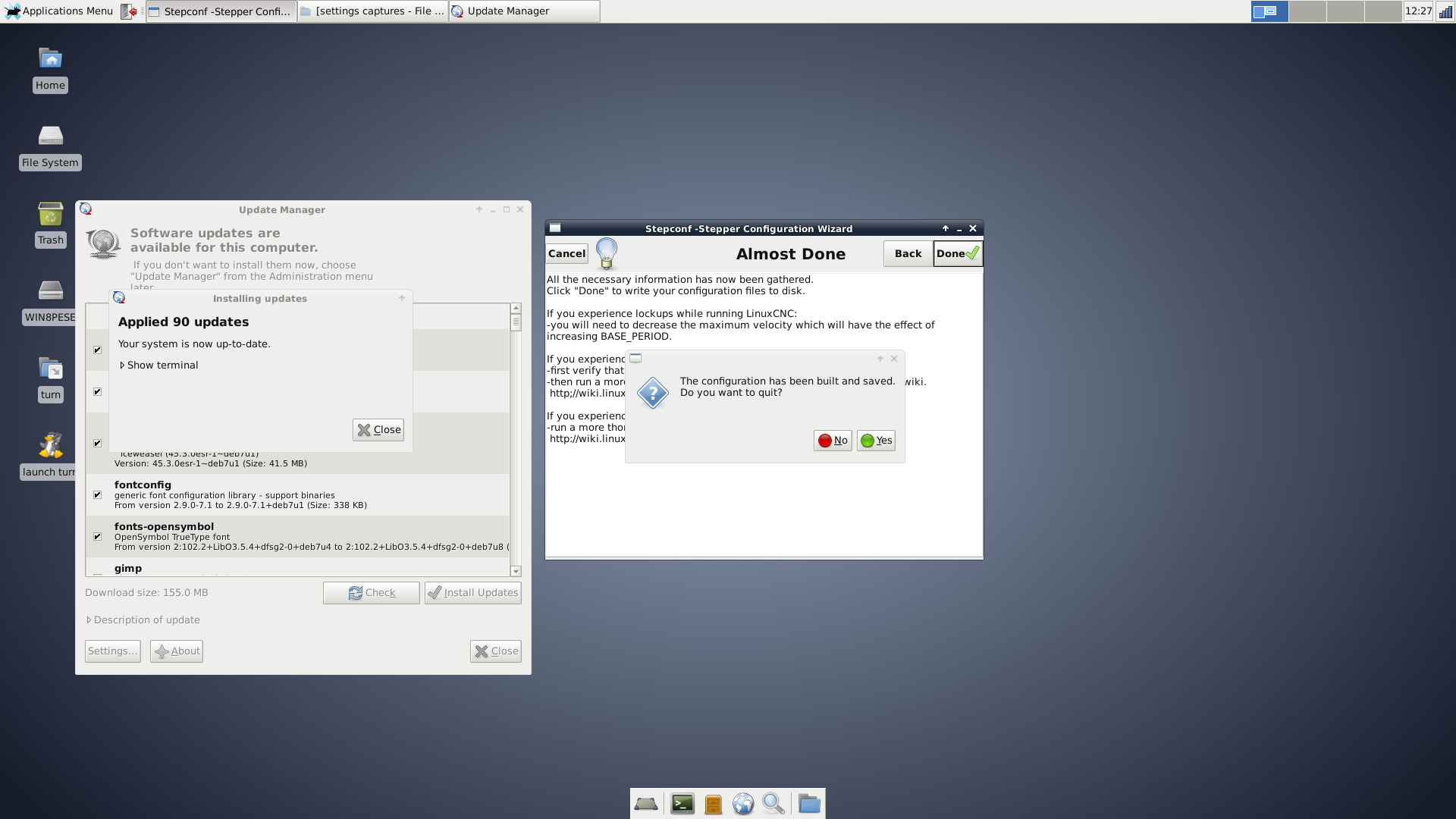

- sxyuklad
- Posts: 85
12 Aug 2016 11:47 #78664
by sxyuklad
Replied by sxyuklad on topic Urgent help required with EMC please

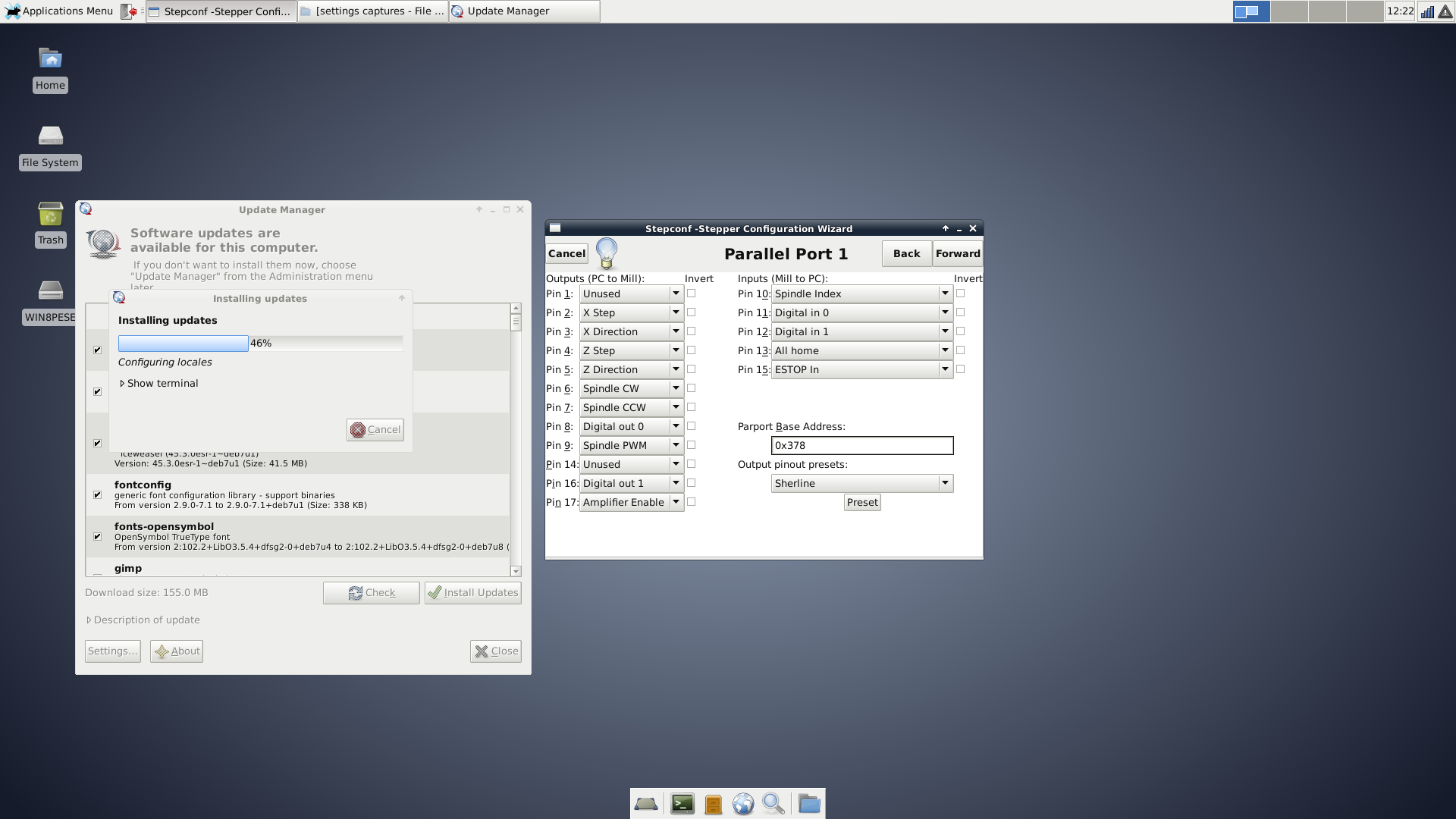

Here are the screenshots of my stepconf
I do not know how to configure spindle setup so I left it at the default settings. On Mach Turn I had the following settings as far as the pinouts go:
Parallel port:
1 - Not Used
2 - X Step
3 - X Dir
4 - Z Step
5 - Z Dir
6 - Output 1 (It turned on a relay for M03 command)
7 - Output 2 (It turned on a relay for M04 command)
8 - Output 6 (It turned on a relay for ATC to dc drive motor forward and when off, motor reverse). In linuxcnc, my understanding is I can use "digital out 1" to achieve the same.
16 - Output 5 (It turned on a relay for ATC dc motor power, when off no power to the motor). In linuxcnc, my understanding is I can use "digital out 0" to achieve the same.
9 - Spindle PWM (for controlling speed on my vfd)
10 - Spindle Index (one slot disc)
11 - Input 1 (Input 1 for ATC turret index (tool pos. 1) to scan input high or low and (to make decision and drive outputs 8 and 16 high or low for relays). In linuxcnc, my understanding is I can use "digital in 0" to achieve the same.
12 - Input 2 (Input 2 for ATC turret (mark on each tool) to scan input high or low and count for each tool (to make decision and drive outputs 8 and 16 high or low for relays). In linuxcnc, my understanding is I can use "digital in 1" to achieve the same.
13- Two home switches (X and Z as Normally Closed NC)
14 - Not Used
15 - Emergency Stop
17 - Stepper Driver enable (Both axis on the same pin)
Please compare both settings and let me know if so far I have done it correct or advise me if I need to make any change. Thank you.
Parallel port:
1 - Not Used
2 - X Step
3 - X Dir
4 - Z Step
5 - Z Dir
14 - Not Used
15 - Emergency Stop
