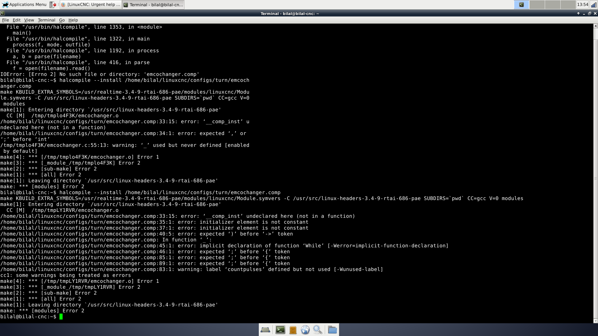

Spent hours programming the ATC again and as usual compiling errors. Can anyone please have a quick look at the comp file attached and point out where the error is? I have gone through it so many times, cannot see any. The error screenshot is also attached. I cannot understand what it is trying to say or where in the file it is pointing the errors.
One thing I am sure about is, it is the comp file, because other comps are compiling fine so it has to be something within this file.

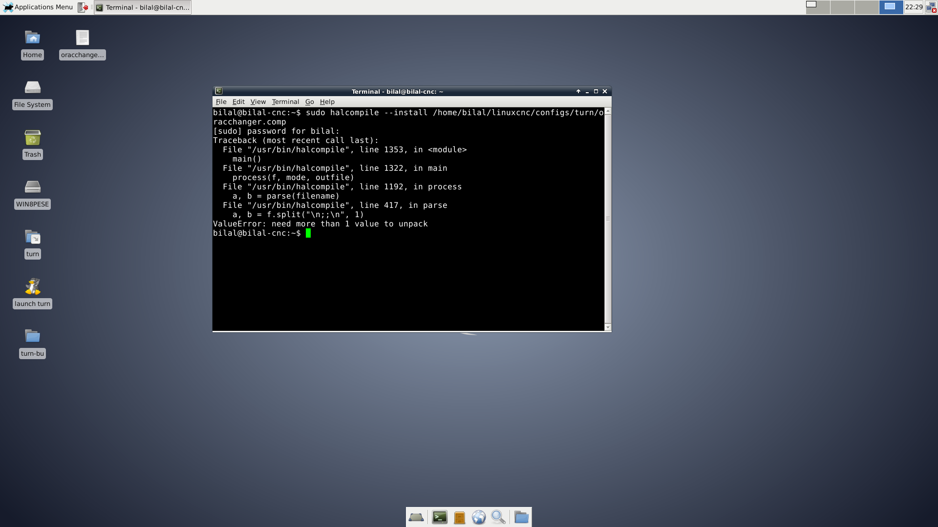

17 Aug 2016 21:46 #78961
by sxyuklad
Replied by sxyuklad on topic Urgent help required with EMC please
sorry wrong screenshot. here it is again
