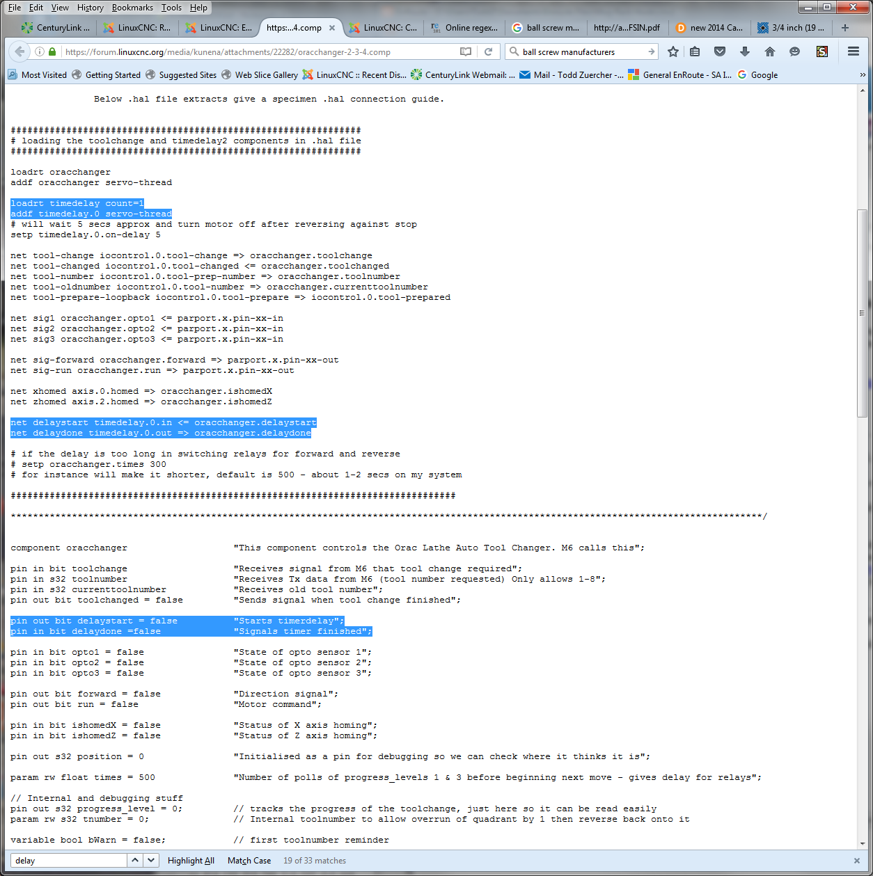

I have tried to alter the orac code to suit mine. When I compile the original orac comp, it works obviously my setup is different so it is not going to ever get the right tool.
However on the other hand, the code that I have altered compiles, works fine. It stops to the right tool what I request but I have the following issues:
1. When I issue an M6 command, it really slows down my PC almost like free and then I get latency error. Well, it stops to the correct tool but I do not know what I am missing from the original comp because it does not seem to put any load on the PC.
2. M6 command runs only one time. Like when I issue M6 command for the first time, it stops at the correct tool. Now if I want to change the tool again, M6 command does not work. It runs for a fraction of a second and then stops. Now let me make it clear here. When I check the signals. Let me tell you what is happening as far as I have understood it. When I first issued M6 command tool changed correctly, by the end of the code, obviously I am setting toolchanged signal to true. When I issue the M6 command second time, the toolchanged is still true so I believe this is what is making the toolchange signal to go true and then immediately to false again because the toolchanged is still true. I need to somehow set toolchanged signal to false again when the toolchanged has been completed.
Now, I will not wander around, I will await your response. I am attaching both my hal files and comp file too. Original one is obviously available online so you can make a comparison.
Will be looking forward to hearing from you soon. Any correction to the comp or hal as to correct above two problems will be appreciated from the bottom of my heart.

17 Aug 2016 13:01 #78929
The "Goto" in your .comp makes me nervous.
A realtime HAL component should run-through to completion as fast as possible every time it is called (it is called every 1mS)
If there is any waiting to do then the component should set a flag for next time through. Take a look at the "switch(state)" part of carousel.comp for a way to implement a wait loop without actually waiting:
github.com/LinuxCNC/linuxcnc/blob/master...s/carousel.comp#L172
states 2, 3 and 11 are wait-states, but they exit immediately and take a look at the conditions next time through, rather than busy-waiting.
Replied by andypugh on topic Urgent help required with EMC please

Yes, I believe andy you are correct. But the problem is I need to loop back to the top because as you can see I am working with a counter which increment +1 so goto is for looping again and again till I find correct tool number. But I suspect obviously this is not the most elegant way to handle things. You have suggestions? I will really have to think and work out another way to handle it.
I will certainly have a look at the carousal link that you shared if I could grab some more information and a better way to handle this.
Do you think goto statement is the cause for both my problems explained in my previous post?
Thank you. I appreciate.
17 Aug 2016 14:03 #78932
If the loop runs for more than a few hundred microseconds, then yes.
Bear in mind that your .comp code is automatically called every 1mS. It should never need to loop, it should, instead, check the conditions again next time it is called.
Do you think goto statement is the cause for both my problems explained in my previous post?.

OK, I have very throughly gone through the original orac comp and I am very positive I have got a good grip on it this time. I have understood it 99%. There is only one statement that I do not understand. Can anyone explain the following lines?
if(delaydone) // turn off motor after a delay to lock
run=false;
delaystart=false;
This "if(delaydone), where is this ignal coming from? On initialization or start of linuxcnc, it is set to "false" and I do not see it changing to "true" anywhere in the comp file. Can someone explain how and when it actually turns to "true" and what is changing it.
If someone can explain me this, I am pretty sure I can alter the code to suit my needs this time perfectly.
And also delaystart=true and delaystart=false, what is it doing actually? Like when it is false, what happens and when it is true, then what?
Thank you. I am attaching the original comp here so you can have a look through.
run=false;
delaystart=false;
