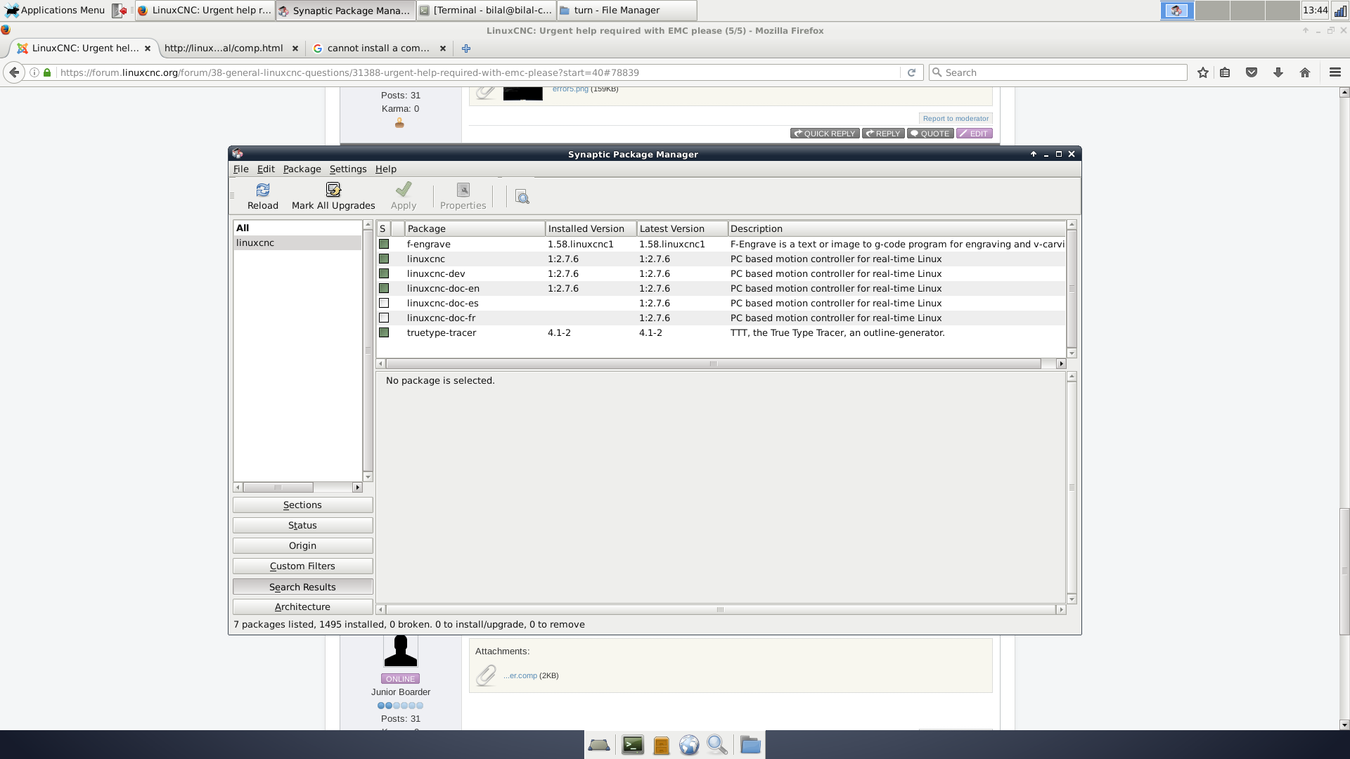

When I opened synaptic, the dev was already checked... So is it installed already??? See screenshot.
If it is, then why cant I install comp? I have shared the errors screenshots I am getting

I do not know Todd but I think dev is installed already, can you look at the screenshots I have shared?
If it is already installed, why cannot I still install a comp??? See all the screenshots, you will see what I am typing and what errors I am getting...
16 Aug 2016 12:53 #78842
Everything is installed that you need to compile a custom HAL component.
Your current problem is with the actual .comp code.
.comp uses C syntax, which means that program lines typically need to end with a ";" character.
The error codes point at line 33, which isAs you can see, neither that line, nor the following 7 lines end with ";".Try changing that.

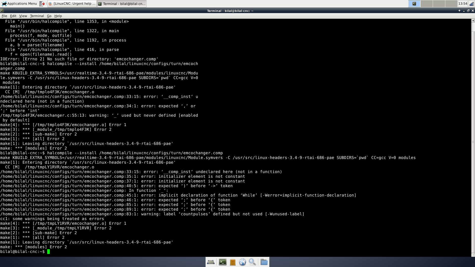

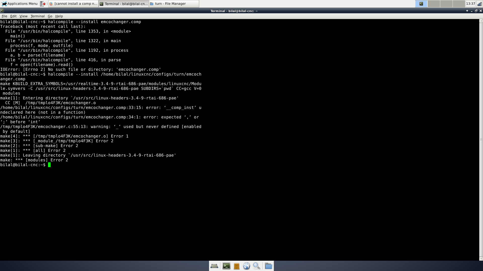

Latest I got this error now.
I think there is something wrong with my comp file. Syntex or something... Can someone please go through my comp file quickly and fix errors and attach it again or point out the errors please.

I added that semicolon syntex error. I should have noticed that before... It will still not install... see my previous post and it points out the errors... I cant understand... what are the errors now?
Attaching latest comp file and screenshot
16 Aug 2016 13:32 #78848
Replied by andypugh on topic Urgent help required with EMC please
One thing that might be causing problems is the capitalisation of While, If and Else.
It doesn't like the initialisations of some variables to other variables. Typically initiialsation of variables needs to be to a constant value.
Be aware that a .comp file is pre-processed to a .c file, then compiled. It can sometimes be useful to halcompile --preprocess to create the C file (and not delete it) to see what is being produced. This pre-processing is where the variables that you are being accused of not using correctly are coming from.
It might be best to go back to the original, unmodified, .comp file to make sure that that compiles and installs, then make your changes in steps, checking that it compiles at each stage.
There is quite a bit of output even with a successful compile. if you see a "cp mycomp.ko /usr/bin/....." at the end, then it has worked.
