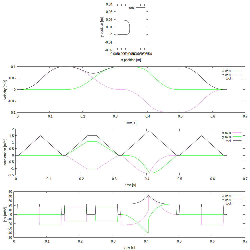

Jerk-limited motion is interesting, and I've played around a bit with generating such paths. (Lots missing before they could be called "tool paths", rather just experimental stuff to understand how jerk-limited motion behaves.) Here's an example of a short move, starting in the lower left accelerating right, turning upwards using a constant jerk vector aimed at 10.30 o'clock, then turning left using two clothoid segments before decelerating:
The original poster mentioned a slight following error:
Is it possible with LinuxCNC to set an S-Curve acceleration that does not effect motion blending?
S-Curve type acceleration has a much smother movement, way less jerky, but i've noticed a slight following error in some situations if it's set on the axis drives, so i was wondering if there is a way to set it directly from LinuxCNC, and if it would be any more precise, if there is not currently, are there plans for future versions?
The thing is, as far as I can see it is physically impossible to describe jerk-limited arcs exactly using g-code. The resulting arcs will always have a smaller radius than nominal, because transitioning from an un-accelerated line to a circular arc (with its inherent constant centripetal acceleration) cannot be done instantly - limiting that jerk is of course the whole idea. This transition takes time, and non-circular motion (away from the direction of the line). So when circular motion is reached, we cannot have both the center of motion and the radius we wanted.
I think accepting this, and figuring out an acceptable way of handling it, is a big part of the difficulty in creating a jerk-limited trajectory planner.
One way I can see is specifying a tolerance on the radius and then letting the planner reduce feedrate into the arc, if necessary, so that it can be met without violating the jerk limit. What do you think?

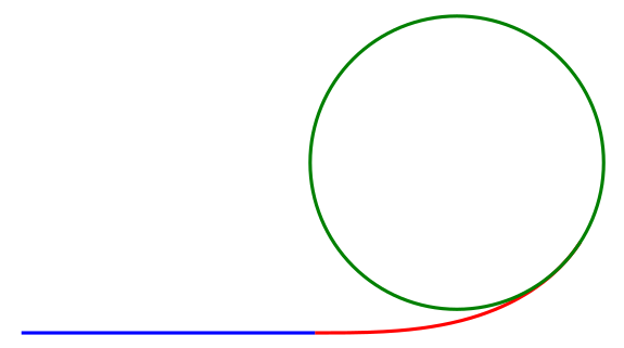

Todd, was that a reply to my post? If so, you should know that regardless of algorithm, any jerk limiting (anything less that infinite jerk) means that all radiuses will be somewhat smaller than programmed. You cannot change radius of curvature with less than infinite jerk without also moving the center of curvature.
Look at the (exaggerated) figure in the Wikipedia article on clothoids, under Formulation :
The circle is offset from the line (not tangent to the line). In contrast, all arcs programmed in g code are tangent to the previous/next straight line. You will get this discrepancy with any kind of jerk limiting.
