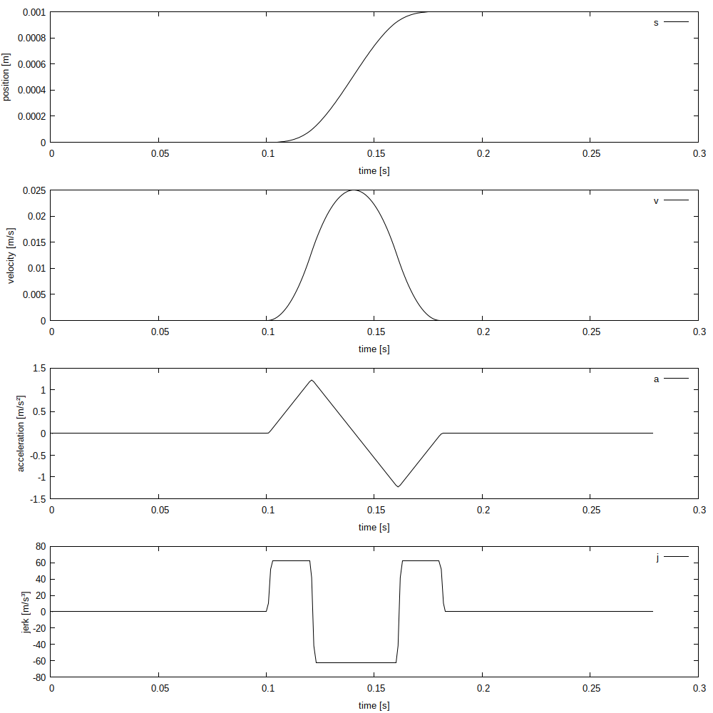

21 Jun 2020 12:45 #172266 by arvidb
Replied by arvidb on topic LinuxCNC S-Curve Accelerations
That explains it then - and should mean that that feature would become unneccessary with a jerk limited TP? The short moves would never reach max acceleration. E.g. this is a 1 mm move with v_max = 0.1 m/s, a_max = 2.5 m/s², and jerk = 62.5 m/s³:
An even shorter move, 0.1 mm, would only reach about 0.5 m/s² with the same jerk setting.

08 Jul 2020 11:13 #173992 by rmu
Replied by rmu on topic LinuxCNC S-Curve Accelerations
In my experiments I tried to jerk-limit not inidividual axis but the tangential movement. Even that should improve things quite a bit.
Dealing with jerk-limits per axis and going back and forth through kinematics will be very interesting.
08 Jul 2020 12:41 #174001 by arvidb
I've had to take a break from looking at this unfortunately, but yeah, my idea is also to jerk-limit the tool's movement rather than the individual axes (although I've been looking at both tangential and radial jerk limiting). It won't guarantee a certain jerk limit for joints in non-cartesian machines, but it could hardly make things worse either?
