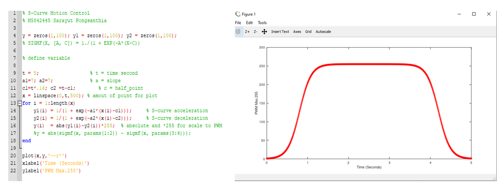

- grijalvap
- Posts: 200
- Thank you received: 63
18 Feb 2021 11:59 #199314
by grijalvap
Replied by grijalvap on topic LinuxCNC S-Curve Accelerations
- arvidb
- Posts: 459
- Thank you received: 158
18 Feb 2021 21:22 #199368
by arvidb
Replied by arvidb on topic LinuxCNC S-Curve Accelerations
grijalvap: Drawing a random s-shaped curve is not that difficult. You also need to:
* Have it end after moving a specified distance
* Respect acceleration and velocity limits (limited first and second derivatives of the curve)
* Handle non-zero initial values (non-zero velocity and acceleration) at the start of the move
* Handle initial velocity greater than the velocity limit (since it's possible to set jogging speed during jogging)
It might be possible to base such an algorithm on an exponential function like in the code you found - I encourage you to try!
