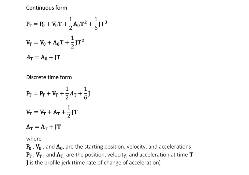

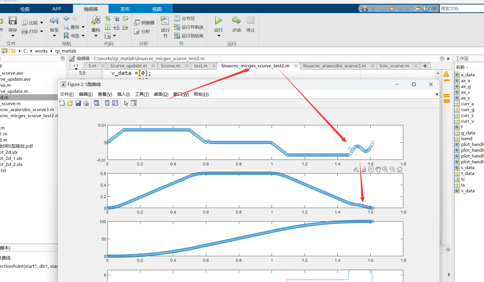

Hello, brother. I've found the official S-curve code, which is based on discrete-time mode, but I feel there might be an issue.You can try to implement Dynamic S-curve velocity trajectory profiling.
github.com/LinuxCNC/linuxcnc/blob/4ff91a...kinematics/tp.c#L598
discrete-time mode:
www.pmdcorp.com/resources/type/articles/...rol-profiles-article
discrete-time mode:

The "linuxcnc_micges_scurve_test2" branch has addressed errors caused by iterations, and I have extracted and plot the results using MATLAB.

13 Oct 2023 11:54 #282908
by Grotius
Replied by Grotius on topic LinuxCNC S-Curve Accelerations
Hi Barney,
Interesting results.
Did you did a git clone and then a git checkout? I got errors with tlc versions when try to ./configure this version.
Coming time i will try to dive some deeper into the linuxcnc source code.
Anyway. Can you try this scurve jogging repository to show a result in matlab?
github.com/grotius-cnc/linuxcnc
It has a build script in the cmake dir and starts the axis gui after install.

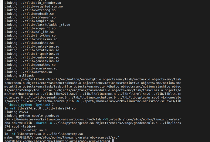

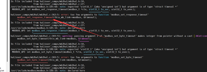

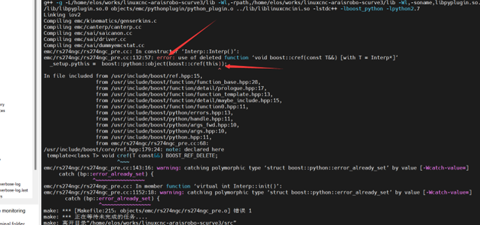

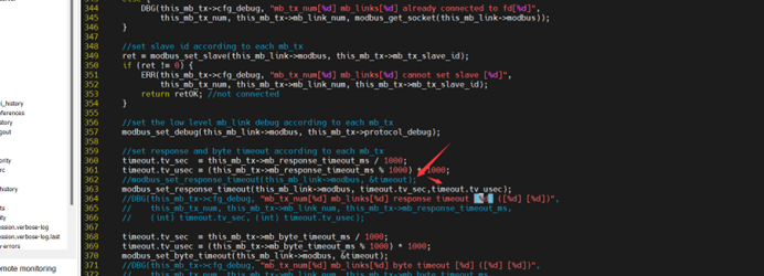

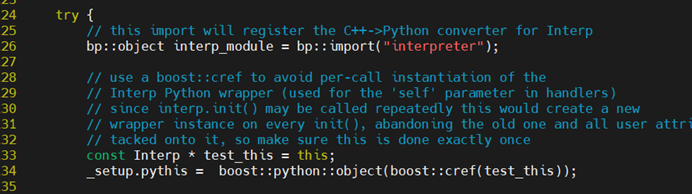

13 Oct 2023 20:15 #282954
by Barney
Replied by Barney on topic LinuxCNC S-Curve Accelerations
Hi Grotius,
Yes, I used git clone for building.
I encountered the following error while building and how to fix it.
You can also try building with MATLAB.
