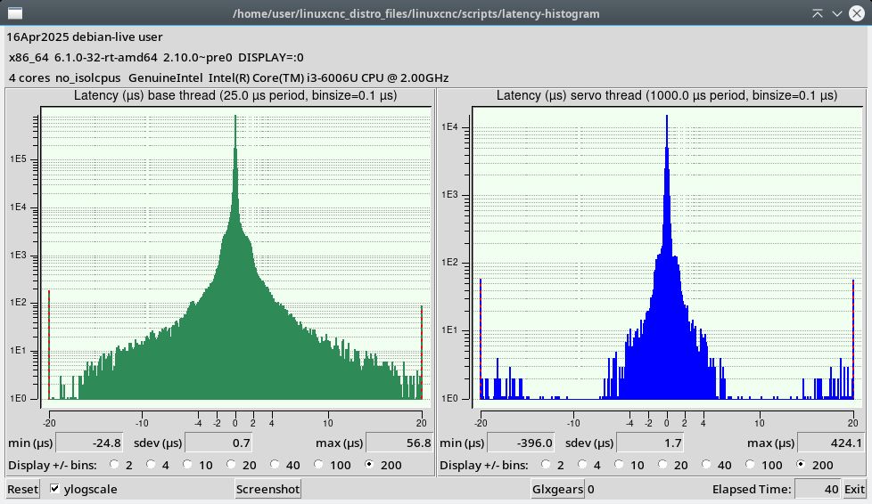

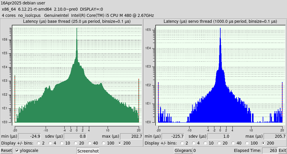

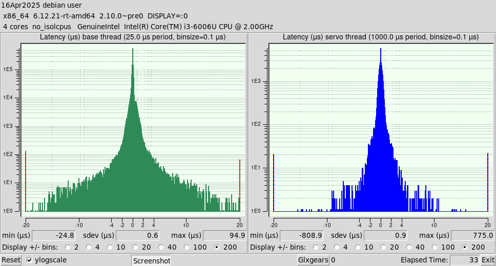

16 Apr 2025 03:02 #326433
by Grotius
Replied by Grotius on topic LinuxCNC S-Curve Accelerations
Before starting to change kernels etc. I thought maybe first do the latency-histogram test.
I did this on 2 different pc's.
From what i read here : max us > 100 = is bad.
Is this value both the same for base- & servo-thread?
Or maybe i am reading the histogram not correct.

16 Apr 2025 04:10 #326435
Replied by tommylight on topic LinuxCNC S-Curve Accelerations
Always use --show at the end of latency histogram, it will show the number of excursions that are not inside the visible area of the histogram, but they can be seen as multicolored columns on both sides of the histogram.
Also, use --nobase if there is no need for the base period, it adds more timing strains to CPU that will mess with the servo period latency results.
For both periodsFor servo period only
For both periods
latency-histogram --showlatency-histogram --nobase --sbinsize 1000 --show
