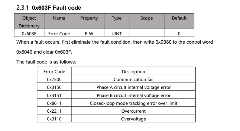

hmm, I am not seeing 6065 in my drives manual.
0x603F reports any errors including following errors which are described as Closed-loop mode tracking error over limit
In practice, a drive error is thrown and this pin can be referred to to determine the error . I have seen a few following errors here.

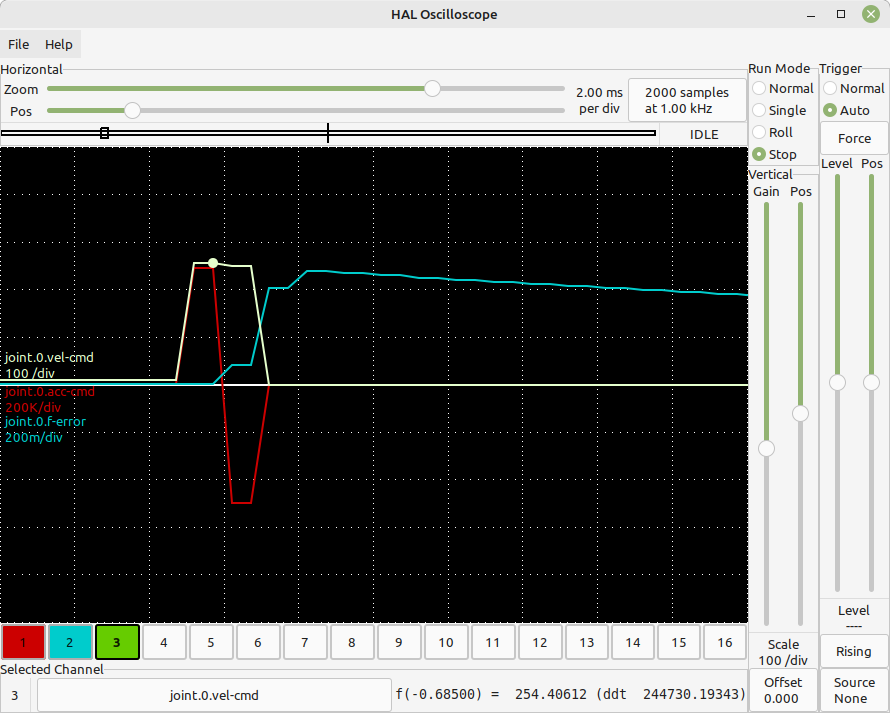

24 Apr 2025 17:56 #327020 by PCW
Replied by PCW on topic LinuxCNC S-Curve Accelerations
Tried this out but got following errors with large acceleration violations
Running the LinuxCNC logo:

25 Apr 2025 05:11 #327040 by Grotius
Replied by Grotius on topic LinuxCNC S-Curve Accelerations
Hi Pcw,
One last question, if you run the scurve simulation config :  axis_scurve_mm.ini   using the startup menu.
Run's this ok for you?
25 Apr 2025 17:27 #327060 by PCW
I can not test that as it requires EtherCat hardware.
26 Apr 2025 03:17 #327077 by Grotius
Hi Pcw,
The referred config file is a simulation for use with no hardware.
I thought if this runs ok on your pc, maybe you have a idea why it will not run ok on real hardware.
i have it running with huge ferror values.
