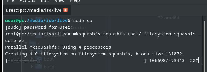

30 Mar 2025 10:23 #325330
by Grotius
Replied by Grotius on topic LinuxCNC S-Curve Accelerations
The iso is based on : debian-live-12.10.0-amd64-lxqt.iso
This iso is unpacked, filesystem is updated :
new kernel : linux-image-6.1.0-32-rt-amd64 + headers.
codeberg.org/skynet/ethercat-master
codeberg.org/skynet/linuxcnc_scurve_compact
codeberg.org/skynet/linuxcnc-ethercat
codeberg.org/skynet/hal-cia402
+ qtcreator, wine, geany.
+ crontab install to find & set mac adress at startup for the ethercat bus.
Now this will take an hour or 2.
It's repacking the filesystem after it was modified in a chroot environment.
Working in a chroot environment feels a bit like hacking the guts out off linux.
Then repack back to .iso format.
Then test the iso by installing it on a old pc.
We will see what happens.
So far i made a LINUX_DISTRO.md file, to log the steps.

31 Mar 2025 05:29 #325376
by Grotius
Yesterday i was trying to install the new .iso but it failed. No kernel was found.
I noticed i made a mistake somewhere in the process. Brrrr.
Now after a while i noticed i had to copy some files inside the iso related to the rt kernel.
Then installed it again. This time the rt-kernel was found.
At the moment i added extra software and it's packing the filesystem. After that i will test the iso once again.
I am testing from 16gb usb to 16gb usb.
Then one usb contains the .iso. The other usb is working as hdd to install debian12rt on. This worked yesterday.
It's only a slow install process. It takes a long time.
We managed to borrow server space from our friends : QtPyVcp Team.
Here we can now host bigger iso files at : repository.qtpyvcp.com/linux-distro/
this link is now empty, but hopely later on this day, the first iso will appear.
Thanks to QtPyVcp Team.
