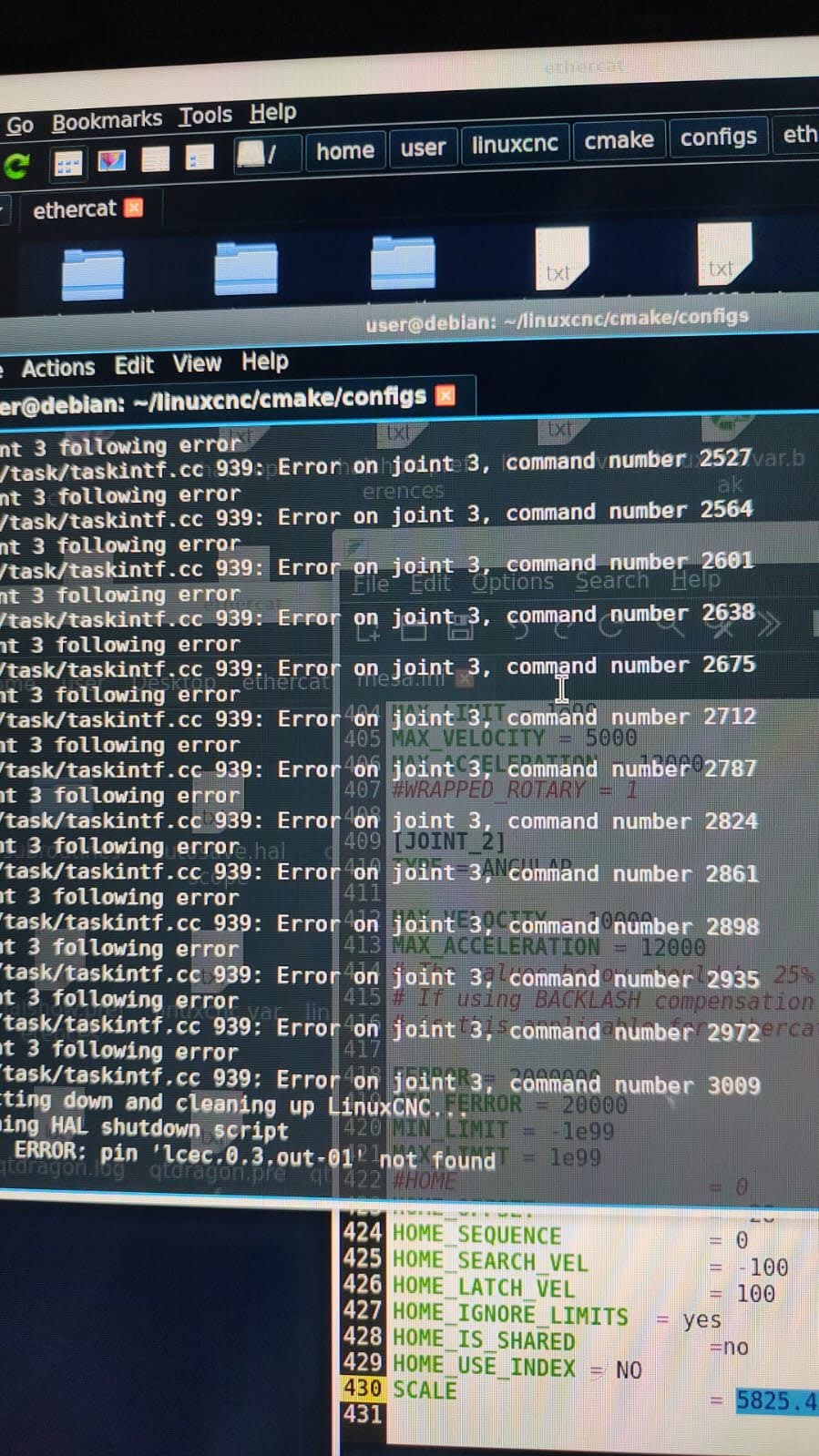

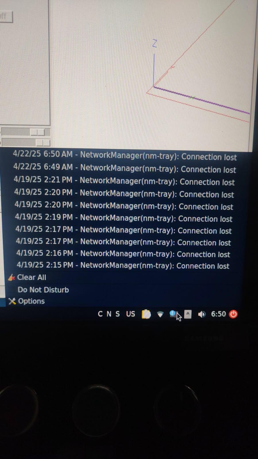

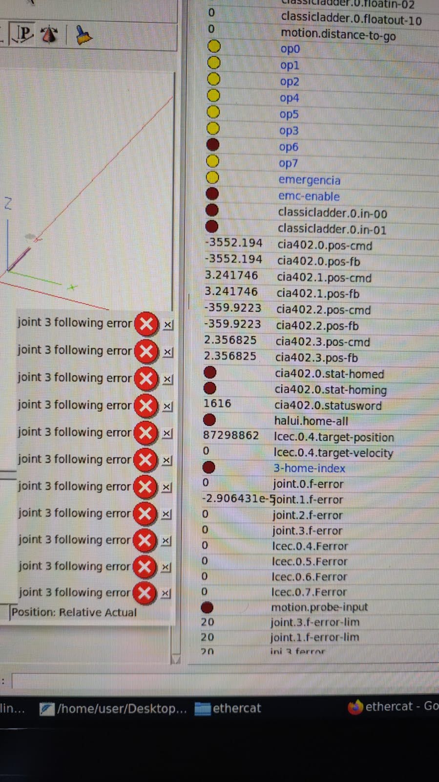

22 Apr 2025 07:55 - 22 Apr 2025 08:00 #326883
by tiagounderground
Replied by tiagounderground on topic LinuxCNC S-Curve Accelerations
I was able to test the debian 13 image with cia402 ethercat drivers, i can home the machine but after a few jog movements i got following errors and couldn't move the machine until i restart linuxcnc, latency is the same as my config that can runs in LinuxCNC 2.9.4. the only time i was able to run a gcode it only made the first g0 movement.it shows all the time wired connection loss, the only wired connection is to the ethercat drivers. i can run the same machine on the same pc only booting in LinuxCNC 2.9.4. without any erros, so its not a hardware problem.
Last edit: 22 Apr 2025 08:00 by tiagounderground. Reason: add new file

23 Apr 2025 05:26 #326949
by Grotius
Replied by Grotius on topic LinuxCNC S-Curve Accelerations
Hi Tia,
It seems the .img won't work ok.
Today i tried the scurve + ethercat on a desktop pc and it runned ok.
It's using a EK1100 + 3x EL2124 on a stepgen component.
Jog speed was around 15000 mm/min wich i find not optimal, but ok for ethercat.
The config:
1x linuxcnc iso from : linuxcnc.org/downloads/
1x ethercat installation : ethercat install
1x linuxcnc + scurve, using makefile build system : codeberg.org/skynet/linuxcnc
1x linuxcnc-ethercat, codeberg.org/skynet/linuxcnc-ethercat.git
Running the config : config link
Now i can not try the cia-402 component myself as i dont have the hardware for it.
But maybe you are able to try this again.
The config:
- Posts: 12176
- Thank you received: 4155
23 Apr 2025 06:38 #326954
Replied by rodw on topic LinuxCNC S-Curve Accelerations
Great! Don't worry about the cia402.comp as it needs work to work with the homecomp features. In fact it needs rewriting from scratch I think...
