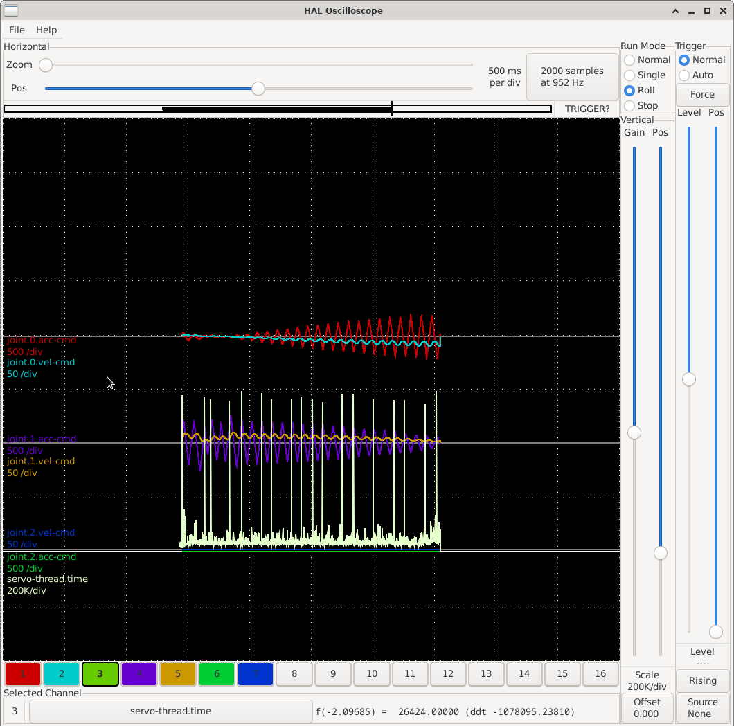

14 Feb 2026 16:01 #342965
by endian
crashes are not present during the 100% feed just if its not 100% ...
crash log is in the attachement if somebody are interested ...
Replied by endian on topic LinuxCNC S-Curve Accelerations
I have noticed the slowing during the round movement too but I forgot to noticed it here.... yes it is present and its present during 100% feed value ...New PR from YangYang is ready, hopefully will be merged soon in master
This adds ruckig in the planner type 1
if you want to test it get the binary from
github.com/LinuxCNC/linuxcnc/actions/runs/21975584400
or build source from my repo
github.com/grandixximo/linuxcnc
Testers are welcome to report here or in github, thanks!
Hello gentlemen,
movement are incredible smooth ... basic shaping what I have tested till now is pretty ... but during movement at more points during simulation of rotation interpolation its jumping or woobing ... kind off braking and next accelleration
most spiking during cloud of points are gone ... some spiking are still present but it a huuuuge step forward
testing setup 2ms benchtop profibus master 3axis geany gui ... 3 servo axis with synchronized speed control loop at 2ms
some testing fault popups triggered during the movement of file 3_1001.ngc
I am still testing at default simulation file from past but splitted to separated operations ..
thanks a lot for your progress ... I am watching it every single day with mount open and box of popcorn to reading the edits ...
regards E.

During todays testing Ive noticed time spiking during the G64 P0.005 and less ... I know there is a huge tolerance limit but I am reporting it for full testing approach ... code 1_1001.ngc from .tar file - again simulation or circural interpolation by cloud of point
otherwise timing get huge improve ... no big spikes and no big spikes of accelleration during the movement too!!!
I wish happy new year to China! Take a rest and we will see us after !
thanks
