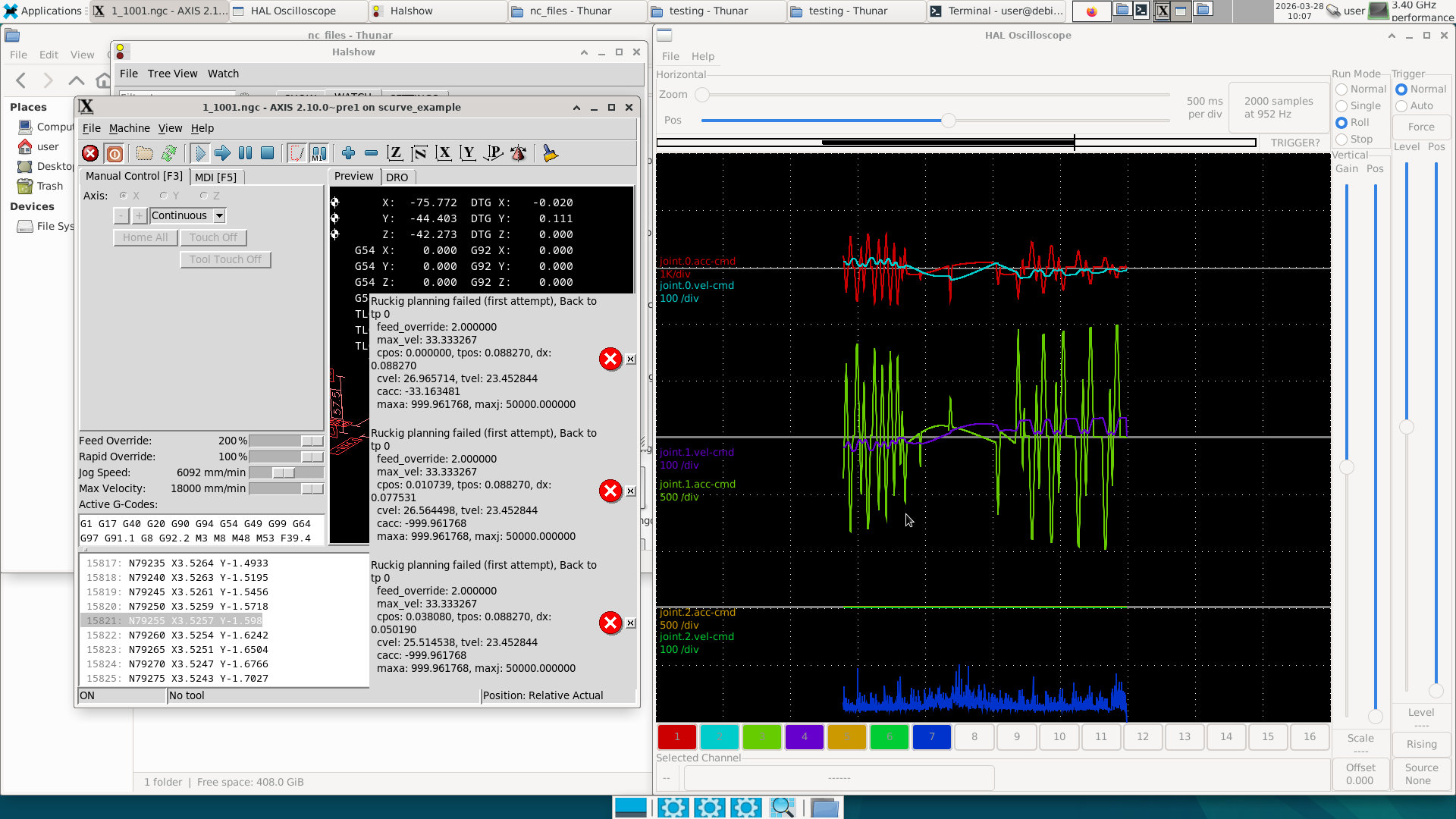

I tried to follow your instructions, and it works ok for me.
I suspect it maybe something with the custom tool table which is missing from default, could you share that?

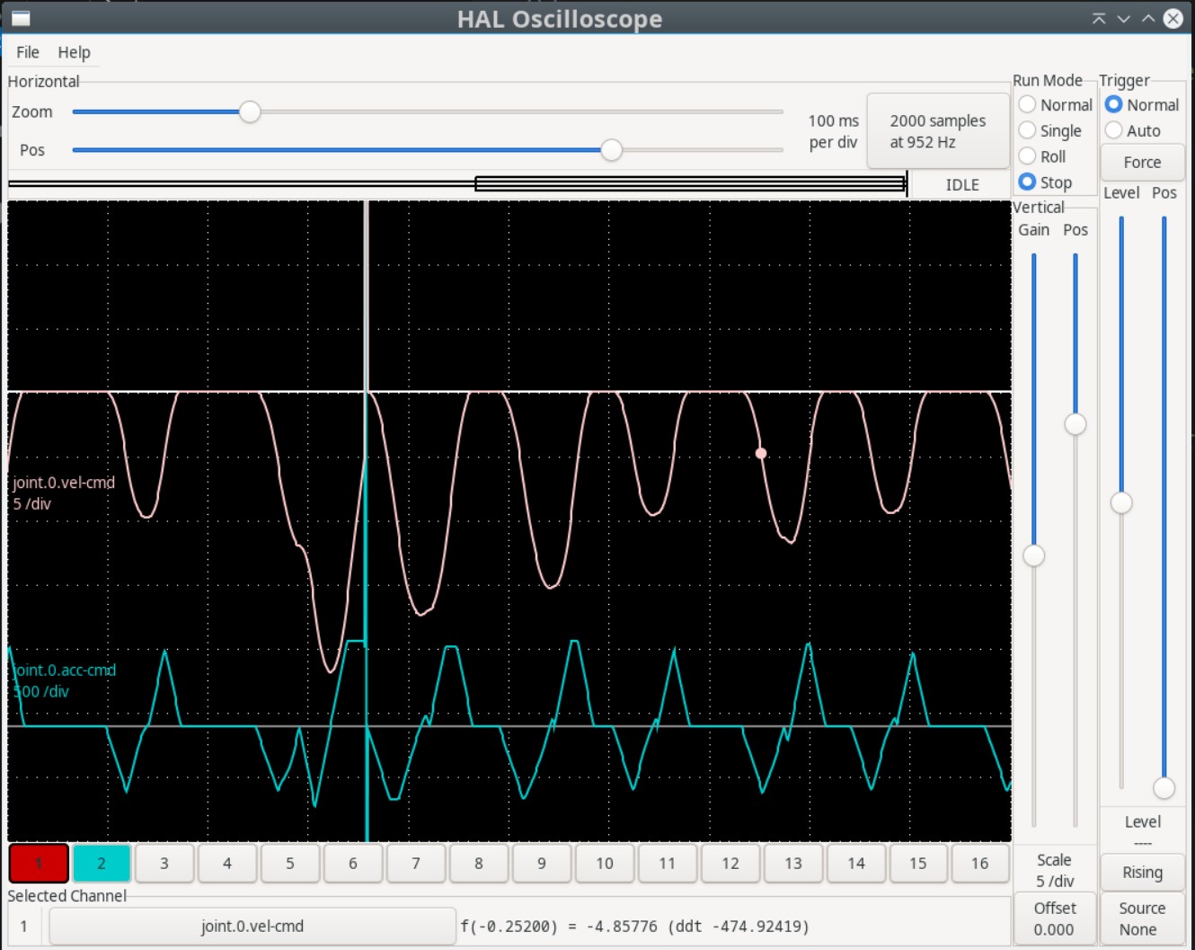

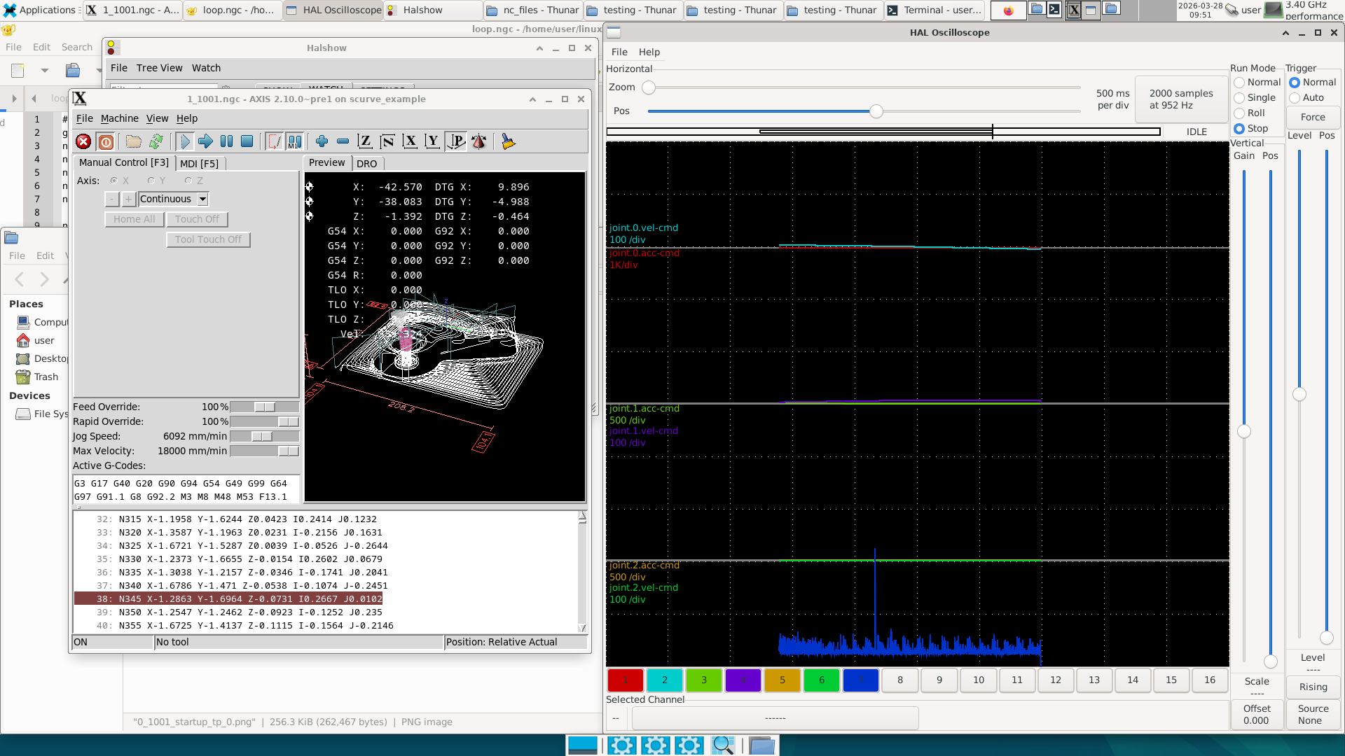

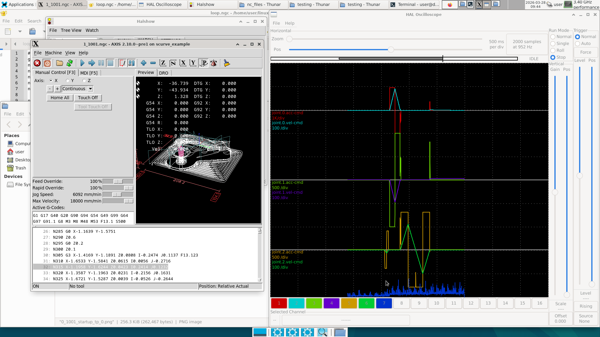

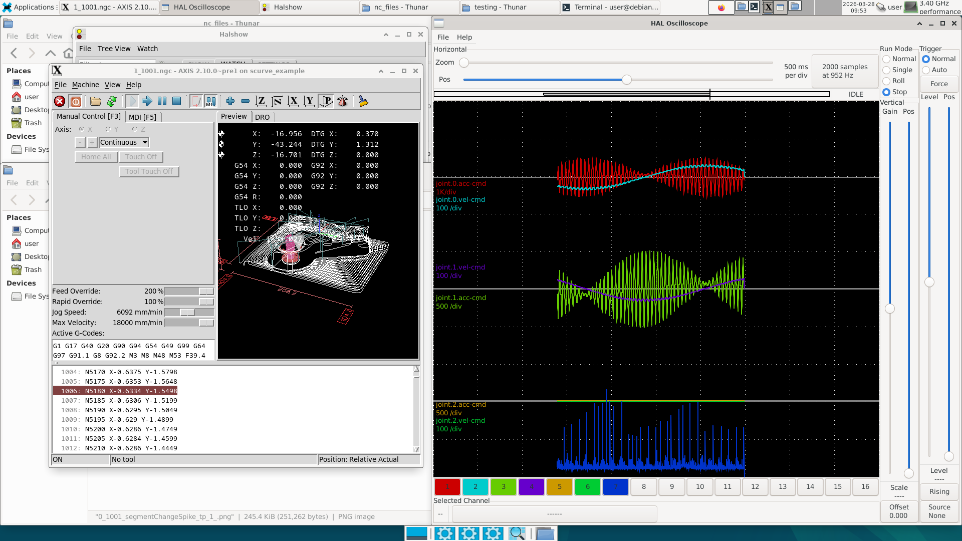

Hello,
I am sorry my bad ...I am too much focusing in something and then I failing in others ...

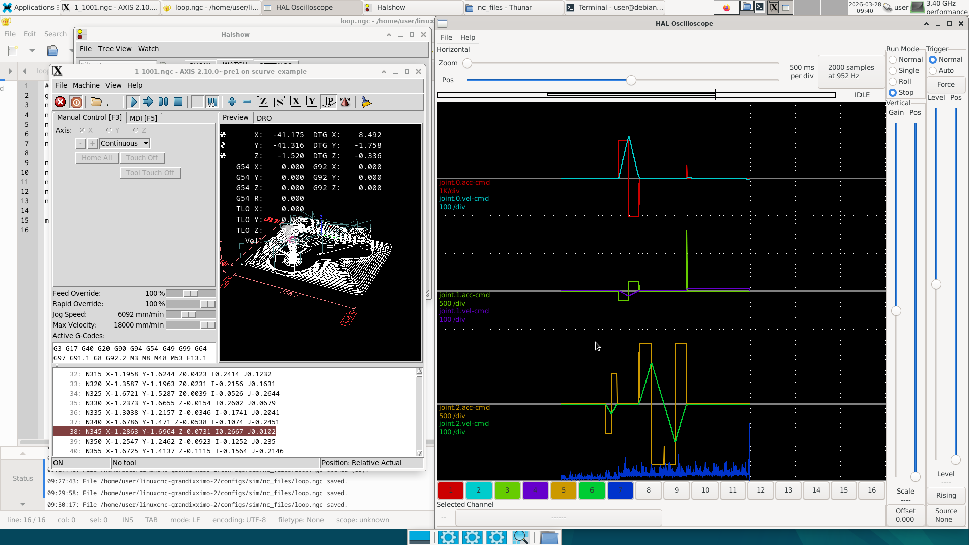

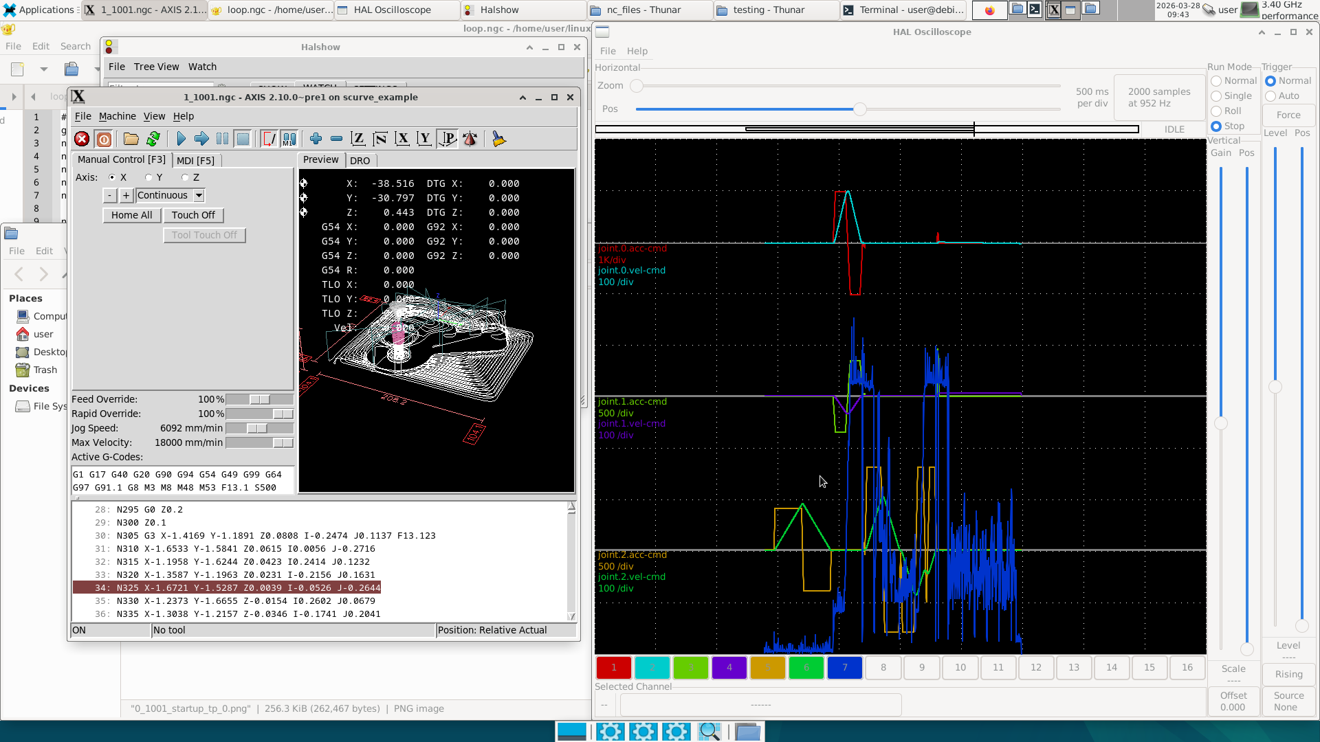

I have tested some toolpaths till now ... Infinite spikes are gone at tp 1 and 2 at paths where it defenetely were in the past ... I noticed that TP1 during its startup with testing code 1_1001.ngc spiking much with servo time (if we take 250us as our goal - for 1ms it is fine) ..
Default TP0 and TP2 do not this behaviour ...
dark blue from scope pictures in the attachments then TP1 is spiking at each segment change over 200us during cloud of points its repeating spiking too..
I notice that switching between TP1 and 2 is not possible sometimes it creates error and switch me back to TP2 from TP1
thank you E.

switching live I think is last refinement, YangYang working in separating the TP on a separate thread, switching will be refined after that.
At least spiking is gone, the fall back messages with TP1 are expected, just debugs, will be removed in next PR I think, thank you for spending the time testing.

that dark blue spline at the bottom is the servo-thread.time, in the 100k resolution, which are sharply jumping at start of cloud of points as ... I am not pretty sure how the TP1 works to from the start but other files starting well without that spiking... is it possible to precalculated it or add some waiting to start the motion to smooth the beginning timing?
How much influence latency of using Mate instead of Xfce gui ?
