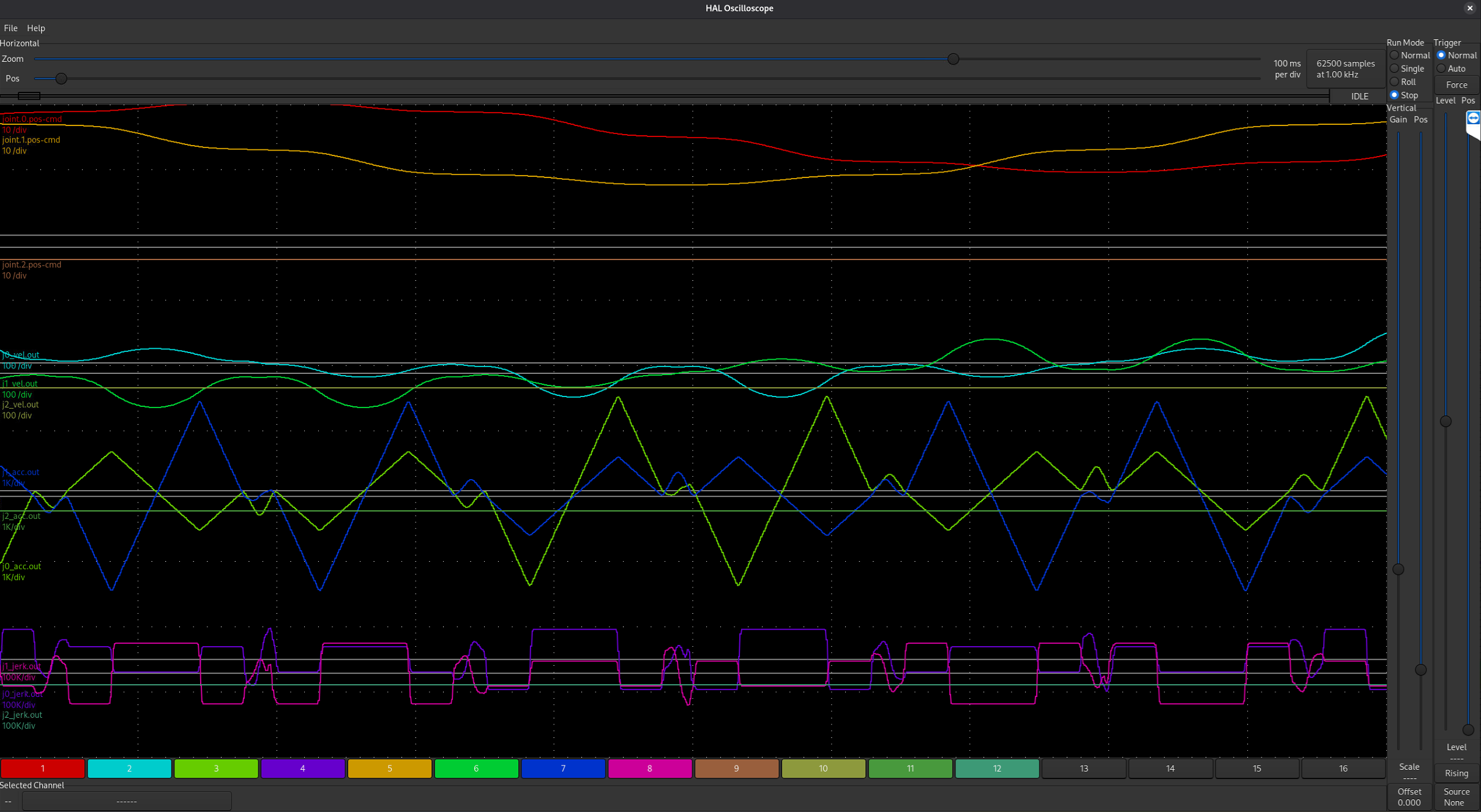

10 Apr 2026 07:46 - 11 Apr 2026 02:14 #345396
by m0602232
Replied by m0602232 on topic LinuxCNC S-Curve Accelerations
I have been experimenting with planner type 1 for a while now with 3-axis milling machine. Generally it seems to work but I'm having problems with g33.1. What is the current state with tp1, should it work when running g33.1? Right now I get error "ruckig_plan_position: invalid limits (v=0.000000, a=3000.000000, j=120000.000000)" at every spindle revolution. In ini file I have nonzero traj(default_linear_velocity, max_linear_velocity), axis' and joints(max_velocity).
EDIT: did more testing. Slowed down spindle speed, looks like the error appears all the time and not only once in revolution. The z-axis velocity seems to be bouncing between 0 to something when the control tries to keep the axis synced, and the tp1 planning breaks every time the speed goes past zero. The other (bigger) problem is when g33.1 is on the bottom and spindle rotation changes, joint2 following error appears.
I solved this temporarily by adding a hal pin to tp which sets true when spindle synchronized motion is on and used that to live change to tp0. With that rigid tapping works just fine although the same z-axis velocity bouncing is present.
